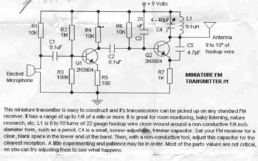

i would like to make this transmitter work off of 3 volts instead of 9 volts because i have been told by a couple of people that a 9 volt battery won't work nearly as long as would two AA's.
I lowered R7 to 100 ohm, but all that happened was i heard a clicking noise on the radio when i applied 3 volts. also, would anything need to be done to the audio portion of the transmitter so as to keep its sensitivity?
Thanx very much :lol:

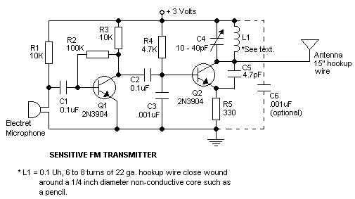

Been doin a bit of clandestine work and came up w/ this circuit here.
Will this give about the same range as my 9v transmitter?
youre right theone, a lot of the resistors are around 1/3 value :lol:

Hi Zach,
If your original transmitter was properly designed, you would be able to simply divide some resistor values by 3.
For example, the base voltage of Q1 must be at least 0.7V. R2 and R3 form an 11:1 voltage divider that provides Q1's base with only 0.82V with a brand new 9V battery and actually less, since Q1's base current will load it down and reduce it.
When the battery's voltage drops to 6V, the base voltage will be only 0.55V or less and Q1 won't work! Will it work with a 9V Ni-Cad rechargeable battery that actually produces only 7.2V? Probably not. Poor design.
If you use resistors with 1/3 the value for R2 and R3, the voltage divider will be the same. It won't work.
In your new transmitter circuit, the voltage for Q1's base is provided by feedack by R2, so it remains fairly stable with supply voltage changes.
Its emitter resistor for the oscillator is 1/3 the value of the 9V transmitter so its Q2 current will be the same at 3V and it will have the same range.
i made the 3v circuit and it works wonderfully. its really weird tho, if i put in that .001uf supply decoupling cap, the transmitter sounds like a tea kettle. think i got a bad cap?
Hi Zack,
Teakettle sound? Ha, ha. Are any of the other parts British?
Maybe the circuit is designed on the hairy edge and therefore goes crazy with a good solid RF supply. Try adding a 10uF to 100uF cap too, for audio frequency bypassing.
haaa haa. just got a chance to fiddle with it a little more and i just found out that the sensitivity is TERRIBLE!! This thing is meant to be able to pick up someone talking across the room, right? cuz all i can get someone putting their mouth up to it and talking. ill try that 10 or 100uf cap. none of my other transmitter circuits needed it tho.
Hi Zach,
The mic preamp, Q1, has negative feedback which cancels its gain. It needs the negative feedback for DC, not AC.
You can easily change it so that it still has DC feedback but no AC feedback. Then it will have lots of gain, almost as much as the other transmitter.
Remove R2, the feedback resistor and replace it with two 47K resistors in series. The DC feedback will be nearly the same as it was before.
Add a 22uF capacitor from the junction of those new resistors to ground. Now it will have no AC negative feedback.
been fiddlin around with the 3v transmitter some more. I don't have room to do what you recommended audioguru (next time).
the range on it isn't very good. I did squeeze a little more out of it though by adjusting C5 from 6pf to 13pf (the 6pf that was already there in parallel w/ a 7pf cap). Is there any way of getting something more out of this thing?
Ill also have to try lowring the value of R5.

Hi Zach,
To get more range, lower the value of R5 until its oscillation stops, because C5 can no longer provide feedback into it, or until Q2 melts.
Maybe you need an RF amplifier to follow the oscillator like the illegal 3-transistor transmitter circuits.

well, i got the range that i had w/ my 9v transmitter w/ the 100 ohm resistor, but the thing is, at first, the sound is real nice and clear, but after a while, it starts clicking, and thats all it will do. i can receive the clicking a far distance off. Also, i am getting a signal around 96 and 107 MHZ (remember thats only a guess) no matter how far i am
Hi Zach,
I just realised that the oscillator's base bias resistor of your transmitters (R6 = 10K in the 9V one, and R4 = 4.7K in the 3V one) have a value that is much too low. This will cause the oscillator to be saturated most of the time creating all kinds of phantom signals and reducing their range.
Now that you have a 100 ohm emitter resistor on your 3V transmitter, change its R4 to 27K. It should work much better.
Again, 100uF across the battery might stop those clicks.
