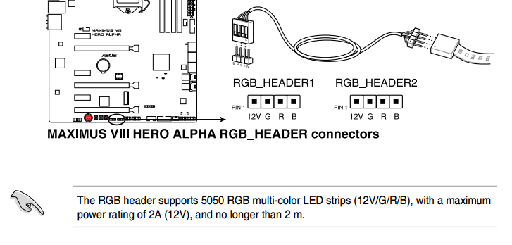

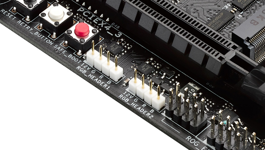

The header is a motherboard header btw.
Also it runs at 2A sorry for the mistake, but i still want to run more LED strips above a total 2A anyway.
Below are the motherboard header and the manual description of the header.
Abin

Oh thank you for this.,
So you put the signal of the LED strip header from motherboard and supply some power and it will amplify the amount of Amps to connect more LED strips correct?
Correct. All the functions from your motherboard will be transferred and amplified. So nothing is changed in respect to your signal and effect. You just have more power output! :) Happy Lighting.
