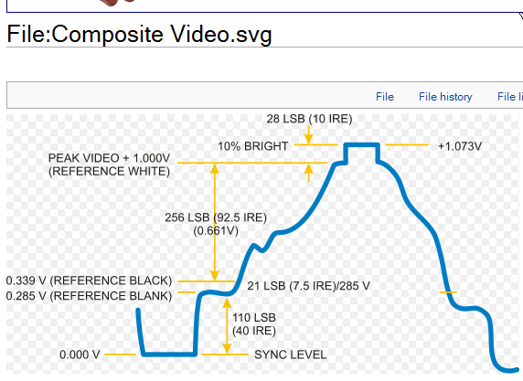

I have never heard a DC audio signal.
I have never seen a DC video signal.
You see the result of a varying DC signal every time you watch your TV.
Also you hear the varying DC demodulated signal when listening to your radio.
An AC signal alternates its polarity. A bouncing DC level does not alternate and is not an AC signal.
No one said that varying DC is an AC signal, so stop playing around with the words and statements that I have posted.
You have made a mistake, which we all do from time to time, so please be good enough to admit it and lets move on.!
