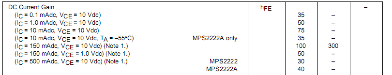

On a transistor data sheet how do you know which min hFe value to use for example for the 2n2222a.
DC Current Gain
(IC = 0.1 mAdc, VCE = 10 Vdc)
(IC = 1.0 mAdc, VCE = 10 Vdc)
(IC = 10 mAdc, VCE = 10 Vdc)
(IC = 10 mAdc, VCE = 10 Vdc, TA = –55°C)
(IC = 150 mAdc, VCE = 10 Vdc)(1)
(IC = 150 mAdc, VCE = 1.0 Vdc)(1)
(IC = 500 mAdc, VCE = 10 Vdc)(1)
hFE
35
50
75
35
100
50
40
If my Ic was going to be 50ma then which hFe value would i use ?
If the voltage supplied to the transistor is less than 10 vdc say 5 vdc insteed that obviously means that vce can not be 10v so how do you choose the hFe from data sheet in this case if the characteristics are based on vce of 10 vdc ?

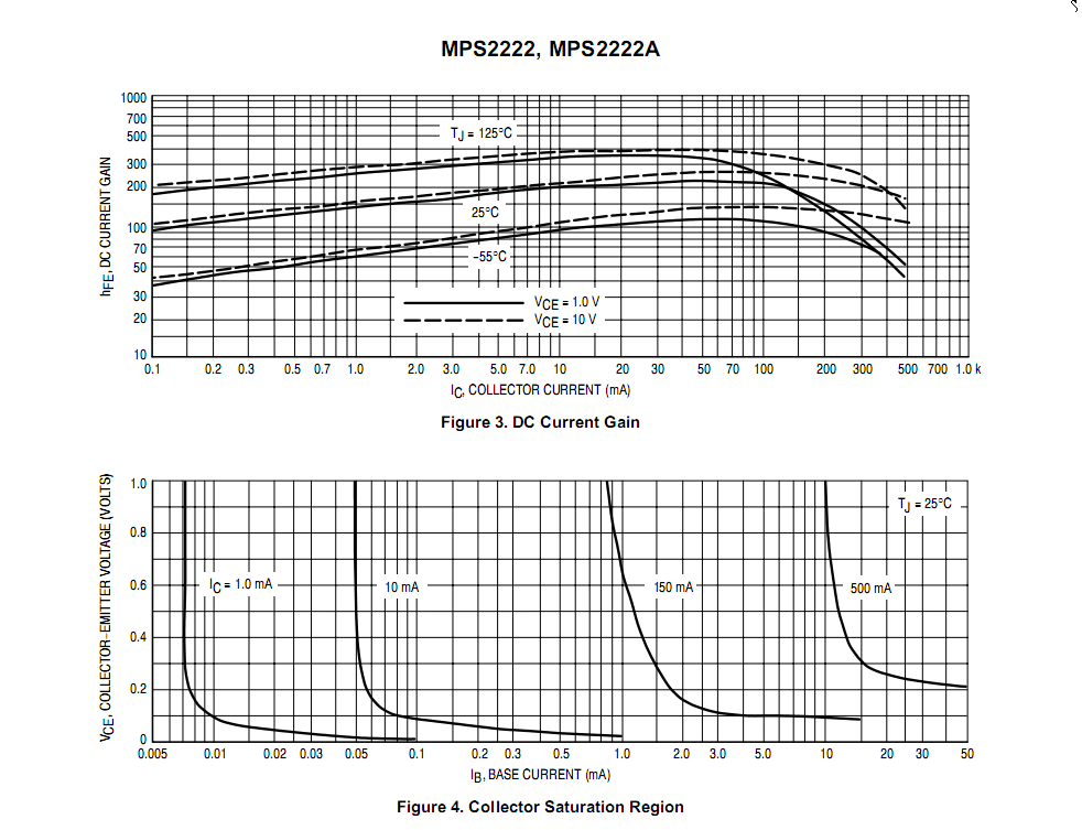

It depends upon the application, a good starting point are the graphs for the transistor.
Normally you design a circuit to be somewhat insensitive to the actual Hfe since it typically has a variation of 3:1 or more from unit to unit. This is often done with an emitter resistor. This stabilizes both the bias point and the AC gain (if the emitter resistor is not bypassed) of the stage.
For the saturation collector region how do I find the expected vce for ib .5 ma and ic 50 ma if they only have 1 ma,10 ma,150 ma,500 ma IC values ?
Also how do i find the hFe value on the dc current gain graph for ic of 50ma and if vce is not 1v or 10v ?
You have to interpolate from the graph,, at 25C for 50mA the gain is close to 250 for 1Vce and 10Vce.
If you have Ib=.5mA and Ic=50mA then the MINIMUM gain would have to be 100, so 250 will be more that adequate to saturate the transistor
Datasheets normally have a different set of specifications for the saturation region. Vce(sat) is normally specified for Ic/Ib=10, or Ic/Ib=20, depending on the part number. The beta specs for non-saturated Vce values are basically irrelevant for saturation.
Don't use the graph because it is only for a "typical" transistor that you cannot buy and might not have.
If you design a circuit for a "typical" transistor then it won't work when the hFE of the transistor is lower than "typical".
But if you design the circuit properly for a low hFE transistor then any passing transistor will work in the circuit.

Tron and Eric are both wrong.
HFE is used for a linear amplifying transistor that is not saturated because it has plenty of Vce voltage.
The datasheet for most transistors shows that the base current must be 1/10th the collector current for the transistor to saturate with the max Vce saturation voltage that is spec'd. A few BCxxx high gain European transistors (example is BC549) have their max Vce saturation voltage spec'd when the base current is 1/20th the collector current even when their minimum hFE (hFE is spec'd when the Vce is 5V) is 420.

But they do. hFE is used for bias purposes, which is why it is given at a Vce of 10V or 1V. If it were for turning on a transistor as a switch then it would be given at a low Vce voltage of perhaps 0.1V.
As Uncle $crooge noted, you normally use an hFE of 10 or 20 to insure saturation of a switched transistor.
