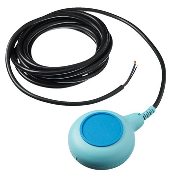

I live in a house with a well outside in which water from the bathrooms is collected in before it is pumped out to the public sewer system.
In this well I have one of these, which works like a on/off switch:
niveauvippe-1skifte-6m-ako-1424004005-1424004005-1042878
Inside the house i've got a small 12V circuit with a speaker on (alarm) which turns on if the the above thing registers too much water in the well.
The circuit consists of a transformer which converts 230V AC to 12V DC and starts the alarm as long as it is powered.
Currently the circuit is like this:
230V -> the on/off switch in the well -> circuit
A specialist on the well pump, told me to change the circuit to be like this:
230V -> circuit -> the on/off switch in the well
Reason being: 230V into a water well is not a good idea
So his suggestion is to move the on/off switch in the well to the secondary 12V side of the transformer rather than the 230V primary side.
Will this not create a problem as the primary side will be energized permanently, but disconnected on the secondary side most of the time?
Will the transformer overheat/get damaged?
Or is it ok?

It's not a problem, and is a perfectly normal thing to do.
However, float switches on pumps are normally mains powered, as are the submerged pumps.
A good quality transformer draws little primary current when the secondary is unloaded or only lightly loaded (such as when the speaker circuit is unpowered).

The guy told me im running a old style pump. New style pumps does not have 230V in the float switches, but 12V.
If/When the float switches starts leaking, the 12V switches will not turn off the residual current circuit breaker, but the 230V will
We've supplied brand new pumps, just in the last few weeks to a major Water Utilities company, the float switches (as well as the pump) run at 230V, and the switches WON'T leak - I dismantled one of the original float switches (because I'm nosey!), which was a VERY hard job, and there's no way they are going to leak water.
Here they do. I got all 3 replaced (start/stop/alarm) 11 years ago, and yesterday the alarm one cause it leaked. The guy told me life expectancy per float switch is 10 years, and they replace them regularly, especially the ones used for dirty water - like my well

The one you posted the picture of looks pretty crappy to be fair, the ones I've seen are MUCH sturdier than that.
