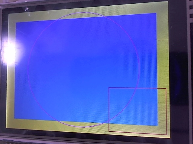

Well, to report , I built a kind messy interface board.:confused: (for several silly reasons, couldnt find appropriate cables, blabla ,disregard that:banghead:) and finally connected the LCD to the 18F45K20. Then I took the sample code provided by the manufacturer (for another micro), analyzed it and rewrote it for the PIC. Then I tried clearing the screen and drawing a rectangle.
Good news: the rectangle got draw successfully.
Bad news: The clear screen function does not work properly. (only a part of the screen got clear)
The drawing is a bit slow (specially for the clear function)
I guess, the slowness is not really a problem since I am running the PIC at default speed which is low (1MHz) and all I need is to speed it up.
Right now I am concerned about the clear function so I am going to reread the ILI9325 datasheet to see what is wrong.
I noticed that all functions (except the clear screen) do the following: write an "index" ( a command I suppose) and then write the data (color for example). Then repeat again if necessary
The clear screen function first write an index, and then enters a for loop with each iteration writing data . Which does not work since it clears only 1/5 of the whole screen...
Also , debug does not work. First of all sometimes delay functions ruin debug, and on top of that, even if I run it in debug mode, the results are different,. The screen becomes really small and the rectangle is not draw. So I stopped using debug...
Will update my findings. :wideyed:
Well to no avail.
I read the datasheet, check some source code that I found in obscure parts of the web... and no, they are same as mine. And yet clear function does not work well
As you can see, the rectangle is draw ok, the circle is draw ok but the clear function (the yellow part) is not complete, it just fill a minimum part of the screen
And, I found there are undocumented features that does not appear on the datasheet!.. (some other people have found this too, it seems)
Sigh...
Update. I solve the problem:
Theoretically it is very strange though

Oh, I just checked and the index was indeed a uint32_t, ergo an unsigned long int!
However it just goes till 11264! (0x2C00)
The solution is to cast the product like
uint32_t product= (uint32_t)MAX_X*MAX_Y;
