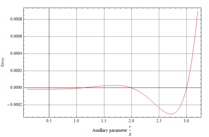

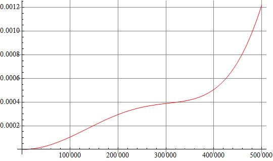

Hello again,
Here is an update on the previous simplified formula.
First, as before, we have:
x=2*pi*r*sqrt(2*f/172400)
r in millimeters and f in Hertz as before, and
the 172400 is just the common resistivity for copper adjusted from abohm centimeters and scaling the radius to millimeters.
Then this simple witch is a pretty incredible fit for 1<=x<=3 which is:
K=(2*log(10)*x^4+501)/(2*x^4+501)
and that is an incredible fit already, but using a simple optimization process we can get the error down to about one ten thousandth of one percent (a factor of 1e-6) using just six significant figures for the constants:
K=(2.30242*x^4+250.672)/(x^4+250.668)
(this comes about using x=1,2, and 3 for test points only)
and this is valid for 1<=x<=3, and for x=0 to x=1 K is almost zero anyway, and for x>3 we have an almost straight line at least up to x=100, so that is easy to calculate too.
Here's an even simpler version not too bad which is self complete:
K=(2.3*f^2*r^4+1.2e9)/(f^2*r^4+1.2e9)
again for 1<=x<=3, and again f in Hertz and r in millimeters.
I had a feeling this problem was well suited to a witch, i just at first didnt know which witch (pun intended) :)
Execellent job finding a simple but good approximation for the case where the skin depth is near the radius.
Here's a plot showing the exact Rac/Rdc compared to your approximation (exact in blue, your approximation in red):
f1-png.92081
Here's the error in your approximation:
f2-png.92082
Here's the error in your improved approximation. I see that the error is closer to zero at your test points 1, 2 and 3:
f3-png.92083
Here's the error in your self complete version for 26 gauge wire up to 500 kHz:
f5-png.92084
Any of these approximations you've derived is MUCH better than anyone would ever need for practical work. Excellent work, MrAl!
f1-png.92081
f2-png.92082
f3-png.92083
f5-png.92084
Hello again Electrician,
Well thank you, and wow, you've been busy today :)
Thanks for doing those plots as they reveal a lot about the approximation. It was intended to be used for x=1 to x=3 so it seems ok for that i guess.
