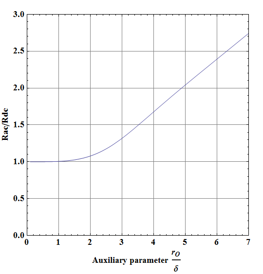

Resistance and conductance are not the same thing as resistivity and conductivity. Resistivity and conductivity are intrinsic properties of the copper. Resistance and conductance (of a piece of wire, for example) are the result of taking into account the geometry of a piece of copper and where the connections to it are made.
The resistance of a piece of wire at DC is given by R = rho*L/A, where rho is the resistivity, L is the length of the piece of wire, and A is the cross sectional area of the wire. At AC the resistance is different due to skin effect causing the current density to vary across the cross section of the wire, not rho. rho is the same everywhere in the copper at DC and AC frequencies below gigahertz frequencies, which is the region we're discussing.
In an earlier post you said:
If we look at the effect along the radius of a long wire the current density changes as an exponential. Integrating over the radius using this exponential as a weighing function provides us with the following formula:
r=2(g^2*(e^(-1/g)-1)+g)
where
g=1361/(6641*pi*sqrt(f)*R)
for copper wire, and
f is the frequency in Hertz and R is the radius of the conductor in meters,
and r is the ratio of DC resistance to AC resistance, so an r value of 0.5 for example means the AC resistance is 2 times higher than the DC resistance.
This formula is not like the formula where we assume that the penetration depth is only equal to the skin depth, and obtain the AC resistance from that. That formula is limited because the approximation falls short when the radius of the wire gets closer to the skin depth. For example, the approximation would give an estimate of close to 0.5555 for a wire with radius three times the skin depth, while the better approximation from the formula above yields an estimate closer to 0.4555.
The skin depth at 100kHz is 0.206mm, which is about equal to the radius of a #26 gauge wire, and using the older approximation this tells us that the AC resistance is about equal to the DC resistance. This is the largest wire size recommended by Magnetics Inc for use at 100kHz. They obviously used the single skin depth approximation to determine this, which isnt too bad really.
However, using the formula above, the DC to AC resistance ratio for an AWG #26 wire at 100kHz comes out close to 0.74, meaning the AC resistance is about 35 percent greater than the DC resistance. This tells us that #26 isnt that bad, but we can of course do better with a larger wire size.
You were using current density as the variable in your calculations; using current density is the thing to do. Current density does vary with depth in the wire, but resistivity does not.
However, your analysis of the case where the skin depth is close to the wire radius is flawed. You say that "If we look at the effect along the radius of a long wire the current density changes as an exponential." This is not close to the truth when the skin depth is near the radius. The exact expression for the current density variation with depth in a round cylindrical wire involves Bessel functions, and is not well approximated by using an exponential when skin depth is nearly the same as the radius.
When the skin depth is very small compared to the radius, then using the exponential is a good approximation. This is discussed in Ramo, Whinnery and Van Duzer. An exact solution to the problem in Bessel functions exists. Also, Terman has a graph showing Rac/Rdc for various ratios of skin depth to radius.
If we take the radius of a 26 ga wire as .202 mm, the exact value of Rac/Rdc at 100 kHz is 1.0179. The expression g=1361/(6641*pi*sqrt(f)*R) gives 1.0212, quite close to the exact value. Your adjustment formula, r=2(g^2*(e^(-1/g)-1)+g), overestimates the value as 1.35
Taking the radius of 22 ga wire as .322 mm, the exact formula gives Rac/Rdc as 1.10745. Your formula gives 1.59.

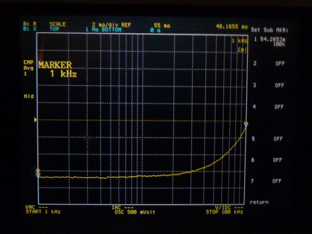

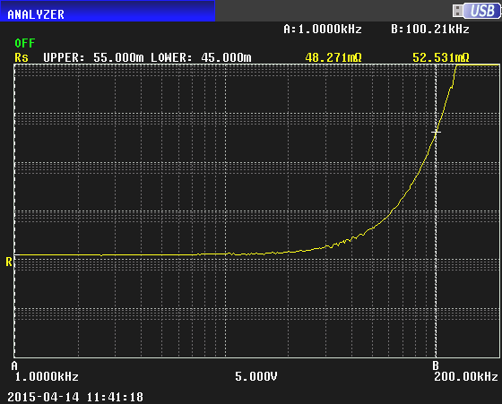

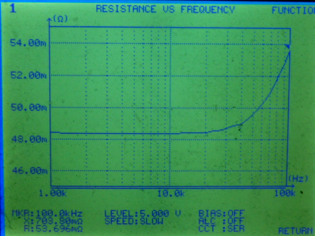

I cut off a 3 foot piece of 22 ga magnet wire and measured the AC resistance versus frequency with an impedance analyzer:
racdc-png.92009
The B marker indicates a resistance at 100 kHz of 52.531 milliohms, and the A marker at 1 kHz shows 48.271 milliohms, for an Rac/Rdc ratio of 1.088, which is fairly close to the exact value of 1.107, and not so close to your formula's value of 1.59
Apparently your technique of viewing resistivity as something that varies with depth doesn't work:

Hello again,
What is the make and model of the analyzer you are using to do the measurements?
I am not sure that 3 feet is enough length to test this with, but i will still look over the results and compare anyway. We probably also have to know what the shape of the wire was at the time the measurement was made, and also how it was attached to the measurement instrument.
The measurement was made with a Hioki IM3570. The instrument can resolve 1 milliohm and three feet is more than enough. The wire was attached to the standard fixture on the front of the instrument. The fixture terminals are close together, so the wire is in a loop with the largest possible diameter to keep the wire away from itself as much as possible.
Here is the same measurement performed on an Agilent 4294. This measurement gives a value for Rac/Rdc of 54.265 mΩ/48.165 mΩ = 1.127:

And, here is measurement performed on a Wayne-Kerr 6440B, giving Rac/Rdc of 53.69 mΩ/48.47 mΩ = 1.108:
racdc3-png.92014
All three results are quite close to the analytical exact result of 1.107, taking the radius of 22 gauge wire as .0322 cm and a frequency of 100 kHz:

Terman's "Radio Engineer's Handbook", on page 30 shows a graph of Rac/Rdc versus an auxiliary parameter: (radius/skin depth). Here is the graph:
terman-png.92015
Clearly, when the skin depth is nearly the same as the radius, Rac/Rdc is very close to 1.00. Rac/Rdc doesn't approach 1.59 until radius/skin depth is about 4.5
