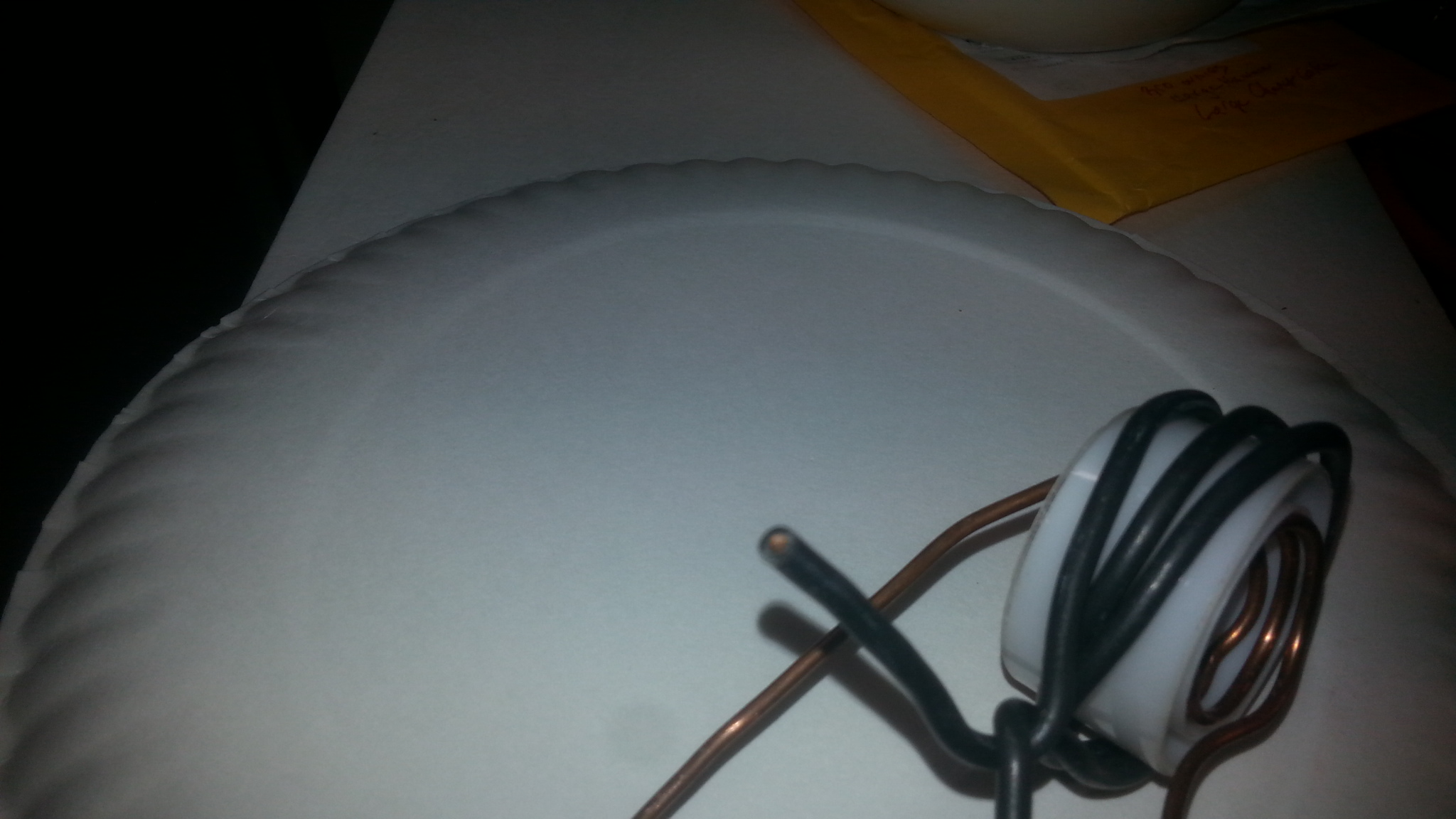

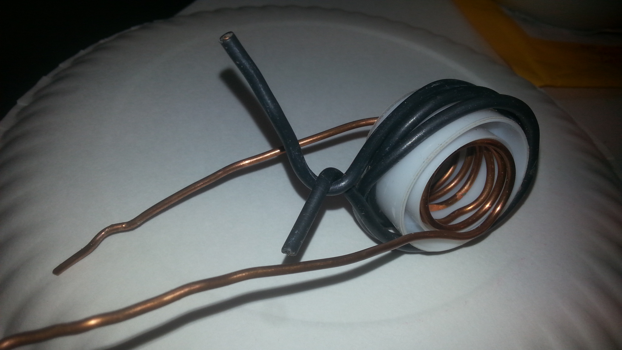

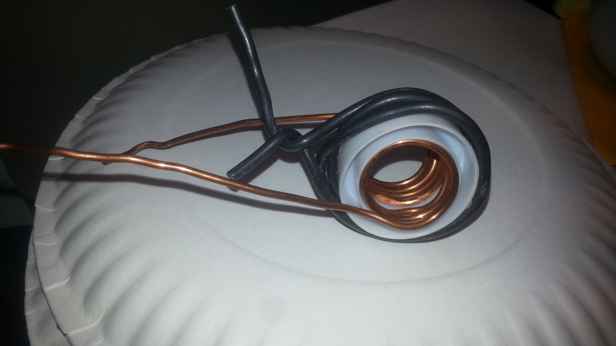

I need a small transformer, one that can't be would with classical winding methods where the turns are arranged radially, with each turn passing from the IT around and over the OD, etc.
I'd like to know if a toroid can be wound axially, insteaad of radially.
I made a non functional 'model' and have posted pictures showing the method I'm asking about. The milky white tape holder represents the toroid core. The pictures show a 2 to one ratio transformer.
Obviously I can't expect low magnetic leakage, but will this winding method work?
TY
No.
For a toroid coil to work, the wire must pass through the centre hole in the core.
The multi-turn winding which you have in the centre hole of your "plastic toroid" would just act like one turn in a real toroid core.
There would be negligible coupling to the winding on the outside surface of the toroid.
Yes
The core (slug) inside this coil has a hole inside it. So it is much like a toroid.
I think winding one coil on the outside and the other in the inside will have, not good, coupling but it will work.

What Ropa II is proposing (if I understand correctly) is very different.
In his model, the ferrite core is replaced by a plastic spool, just to make things easy to see and understand.
His winding on the outer diameter of the toroid core will have its inductance increased by the influence of the core material, in just the same way as your RF coil will be influenced by the slug of core material inside the former.
His winding inside the toroid core is effectively a one turn coil, because all it does is pass through the toroid core once.
The magnetic flux induced in the toroid will stay within the toroid, give or take a small amount of leakage flux.
The outer winding will receive very little of the leakage flux, thus a very small voltage will be induced in the outer winding.
However, as built with a plastic core, Ropa IIs model would make a reasonable RF transformer for use at say 10 to 30 MHz.

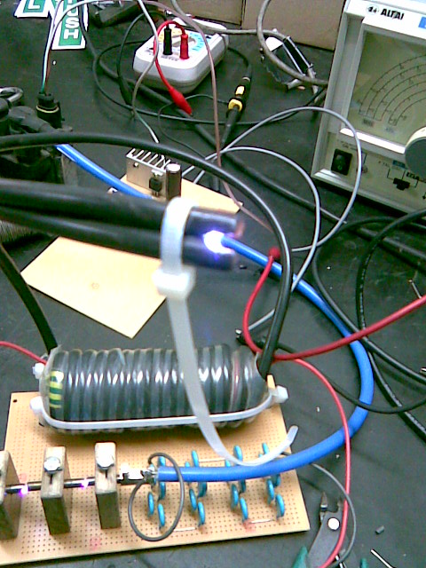

A transformer I made a while back that is just like post 1 'cept both windings are on the outside, only I used a stack of torroids to get size up.
Ok I didnt do a load of calcs, a lot of design was done as I went but it works well.
As per Ron I've seen Rf trannies like this too.

Tig high freq arc starter?
Yup, and it works!
The 'ole thing runs from 12v.

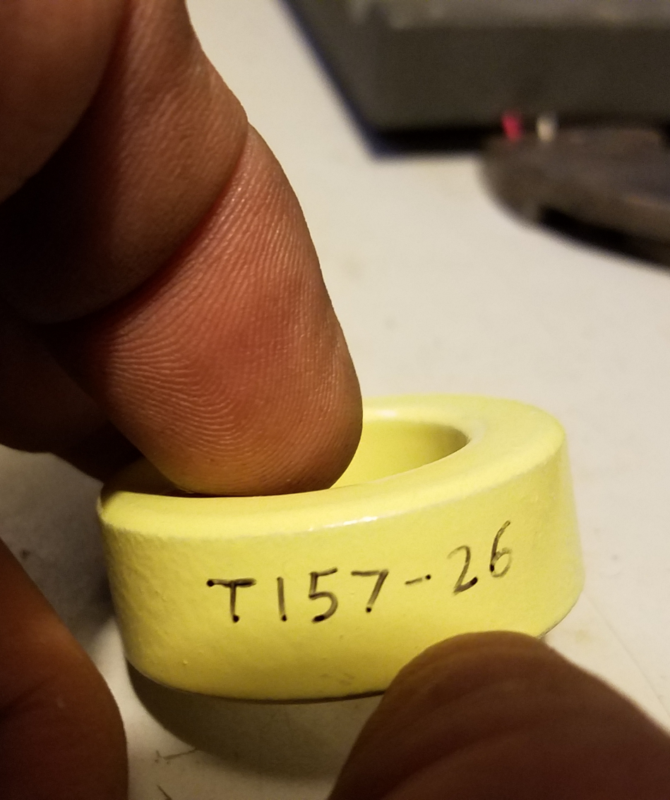

Took a T157-26 toroid.
Wound normally. 10 turns = 12.35uH
Wound 4 turns around the outside of the toroid. 4 turns = 1900nH
Same coil with no toroid. 4 turns = 951nH
Wound 4 turns on inside of toroid. 4 turns = 678nH
Same coil with no toroid. 4 turns. = 559nH
I did not test for primary to secondary connection. I think it should be bad because of the distance between P and S. And because the small coil did not connect to the core well.
I think the "wind inside" did not connect to the toroid well. Because the flux density is high inside the coil and low on the outside.
