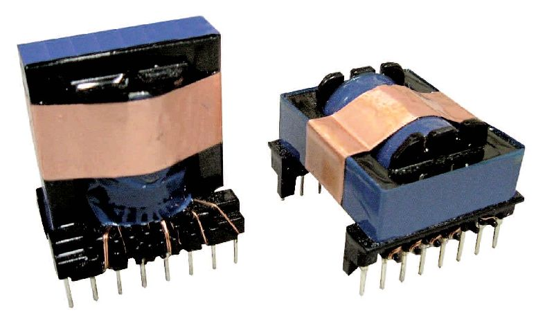

Some what related:
On high frequency supplies it is common to put a copper strap around the entire transformer. I have used gaps on all three legs many times. (like center leg batter) On the outside legs the copper strap is pushed tight against the core and touches the gap. If there was to be a "hot spot" on the strap I should have seen it. The center leg of the transformer, the wire is not so near the gap because the bobbin separates copper from the core.
