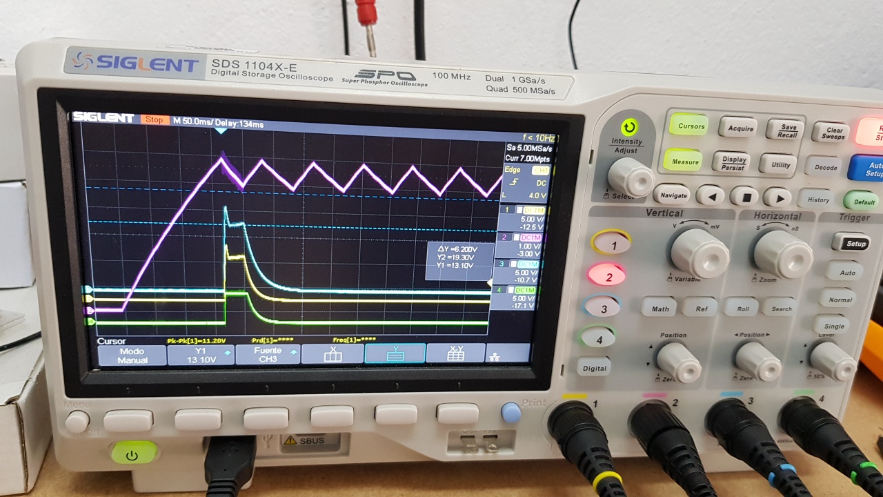

after connecting a load at output the IC is not burned anymore but look the scope signals. For some reason the voltage at control pin is not constant so is discharging until it gets 4.7V and at that point the power at output stops. We have checked for capacitors, opto and resistor at that feedback circuit, we don´t know why the voltage is not stable at 5.7V at that point.
The other signals are voltage outputs 12V, 8V (feedback) and voltage at zener (green line)

If you are getting 20V on the 12V fedback supply after a single cycle, I'd say the transformer is designed for a lower mains voltage or it's incapable of operating without a high current load on the output.
The IC has no chance to properly start up and achieve regulation under the present conditions.
I'd expect that to an extent, theres no compensation in that system so theres going to be some oscillations.
Finally we supplied the board to be tested at original load and it worked fine!!! Thank you everybody.
