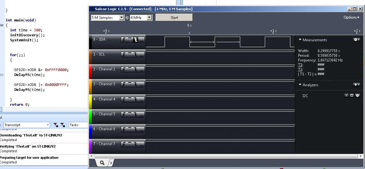

Thanks again here is a sample of what i got towards delays... Almost PERFECT!
speedtest-jpg.58295

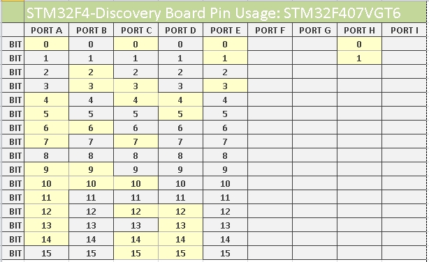

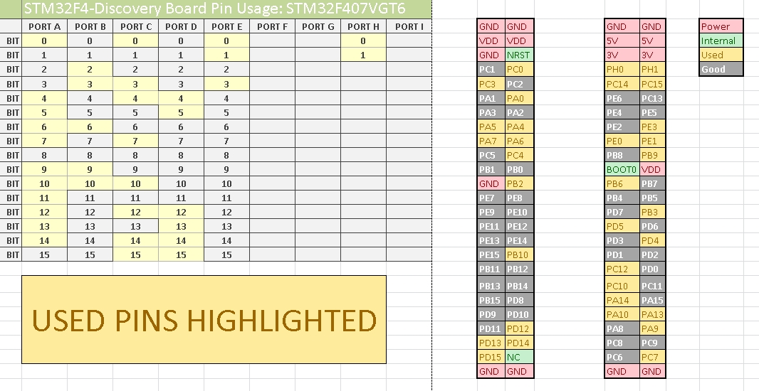

wow im a idiot. Im trying to get a LCD to work assuming all the pins broken out are free and they are not so i made a EXCEL Sheet (image for you people) of all the PORT pins and which ones are used up and free... Used are highlighted.......
stm32f4usage-jpg.58331
