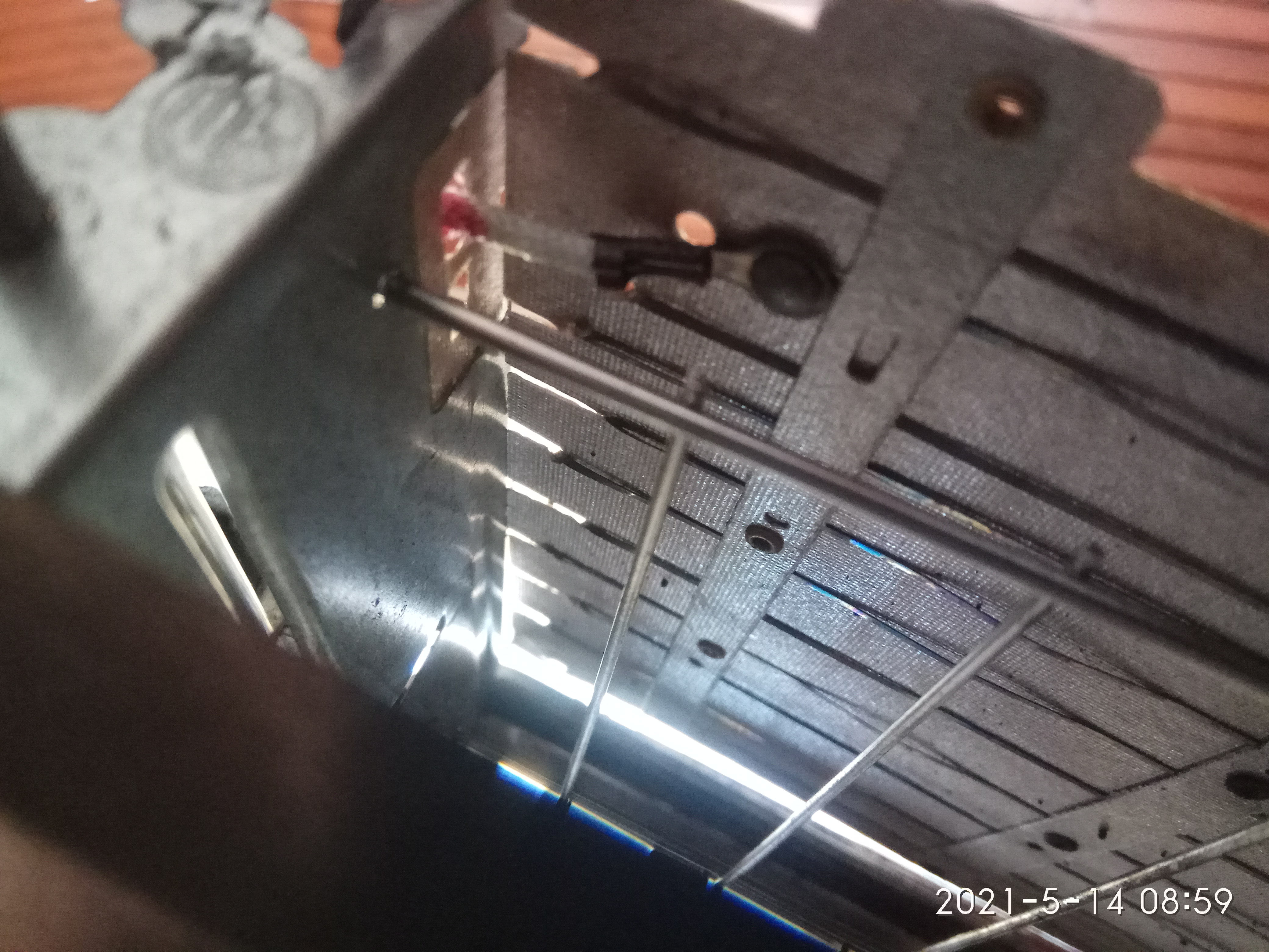

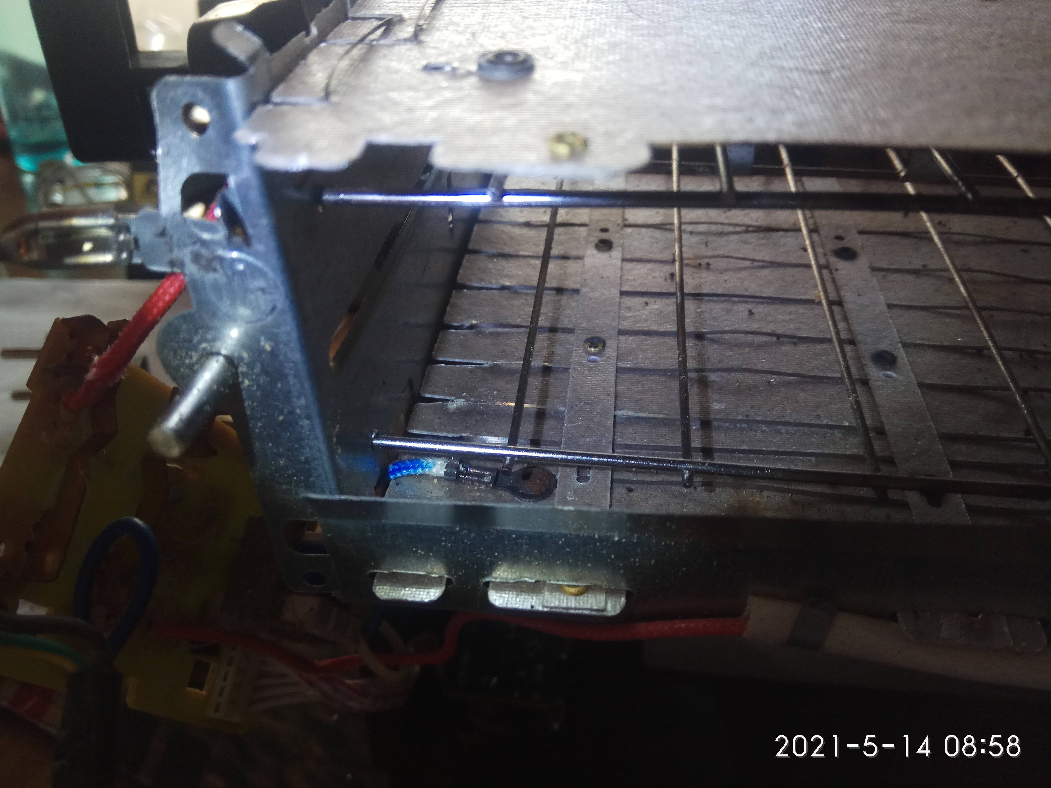

I don't know if I'm doing this right, but I used the multimeter probes on these red and blue terminals in the ohms options on the various sensitivity settings, but didn't get any readings:
From the way you seem to be testing you are assuming that the two elements are connected in series. Have you verified that this is the case ? (You could test each individual element. ) It is very unlikely you can buy replacement elements.

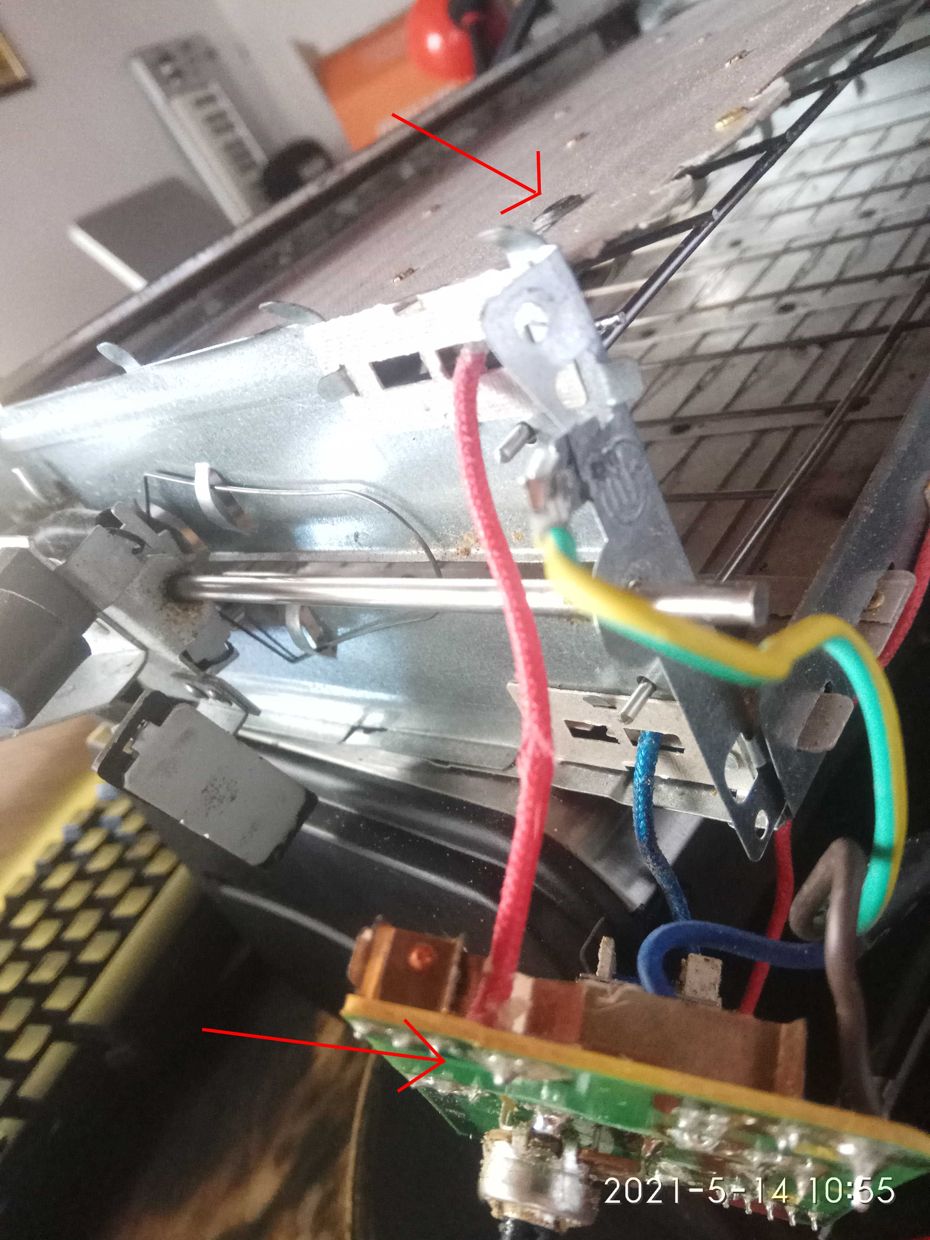

I did not verify they are conected in series, in fact after reading your post and looking at the toaster I don't think so. So I tried the probes, one on the terminal and one on the correspondent point on the PCB:
And got a reading of 1.5 with the 200 ohm selected on multimeter, on both red and blue wires (so, both elements). Does this means they are functioning properly?

Most probably - they are simply a piece of resistance wire.
There 'may' be a thermal fuse, they usually look like a silver diode, and blow if it gets too hot.
Measuring with the wires connected to the PCB may mean you are measuring resistance on the PCB itself, it does not mean the elements are good or not. The only sure way to test the heating element is to remove one wire from the PCB, and only then measure across the element with an ohm meter. That eliminates any resistance from the PCB itself.
Your reading suggests the element may be good, but if something is conducting on the PCB, it can throw that reading off.
That is VERY, VERY unlikely to be the case with a toaster - perhaps you would care to suggest a scenario where that might possibly be the case?.
So any idea on how to detect the problem, should I remove the wire from the PCB to measure OHMS like sagor1 suggested?
