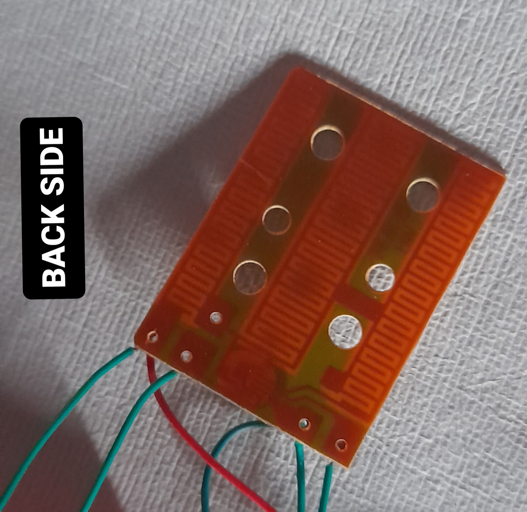

I have this with a speaker attached to it. It has some default music feed into it. I would like to change the music. How can I do that? I don't have any prior knowledge in this. Step by step help may help me achieve this! Thanks!
sorry, but it's just not possible with that type of device.
There is an integrated circuit hidden under the blob of white epoxy; that would have been programmed at the factory & the extra connections needed for that programming are now buried.
It could also have been a one-off programmable or even mask-programmed device, that could not even have had the content changed in the factory.
Even then, it's not possible to program or re-program anything without the full technical information on whatever IC was being used.
You can get various types of recordable devices or sound players that you could possibly use in place of that original device?
How many different pieces of music does it have, and how long are they each (timewise, the dirations)?

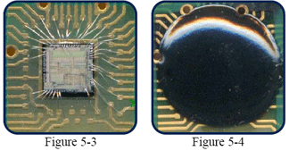

ps. Do not try to remove the epoxy covering the IC; it is built using a "COB" type assembly and there are hair-fine connections hidden within that protective blob.
This example has a lot more connections, but the same type of assembly - tiny wires spot-welded between the IC itself and the PCB around it, finally covered with epoxy to prevent anything being damaged:

Thanks for that great information! I am a complete novice to this. The chip was of no use of mine since it was built with a default music. So, I thought that if I can change the music then I can use it for some project. But as per your information, I think it cannot be used again.
Could you please suggest how can I incorporate a sound with a similar chip? And what the chip is exactly called? Thanks for your immediate response

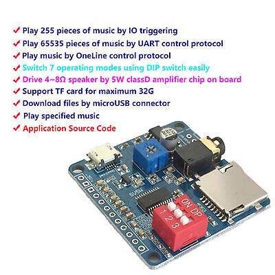

What duration?
A single clip, or multiple selectable tracks?
Something like this is probably the most practical for long durations or multiple sounds/music tracks; a few different songs/recordings can be played just by switch contacts, rather like your original device - or a large number, if you use a more complex control system:
The complicated module above might need a computer to program it and play something back.
Look in Google for Audio Record/playback Module. Many of them have a mic to record with but to save a recording the module might need to be powered all the time. The module is designed to play a voice or beep a song but not play high quality music.
