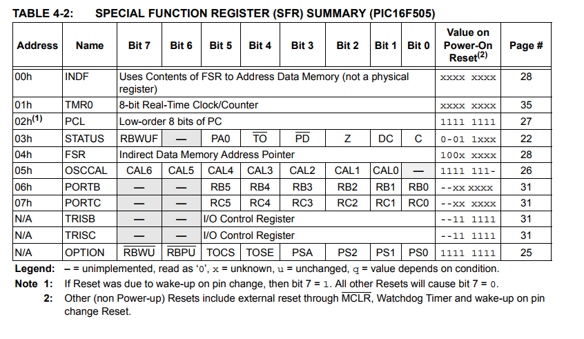

I been play with the timer on a 16f505
Trying to figure how to load a counter and test each time it fills up.

You'll wait a long tome for the IF.;) The 12(16)F50x do not have interrupts.
I think the only way to detect overflow of TMR0 per se is to poll TMR0. For example, a "movf TMR0,w" or its equivalent in C should set the zero flag in STATUS (i.e., STATUS,2) when the timer rolls over. I have not actually tried that, though. Running it at 1:1 may be more difficult.
If you want counts less than 256, then you can do presets or various subtractions or additions to determine the actual count. At each rollover, you need to repeat any presets.
John
Poll the bit I though about that. Trying to bit bang serial in C but i'm learning.
