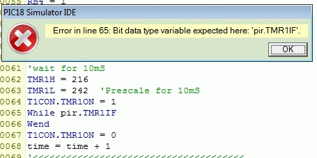

Hi I,
The program is not compiling in Oshonsoft (Is it an Oshonsoft problem?)
It doesn't like:
While
PIR1.TMR1IF
Wend
What should happen is 'say' the input reads 30, then a string of degrees: 1-20ms-2-20ms-3-20ms-----------27-20ms-28-50ms-29-100ms-30-stop. (Remember, I'm making it up as I go along).
I think the REAL program seems sensitive to time changes, as it seemed to change when I removed unwanted lines. I'm no expert so it could have been something else??
C.
C.
To be honest... I don't really know why you need a timer to measure 10mS and not waitms 10..
I should imagine you just need a heartbeat... Each 10mS that passes the time is incremented!!!... Is this what you need??
Hi Ian,
It wouldn't compile.
EDIT: Changed to PIR1.TMR1IF and now it simulates. I'll be back.
Thanks.
C

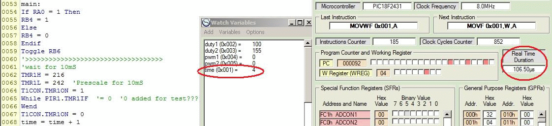

I am trying to get a simulation in Oshonsoft, with the above program, but it appears to me that TIME is incrementing every LOOP not as the timer set-up, am I correct?
See attached image, 4 counts in 100ish uS.
EDIT: Today I tried a simple 50ms wait (My original post asked for 100ms) The counter was ok, but there was hunting around stopping at the SET-POINT. I might be able to iron it out if there's difficulty getting a TMR to work.
C.
While NOT PIR1.TMR1IF
My mistake sorry... If you want to run the program as fast as possible, but only updating time once every 10mS
if PIR1.TMR1IF then
time = time + 1
PIR1,TMR1IF = 0
TMR1H = 216
TMR1L = 242​
endif
