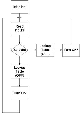

actually i do develop lookup table which have 64 values (size)i.e. 6 bits inputs...
i want my PIC have a time delay for the given inputs (6 bits)...
instead of using retlw (if can)...is there any alternative way to put my pic working as using retlw...
thank you..

for the purpose of using single ic(pic), can i replace the
retlw b'0001'      ; 0 off
with
goto ShortDel
for short delay(1 minutes)...
off - short delay
low - 5 minutes delay
med - 15 minutes delay
high - 30 minutes delay
if possible, i'll have an array (table) of GOTO intruction as RETLW in my previous code...am i right?..
if not...how do i handle this thing since my PIC have 64 possibilities inputs? to give approriate outputs...(time range delay, 5,15,30 minutes)
thanks

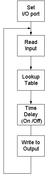

You simply need to call a routine which delays a certain time, multiplied by the value of W. So if the delay time is 1 second, calling it with 1 in W delays 1 second, calling it with 64 would delay 64 seconds.
You can modify your routine like this.
read  movf   PORTB,w          ; read input from port B
      andlw   b'00111111'       ; mask of bits
      call   table             ; refer to table, compare with inputs
      call   DelayW         ; delay W number of times
      movwf   PORTA          ; write to outputs
     goto   read            ; re-read the status of inputs
Obviously you also need to rewrite the table, so it gives the time delay values you require. This is the DelayW routine from my tutorials, it delays 1mS for every 1 in W - you simply need to make the inside loop as long as your timer resolution. You can generate that code with the PIClist generator, the 1mS delay here came from that!.

i'm sorry nigel... i don't understand how to implement the delay for the different delay by modified my code..
if i'm going to put delay 5,15,30 minutes...
      call   Delay5        ; 5 minutes delay
so, how will my pic know to delay 5, 10 or 30 minutes..i'm sory ...eally hard for me to understand... :( ..
need more expalination..

      retlw   0x00
If you 'call DelayW' with 1 in W, it will delay 5 minutes, if you call it with 2 in W it will delay 10 minutes, and so on. You 64 word long table just needs to return the required value in W.
It's simply a loop encapsulating the delay routine, W is transferred to count1, this is decremented after the 5 minute delay and the delay routine repeated, once it reaches zero the routine returns.
Because the delay is 5 minutes, that's your resolution, if you made the delay 1 minute you would have 1 minute resolution, and a maximum delay time of 255 minutes.
meaning that i just put 'multiply' value in my table?...to give appropriate delay to my output...
about the table...i still do not understand how it will work for this time delay..how do i put value in my table?...how about this..

pls advice...
alamy said:
My system have 6 inputs and 1 output (on-off) …variable time delays.
My pic have the 64 possibilities input value which produce 6 or more type of output that is time delay for ON (5,15,30 minutes) and also time delay for OFF (5,15,30 minutes). For input range (possibilities value) 0-32 …my pic will OFF with certain period (5,15,30 minutes) and 33-63 it will ON (5,15,30 minutes) .
My program flow will be like this:--
then for the read routine :
After you've read the port and applied 'ANDLW' you have a 6 bit number in W - I would suggest you store it in a temporary register.
movwf Temp
You can then check bit 5 to see if it's '1' or not, and the program can branch accordingly - to routines to either turn ON or turn OFF then delay the amount of time set.
You then only need a 32 byte table (because bit 5 isn't part of the table), so you should 'ANDLW b'00011111' before calling the table.
Another way of doing it, would be to use the full 64 byte table, but for the second half of the table have bit 7 set in the entries, then after reading the table test bit 7, and turn On or OFF accordingly - remembering to mask off bit 7 before calling the delay.
The first way would be shorter, because you half the size of the table.

pls comment my program flow..
read input (set 31 as setpoint ; branch to TurnOn/TurnOff) and i'll have two table ....
i've no idea on this...
