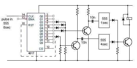

Just an idea...
Hi Sebi,
Your diagram is neat and the use of a decade counter is
very tidy.
If an electronic answer is the way to go, that looks
very good.
Personally, i prefer micro switches, out in a field if
your stuck, you can poke them with your finger to see
that they work.
Electronics is not everyones cup of tea.
Many people are ok with wiring and switches, its when
things go wrong that causes most trouble.
John :)

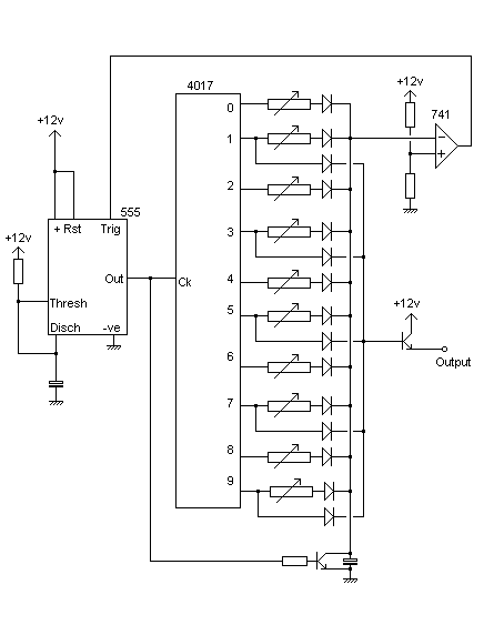

Baler timer
Could this be developed to do the job?
The 555 is arranged as a monostable, a fixed 1/4 second pulse.
Each output pulse will increment the 4017 decade counter.
As each output of the 4017 goes high it will select a diferent charging
resistor for a capacitor which will charge up to the threshold of the
comparator (741 op-amp), this will cause the 555 to be re-triggered,
producing another pulse to increment the 4017 and simultaneouslt discharge the 4017's timing cap.
Every other output of the 4017 is dioded together to produce the motor drive sequence.
Every step of the sequence can be adjusted to generate any reasonable timing value.
As drawn there is no 'rest state', the circuit will (should?) sequence
forever but this is easily corrected by skippling a diode.
Thanks for the reply. I am not real familiar with the operation of the 4017. Will it automatically select the next output each time it is triggered? What about the off intervals in the timing cycle? Is there some way to generate the pauses between outputs?
I went back and reread your description and I think you a generating the pauses or off times by only connecting every other output and allowing those in between to only be used to retrigger the 555.

The 4017 is a dead common decade counter - each pulse on the input (clock) will
increment the counter, energising the next output (only that one output).
When the 4017 is reset (a simple addition to the circuit I drew) it goes back to outputting only
on the '0' output.
I intend that every output of the 4017 will retrigger the 555 (after a delay)
so that you will have ten seperate delays, each independantly adjustable.
The first delay is your 16 second 'dwell', so there is no output and the relay is not energised.
The second delay determines your 1 second long output pulse- relay energised.
The third delay determines your 8 second dwell- relay off.
Etc. etc.
As each stage is a seperate delay you can 'twiddle' with various timings to alter the string winding-
a panel of ten potentiometers could be placed in the tractor cab for on-field control.
Remember I said this is a 'concept drawing', it will require some development to finalise the arrangement :!:
But I see nothing that looks difficult here; the idea could be expanded to give more steps or less, as you get better at macrame :wink:
If a second 4017 were added (simple cascade for upto 19 outputs) then the 'return to start' could be a part of the circuit - reversing the motor shouldn't be difficult.
