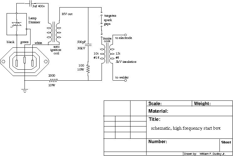

PS, Here is a typical application: https://hackaday.com/2009/01/19/high-frequency-start-box/

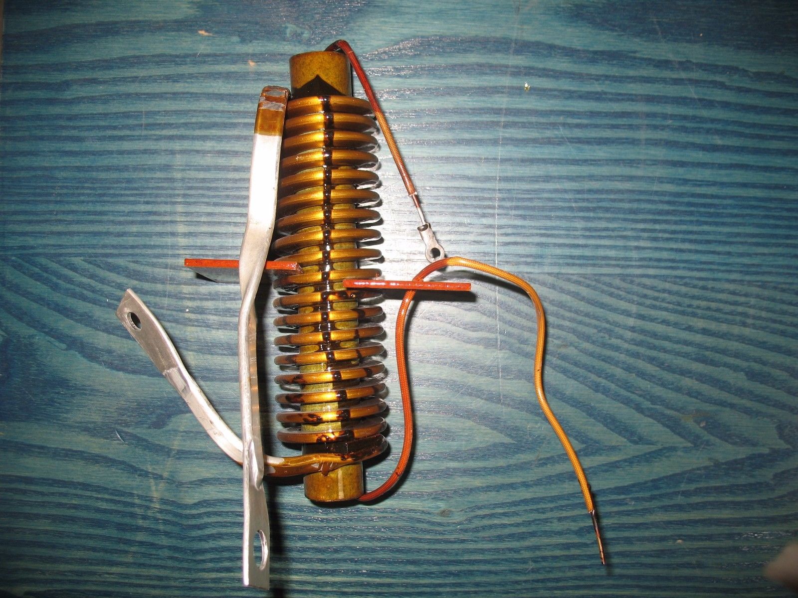

Its a factory miller or hobart coupling trans. but I cant see what or how many turns there are on the inside. Also the wire looks solid, at least for the secondary if that has anything to do with it.
You may have the answer with the torroidial design, Im gonna see if I can locate a core to try it.

Yea, I think the old auto ignition model on your hackaday link is what I need. Lower Freq and I also noticed the dimmer which I could use to keep it at a safe voltage.
That would appear to be the best way forward as it seems to be a proven approach.:cool:

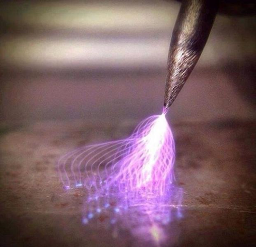

Just a picture:
Apparently this shows an HF arc produced by a square waveform with a fundamental frequency of 2MHz and harmonics extending to 20Mz. The voltage is not stated. **broken link removed**

Most of the commercial welder manufacturers use what looks to be a simple air core coupling transformer.
I forgot to mention that an air-cored coupling transformer would imply a high frequency signal in the MHz region,

I think the gap it would need to produce would be no greater than 1/4". The ones that I used back in the 80's, you touched the tungsten to the work, lifted it then hit the pedal and that kicked on the HF. In doing this I think you could get by with 1/8" or less.
Hmm, that is interesting. I was imagining a much bigger gap, about, 25mm (1").
Using a spark over voltage of 1KV to 3.5KV per mm (https://onlinelibrary.wiley.com/doi/10.1002/9780470495070.app3/pdf) means that at 3.175mm (1/8") air gap the required maximum HF voltage would be 3.175mm * 3.5KV ~ 11KV (peak) which not too daunting. But I suspect that the serial coupling transformer, that is normally used, is very lossey.

Yep I just thought it was a super cool pic, and it came out of my TIG folder which almost certainly came from welding web where I was researching this. Weird but its actually beautiful.
That is what I thought too.:cool:
I am surprised how unfocused the spark appears to be and would have expected a narrow column of ionized air. I once made a 20KV generator (not for welding) running with a 16 Khz 20KV peak to peak voltage at about 5ma. With a 10mm air gap the arc was quite well focused and started immediately with no messing.
If my memory serves, that is how the arc looks when you pull the electrode farther than its "comfort zone". We used to play with them in high school and it would look just like that as you pulled it away just before the arc failed.

I can dig out everything besides that and the 500pf cap, Is there any substitution room on that? I want to recreate this guys results. Thanks
The total capacitance needs to be around 470pF +100% -zero% and the working voltage needs to be 30KV or over. You can connect any number of capacitors in parallel to make up the total value. For example 5 of 100pF, 30KV capacitors would be OK, as would 330pF, 30KV and 180pF 30KV capacitors. I would think that the best source for extremely high voltage capacitors would be eBay.com.
