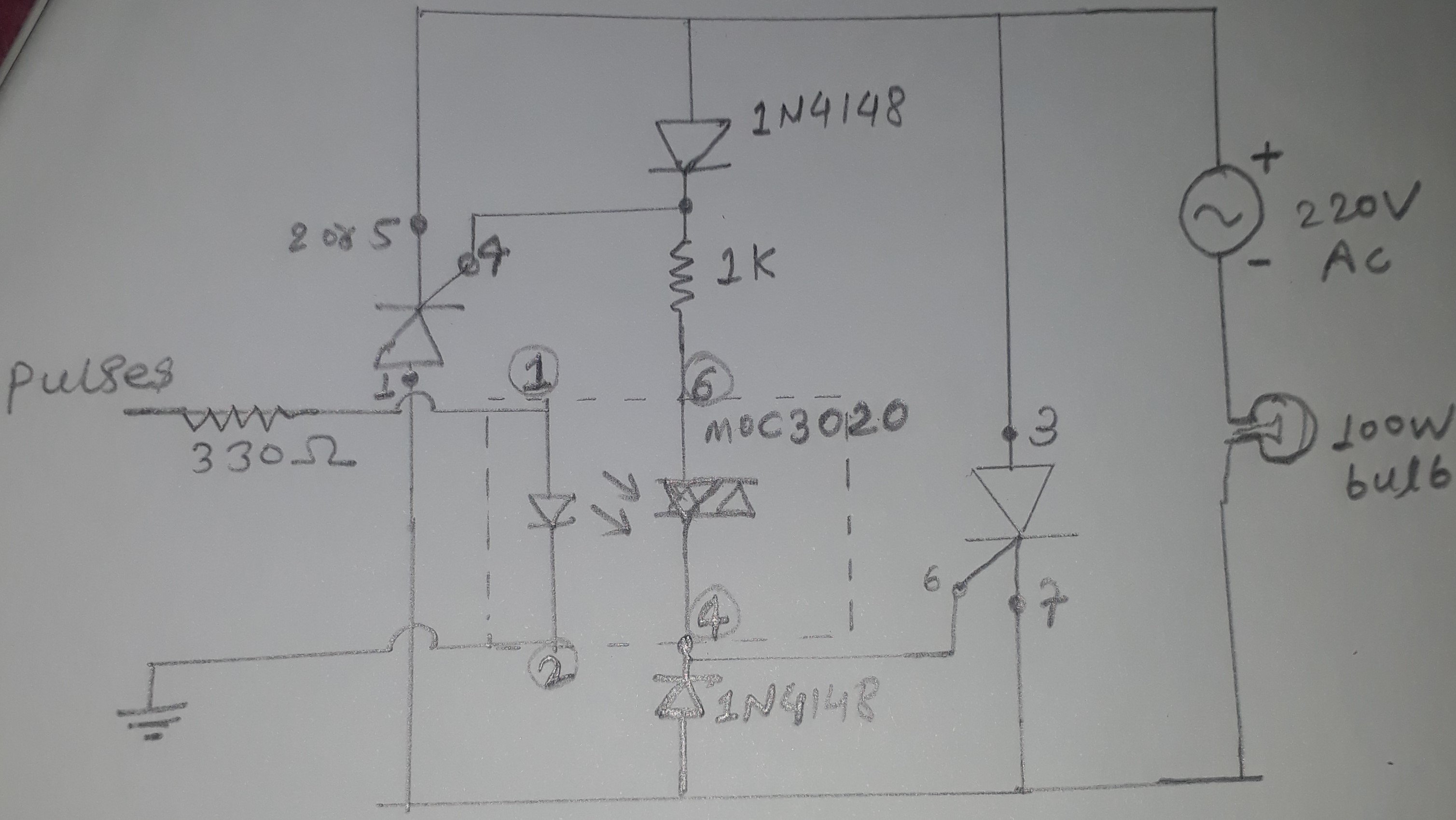

Hi, I have a thyristor with the connection as in this thyristor and i am trying to use it as a traic. So i shorted terminal 2 and 3. terminal 1 and 7 are already connected as in this thyristor.Also i have shorted both the gate (4 and 6).Now i want it to act as a traic with terminal M1(7) and M2(5) and gate(wire that has connected 4 and 6). Will this work?
Problem: When i simply gave supply to 7 and 5 with a blub connected between them(no pulse signal to gate) the blub glow. Then I checked the individual gate terminal with my tester i saw a phase indication present in gate terminal 4. That was causing the blub to glow. But i expect no phase indication in both gate since i want it to be controlled through my pulse signal. What actually is happening in this case and how can i solve it?
Note: my connection is same as in second picture.
Thank you.
The triggerin in an antiparallel SCR configuration is different than from a Triac.
In a Triac you will always have three quadrant triggering and in select types, four quadrants.
But in the antiparallel SCR only two quadrants are available.

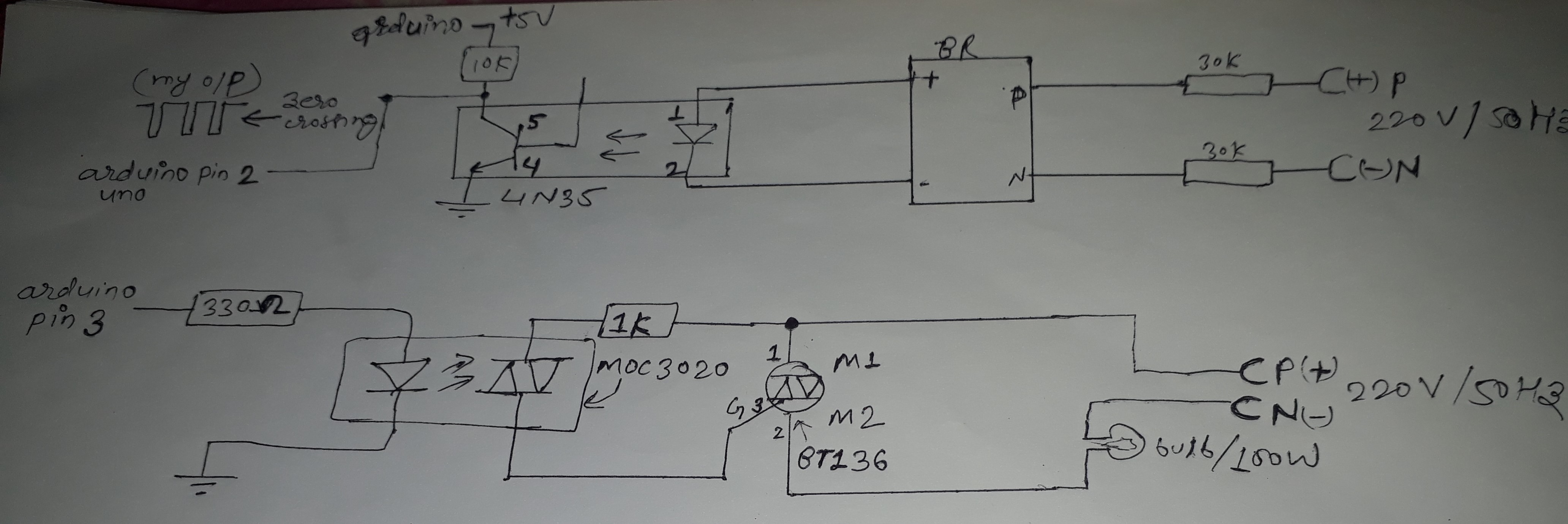

Actually i am trying to make a dimming circuit that can be controlled through the number of zero crossing. It looks something like this(fig 1). I am trying to trigger gate of triac to give variable power to the load.My overall program is this:

But the problem is : when i count the zero crossing per sec it works well, When i fire the triac alone it too works well, but when i tried to control the firing according to number of zero crossing per second as below, there appears a problem.
if(zc>100)
dimming=0*128;
else
dimming=0.5*128;
The problem is if i call function firing() within void zero_crosss_int() (as below) then number of zero crossing per second (which is want) goes higher than it should. I think this is due to delaymicroseconds() inside firing() which is causing some delay and made the time more than 1 second.
count++;
firing();
Can you please suggest how can i do both stuff ( calculating zero crossing per second as well as firing the traic) at once. Thank you.
