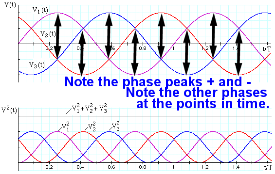

Please have a look these two pictures:
At "A" point the Phase 1 waveform has an upward direction and is very close to the peak voltage. In other words, at "A" the push is almost maximum. But there should also be an equal pull to suck that 'push' of the electrons (or positive carriers in terms of conventional current) in other two wires. But the problem is that at "B" the Phase 3 waveform is going downward but that pull is not equal to the push in the Phase 1 waveform. So, there should be an additional pull to compensate the push of the Phase 1 waveform. But there is no additional pull available because Phase 2 waveform at "C" also moving upward which is also a push. So, I hope you see the problem here. By the way, points "A", "B", "C" are located under each other. Now please guide me. Thanks a lot.
I think you're confused about how to interpret that graph.
You're talking about the directions the waveforms are moving at the point you've selected. That's totally irrelevant to the question you asked. All that matters are the instantaneous values of the waves at that point. So for the point you chose, which is a little before the peak of Phase 1, the opposing forces (the "pulls" as you put it) are the values of Phases 2 and 3 at that point. Doesn't matter which way they're moving; all we're interested in is the value at that point, like a snapshot in time.
If you add together all the pushes and pulls at that one point, they will equal 0.
Remember, "push" and "pull" depend on the position of the wave either above or below the X-axis, respectively, not the direction the waveform is headed.
Typical rookie error. Don't sweat it.

I mentioned this before. The graph is just a graph. The sine waves could be voltage or current. However since it is -1 to +1 if you look at where phase A is at the positive peak you will notice that phases B and C are both crossing -.5 so if you add phases B and C you get -1.

From my very basic study into calculus I think the slope at A and C is increasing (or positive) but at B is decreasing (or minus), so how are the push and pull equal? Please guide me. Thanks.

Does this attached image help? Note the black arrows. The same is true for any point in time with any phase with respect to the remaining phases but at peaks positive or negative it is much easier to see.
The same relationship would be true of the output of a center tapped transformer. I would have two signals 180 degrees out of phase. As one goes positive the other is equally negative.
Forget the slope. Slope ain't got nothing to do with it.
It's the instantaneous value of each phase at the selected point on the graph that's important. That's where you add the voltages, and determine that, for the point you selected, the one voltage "pushing" (Phase 1) is exactly balanced by the other two voltages "pulling".
Again: the push or pull is not the slope of the curve at the point; it's simply the Y-value of the curve at that point.
Re-read this a few times if need be. Again, forget slope.
