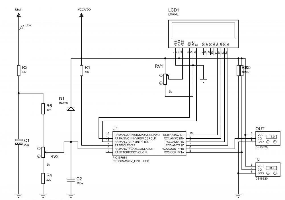

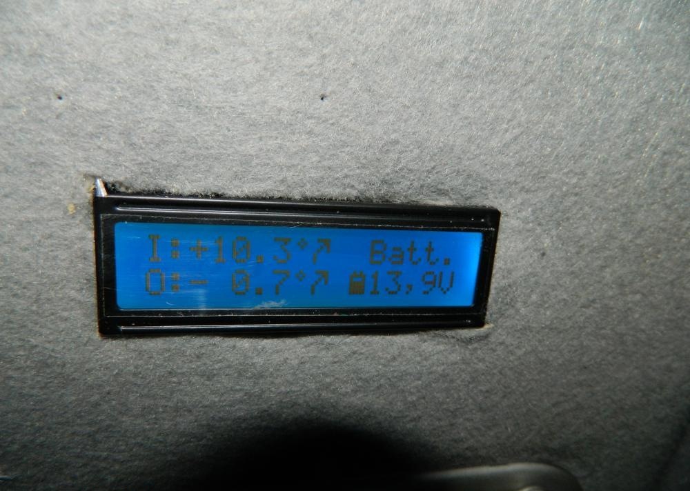

I have a circuit design for a volt\dualthermometer for automobile but i don`t have the software for the pic. Can anybody write a software similar to the picture?
