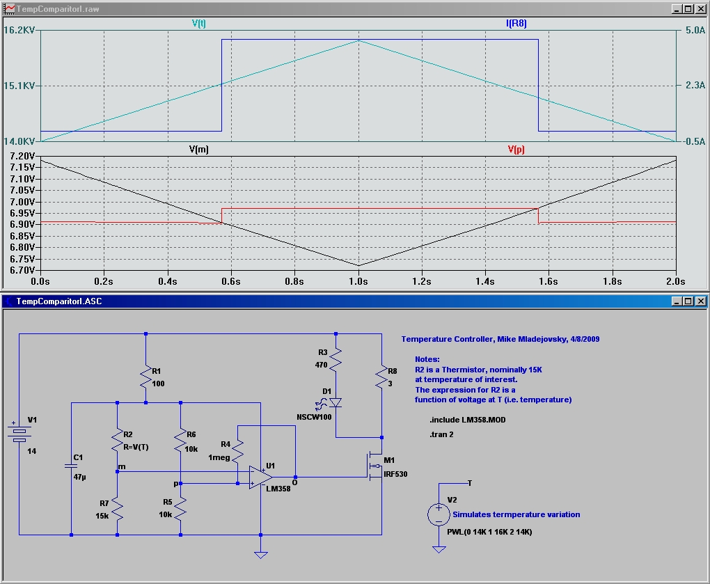

i wanna design a circuit that will turn on a heating wire at a certain temperature, maybe 35F, and it will turn off around 40. If anyone has some ideas on a circuit help would be great, thanks.
im thinking of using just a bimetallic strip that will trip when it reaches a certain temp, i just want to make it a little more fail safe
Its all about the sensor. Get hold of one first, and then design the circuit around it. Ideally, you want it to have a resistance of ~10K at your set-point temperature.
Usually, the thermistor is one arm of a four-arm bridge. A comparator senses the voltage across the bridge. The bridge is balanced at the set point temperature.
Positive feed back around the comparator provides a slight amount hysteresis to prevent chatter as the sensor heats or cools through the trip point. The comparator output is used to switch the gate of a power FET to switch the load...

Cool it in a refrigerator, which will be at about 37degF, and measure the resistance there. You will have to tweak the values in the four arm bridge so that the bridge balances near that temperature.

No timer needed. As the environment that the thermistor is in heats and cools, the heating/cooling load switches on and off. The "timing" is done by the thermal mass of the environment that is being controlled. Think of a house thermostat, or your refrigerator. No timer in those...
