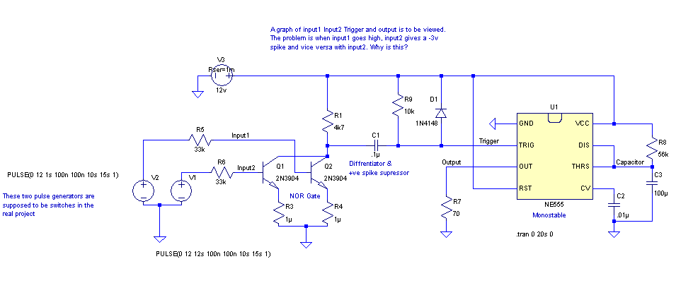

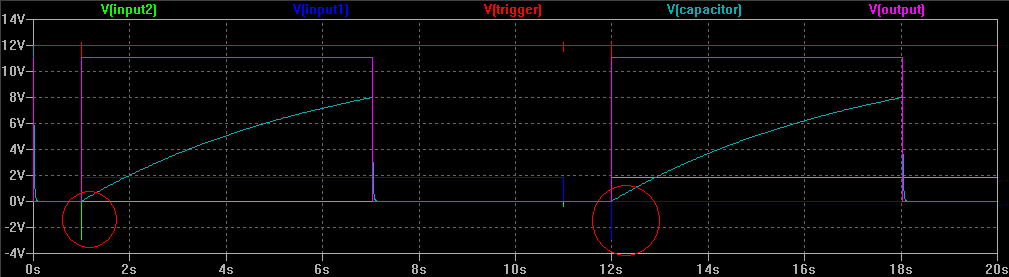

Here is a circuit that is a part of my project. The problem is the two spikes that I just cannot explain.
I am as much intrested in knowing why they are there as much as getting rid of them.
Please Help.
Thank you.

When input1 goes high, the voltage at the output of your NOR gate drops because Q2 turns on. This voltage couples back through the collector-base capacitance of Q1, causing the spike on input2. The problem is caused by the fact that you are using two nuclear bombs (2N3055, which has huge junction capacitance) to kill a mosquito. Change the transistors to any small-signal part (e.g. 2N3904), and the problem will go away. You don't need R3 and R4. R1, R2, and R9 can be at least 10 times larger. Your base resistors can be 10 to 20 times the parallel resistance of R1 || R2 || R9. Also, your timing resistor (R8) can be any value up to 100k, allowing you to use a smaller value for your timing capacitor.
The spike will still be there to some extent. You can clip it off with a 1N4148 from base to GND, anode to GND, if it bothers you. You should have one on each base, although I wouldn't worry about it. Base-emitter breakdown voltage on most transistors is at least 5 volts.
You are learning a lot about junction capacitance. :D

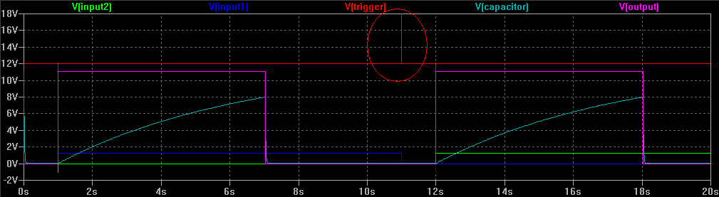

The pulse is coupling through the diode junction capacitance. A smaller diode will help, but you'll still get a big pulse (on the simulation). I think the 555 actually has a diode from each pin to VCC, for esd protection. The usual scheme for limiting the spike is as in the schematic below. Note that I also changed the base resistors and the timing components.
Also, here is a model for BC547B.

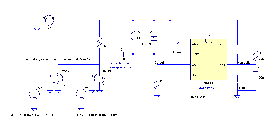

Here is how you model switches. Read about the SW element in the help file. If you want to keep the transistors, you can still model the switches driving them.
