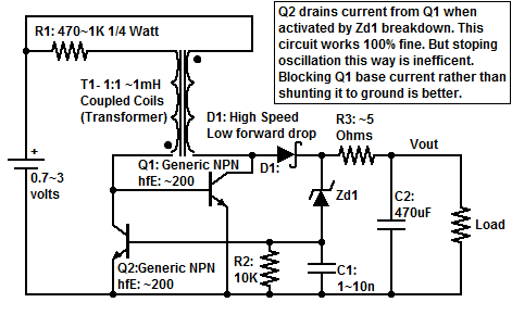

Regulation modes.

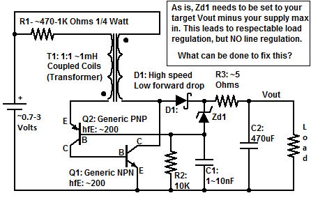

When playing around with the circuit, I noticed that there are distinct ways regulation can limit output.
(1) The bias on Q1 base is altered as C2 gets charged from leakage through Zd1. This causes the current level Q1 turns off at to drop as Vout rises. In other words, the current decreases proportionate to the voltage increase.
(2) The oscillation duty cycle changes from an even 50/50 to other ratios as Vout gets up to and beyond 2X Vin. This happens because a 1:1 charge/discharge duty cycle can only ever double the voltage for a given current.
(3) Vout gets near enough to Zd1 reverse breakdown that the spikes from T1 primary momentarily push through the zener. This causes different bursts of counter biasing that limit the current in a staircase pastern.
(4) Finally, Vout reaches full blown zener breakdown levels. This causes any voltage on C2 to keep from discharging through the zeners forward drop. Because of this, C2 can only discharge through Q2 base, holding the oscillator fully off.
The following is a waveform from a circuit configuration that exaggerates each different mode of operation.
This is interesting information because if we can make good use of these two different modes of operation, then we can better adjust circuit properties for particular circumstances and applications. For example, if we could skillfully avoid the current limiting mode and go right to fully stopping the oscillation, we could potentially gain efficiency because during discontinuous mode we don't have any switching loss. This would cause more noise on Vout though. Or we could do the opposite, and get less extreme ripple, at the cost of some efficiency. This is very similar to the effects of changing the running frequency up or down, so we could do that also to get each arrangement's benefits.

Your chart of regulation operation is cool. That discontinuous mode looks great, and it could be very efficienct for low load current applications. That is a good achievement.
At this point, apart from proving the design through the whole operating range there's not that much needed to improve it? One thing to think about would be some type of RC delay, preferably adding to the OFF period. That would give a forced longer off period, so causing a longer on period to regulate and reducing the frequency. It would also mean greater field strength in the transformer during turnoff so would mean better feedback energy to give harder switching?
(edit) Actually looking at the circuit you could do something very similar to the "cap dumps into cap" thing I did on my 2tran buck regulator. If you put a small cap from Q1 collector to the top of C2 in the killer regulator... When it goes to turn Q1 off the cap will dump energy into C2 so there will then be a longer period where the Q2 is turned on (RC delay caused by C2 and R4). Likewsie it should extend the length of the ON period too.

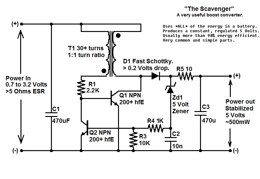

OK, so I think I am just about finished designing this. It looks like I have taken it as far as it can reasonably go. Everything else is up to the specific application, parts available, and person building it. So here is the more or less final schematic...
Pros.
Will start and run from 3.2 volts, down to 0.7 volts, with up to 5 Ohms cell ESR.
Uses every last drop of a cells energy, even past 0.7 volts. Reducing waste.
Can supply 500mW of usable power under optimal conditions.
Has greater than 95% efficiency under most conditions. 98% with careful tuning.
Uses the most common of parts. And not very many of them.
Is fairly small and light. The inductor is the largest part.
Has good regulation, and acceptable ripple for many things.
All operational parameters can be 100% adjusted for almost any need or condition.
Simple enough to be built by the novice with high likely hood of success.
Virtually no possibility for electrocution.
Should be more ESD and EMP safe than typical IC based DC-DC converters... LOL.
Has natural reverse battery protection... I think ???

Nice going there! Are you going to show some charts of Vin or Iout regulation or efficiency etc? They are nice to have on a SMPS project.
Also some info on your inductor type like inductance spec, and a photo of the toroid etc to give people an idea of the size to look for and roughly how many turns of X gauge wire they need etc. Also the size of recommended inductor will help to finalise a PCB.
If you don't want to do charts then I'll try and get some time over the next few days to put one together and chart it. :)
(edit) As a suggestion, you could preplace the zener with a lower voltage zener and a forward biased LED (high brightness type). Then when the output is at full voltage and the voltage regulator is working the LED will light, showing the boost is operational. The LED should not hurt efficiency as it uses pre-existing current.
Considering there may be some risk of the circuit not starting up (especially if it's using a bad battery) having a "boost ok" LED would be a nice touch.
I would like to, but I'm not sure exactly how to go about it. The simulation differs from reality, and I don't have a real good way to chart certain aspects of a real world device. My Ampere meter is too flimsy and would interfere with the measurement too much to be considered reliable. So I would have to calculate based on impedance, which is what I have been doing so far.
Just from simple observation, Vin appears to have almost no effect on Vout over the entire range until around 0.8 Volts. Iin is about the same story unless both Iin and Vin are some what low at the same time. Bottom line, when it comes to line regulation, as long as the total power is available on the input, and the load doesn't change the circuit will boost to target Vout ± 0.05 Volts, over all of Vin.
The load and output current is a different story though. Just doing a quick and dirty test with two mostly dead batteries in series, I found that there is only a 0.1 Volt change in output voltage from no load, all the way down to 470 Ohms Load. Then going from 470 to 235 Ohms, it dropped by about 0.5 volts. And even farther with any more load. So... when device load exceeds a certain point, there is a knee that it will cross and the Vout regulation will drop significantly. More input power will extend this knee for larger and larger loads. At some point, you need to use a bigger inductor and or better transistors to extend the knee any farther. But this is for power levels at or above 150mW, and I expect most DIY battery powered devices will not draw more than this on average anyway. Otherwise, you will need to accept larger losses from R1 and Q2.
As for the minor drift of 0.1 Volts, this is most likely because the zener doesn't break down exactly perfectly with so little current going through it. This could be fixed by using a TL431 or similar, as they have nearly perfect breakdown. One other thing, zeners are rated based on a certain bias current, usually around 1mA. This circuit doesn't use zeners in the same way as would be normal though, the current needed to trip Q2 into regulation is usually much much smaller than this bias current. So the accuracy of your zeners breakdown voltage may be compromised when using it for this circuit. I'm using a 4.7 Volt zeners that makes the output 5.5 Volts for my actual device. Careful tuning of Q2 base resistors can get you exactly 5 Volts if you want perfection. But your also going to want to do some other things and they are going to hurt efficiency and power in the end.
I don't really have any set inductance specs. I don't have an inductance meter so I just go by trial and error. I have used all kinds of cores from a tinny ferrite bead that probably have only a few uH to quarter sized toroids, and all sorts in between. So pretty much anything goes. If I had to put numbers to the inductor, I would say make it more than 100uH/use more than 20 turns. Ceramic cores are better than laminated iron cores. I will probably put up some pictures when I finally make an article for this project.
As for the wire, it only needs to handle 1 amp. But using multiple strands of finer gauge enamel coated magnet wire could improve high frequency efficiency by reducing copper loss. That's assuming your go over 100Khz, otherwise it doesn't matter, just needs to handle the current.
You would probably be better at it than I am. For stuff like this I'm more of a whatever works trial and error kind of guy.

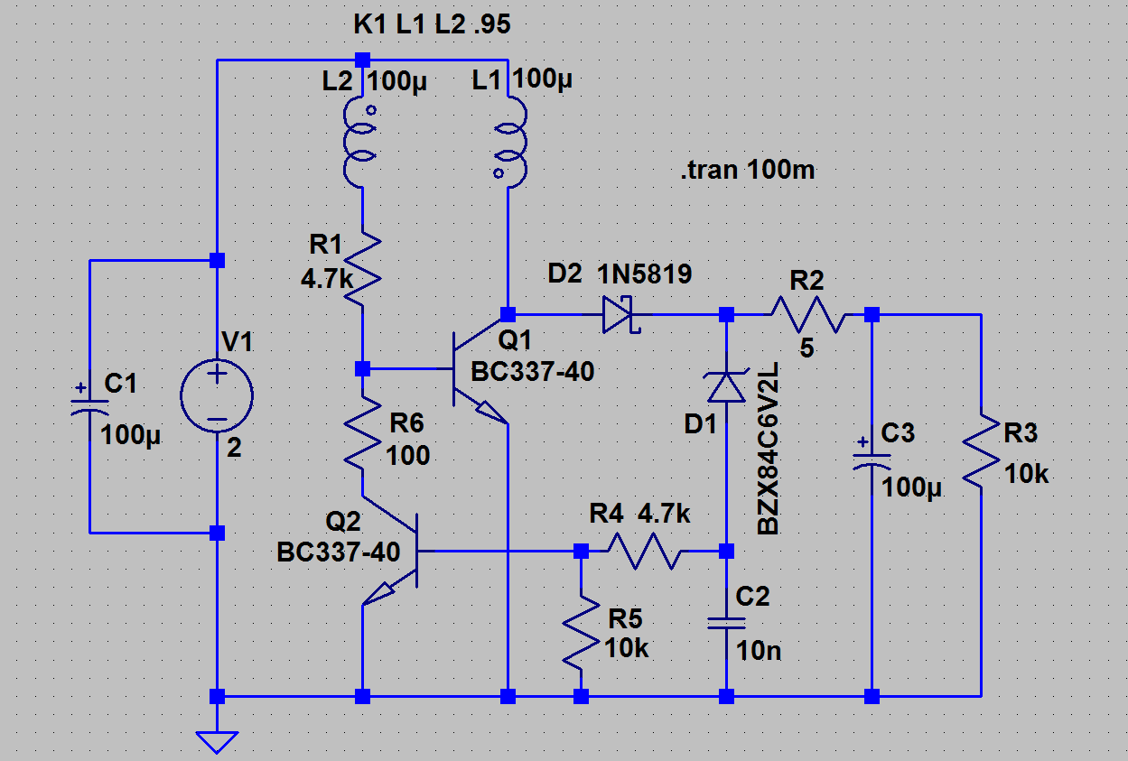

I was going to do your line and load sims, but for some reason I can't get it to run. Could you post your asc file so I can fix it?
Oh! Yeah... I definitely should do this, Here you go.

I simulated various kinds of turn ratios, nothing really worked much better than 1:1, even though theory would suggest otherwise. If the turn ratio is high on the base, with the effect of letting you raise R1, then what happens is you end up having really bad start up performance at low cell voltages. I played with ideas to get around it like putting a speed up cap across the resistor R1 to offset this, but it had little effect. Lower base-emitter voltage drop would fix this, but that would also require "exotic" transistors, which would go against the design methodology of the circuit.
If you figure anything interesting out, I would be glad to add it to the circuits page and give credit to you. I just got burnt out on playing with it, and as far as I could test it worked as described, so I considered it mission complete. But that doesn't mean there aren't improvements that can be made. So if you want to, feel free to go nuts with the base circuit.
I'm curious why reality departs from theory in that aspect. Are the simulators just not accurately programmed or are they missing something? I've been changing some circuits around vigorously in several simulators and they all seem to suggest putting a step up on the base would help alot. I posted the results over on this forum.
In LTSpice, I saw power gains anywhere from 200% on up, increasing higher and higher with lower start up voltages.
For example:
**broken link removed**, vs. circuit with step up.
Gave an increase from 8.75mW up to 52.5mW, a 600% increase in power on the load.
Or this example, with an even lower start up of 0.7V
So that one gave a gigantic increase, from .55mW up to 19.25mW, a 3500% inrease.
Then, I replaced the 2n3904 with a ZTX1048A, and saw even more power gains. From that first example where it went from 8.75 to 52.5, with a ZTX it went from 52.5mW up to 156.25mW

Here is the circuit from the article. I consider this the "finished product".
Here is something similar to the above, only with a slightly different regulator design. The problem here is you can get excessive base current when you significantly over shoot regulation. And without the base resistor it doesn't really preform any better.
Here is a design variation with an extra resistor on the regulation transistor, the idea was to try and lower quiescent current when in shutdown. It didn't really work out very well as it would just waste more current in other places and balance out.
