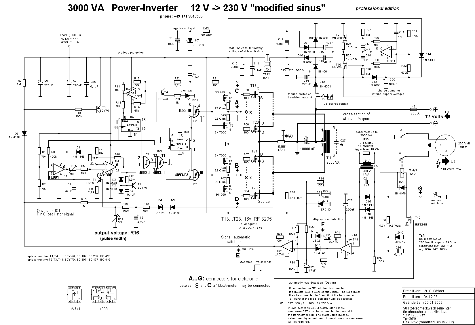

Here is a schematic for a 12V 3000W modified sine-wave inverter. It uses 20 Mosfets and hundreds of other parts.
ebuka_2 said:
That is really complicated. Is there no how that you inverter can be uprated to 1000W or so?
I told you how, just double everything:
1) Use 20 or 22 2N3055 transistors.
2) Use an extra huge heatsink.
3) Usa an opamp with higher output current.
4) Use an extra huge transformer.
5) Use an extra huge battery.
The circuit won't need so many transistors if it is modified to use 24V as its input.
You said something about changing the opamp with one that has a higher output current, can you highlight the ones I may use. Secondly, what about the diodes, resistors, capacitors and fuse, will they be change too?
I don't know any high output current opamps but they are available.
If you make an inverter with double the power of the schematic then of course the diodes and fuse must also have their current ratings doubled.
The resistors will have the same current and the capacitor also stays the same.

You may used 3000VA from audioguru's shematic as PWM (as hard switch). It using mosfet switch with charge pump for high side driving. Just replace the input with PWM (low freq PWM, 1KHz or near).
But better make it for low power first (might be just 10W). Its more save for your first try.
If the schematic too complicated, the PWM are more complicated. So, please do it step by step.
I didn't post a complicated sine-wave PWM inverter. It was a simple modified sine-wave inverter without any PWM. Its waveform is a square-wave with a step in it.
A pure sine-wave inverter that uses PWM is much more complicated.
