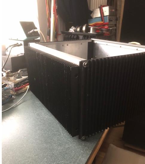

Dear Nigel,
The cooling profiles are fine, see photo.
Then I go for the 47000 uF 63 volts.
Thank you.

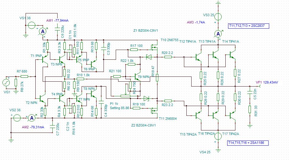

It looks like a completely symmetrical class-AB amplifier. Maybe its P1 control can be turned up so its heating is 87W in class-A when its maximum audio output is only about 32W into 8 ohms.
Dear Audioguru,
That's right, it's an AB amplifier, but I screw the quiescent current up to 1.7 Amps, 32 watts is enough.
Greeting,
Pim
Why heat your home with the amplifier? When the no bias current in class-B is increased a little into class-AB then the crossover distortion is eliminated.
That is why there are very few class-A amplifiers made.

For only 32W output it does not need 6 output transistors. A pair of output transistors eliminate crossover distortion when they idle at about 25mA.
But since transistors have a wide range of spec's, adjust the idle current while looking at a sinewave output on a 'scope.

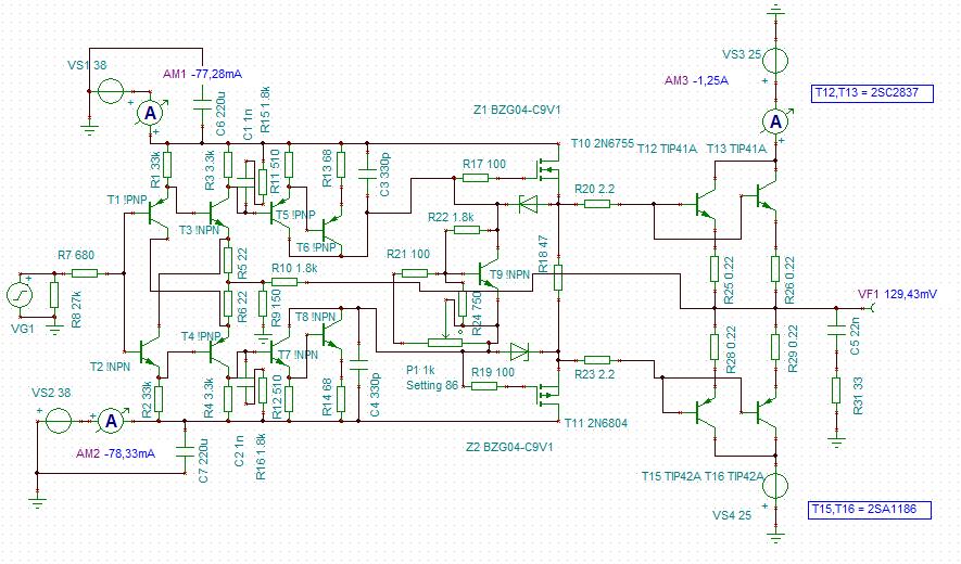

Dear Audioguru,
I already adjusted the schedule.
And definitely do the experiment with 2 transistors per channel.
I will certainly implement that with the oscilocope.

What should the quiescent current be 500 MA ?.
for AB biasing, should be between 15 and 30mA (between 6 and 14 mV measured from emitter on + side output device to emitter of the - side output device). you could probably safely go as high as 50mA (22mV across emitters). the best way to set it properly is using a distortion analyzer and at 1 or 2 Watts at 20khz. adjust the bias to where the crossover distortion disappears.
With a +/-25V supply and an idle current of 500mA the output transistors dissipate 25W all the time.
With 25mA the idle power is only 1.25W, a huge difference.
