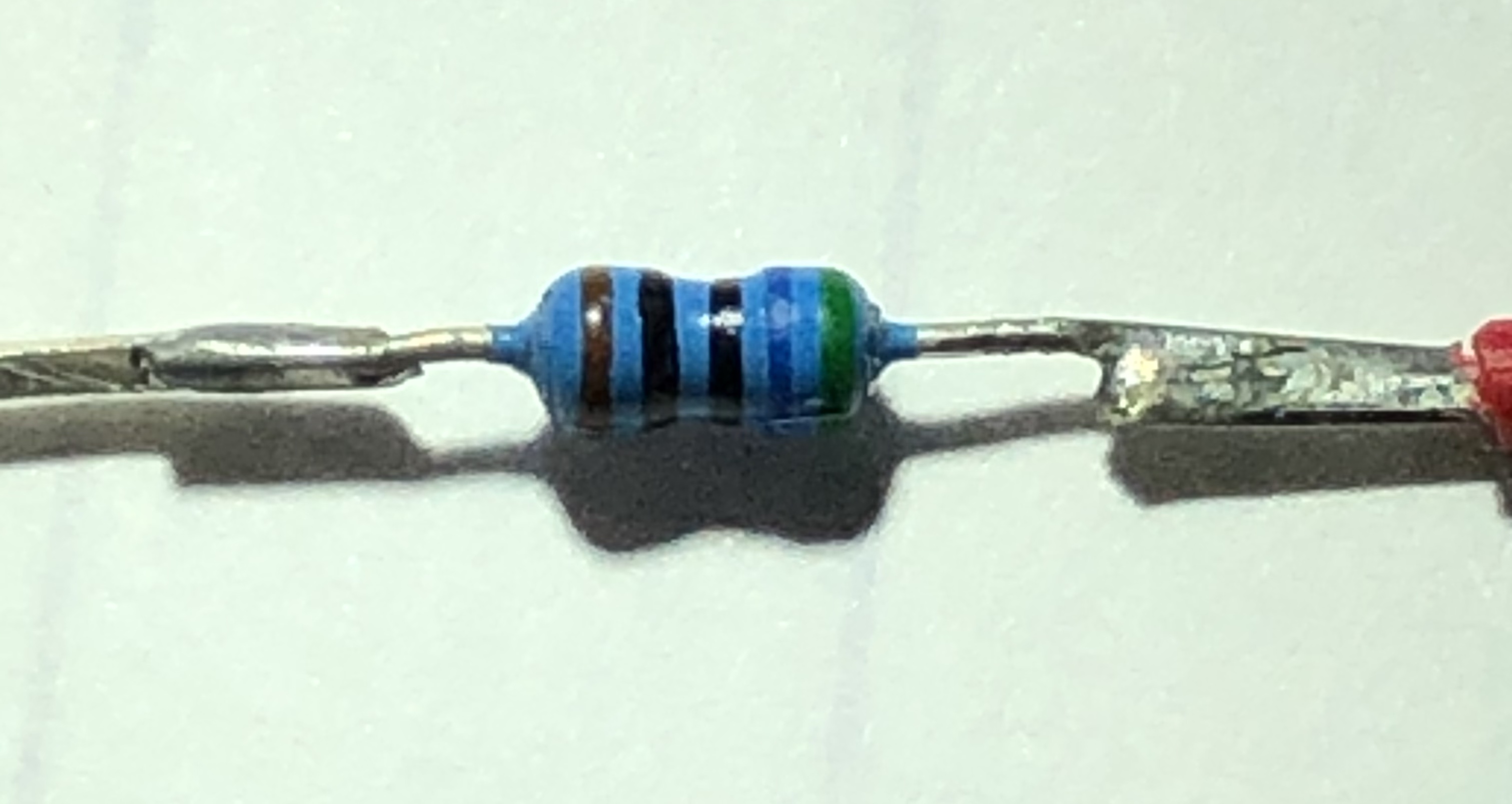

If I could pester you guy’s again, the new Multicomp Pro OVL-5523 have arrived so I’m looking to use the existing wires from the old led’s which have the Resistors on them.
So if you can excuse my ignorance could you please run your eyes over the diagram & details to let me know it will be ok.
So hopefully these will be a fair bit brighter!

These are the Ristors already attached
That connection looks fine. It's a 560 Ohm resistor so it'll give about 16 mA per LED
The circuit doesn't actually show which way round the LEDs are. The diagram assumes that the resistors ares soldered into the +ve leads.

Yes that’s correct the resistors are on the + side.
