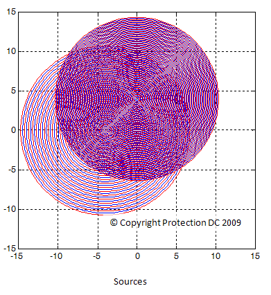

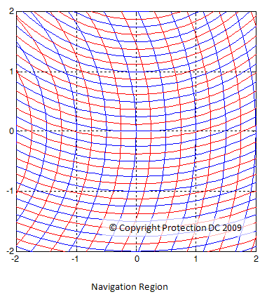

I have thought of calculating the phase difference with respect to each speaker at each location by measuring the time difference between the two microphones. By measuring the time difference, and knowing the speed of sound, you can calculate the distance between the 2 microphones with respect to the speaker and hence calculate the 'azimuth' angle. (similar to how humans localise sound)
However, I think this method might be great with one sound source, but having two different sources may be a bit of a problem I feel. The constructive and destructive interference pattern may deem it very difficult to do this.
So I'm thinking of maybe determining a grid pattern of constructive and destructive interference, based on the wavelengths of the 2 sources. (i've attached images that i generated on MATLAB of what i think this may look like). By detecting how many points of constructive/destructive interference you detect, you can calculate how far to travel. This too I think will be very difficult because I have no idea how to visualise the interference pattern, or whether the 2 sources will be in phase or the same amplitude etc.
What were you thinking? Any ideas at this point would be immensely appreciated! :)

How big is the robot operating field? Phase measurements would work if the frequencies are low enough that the high frequency would cover the distance of the field in one cycle. At 1200hz one wave covers about 0.8 feet before repeating. Beyond that distance the phase relationship repeats. This approach may require a precision clock--to the microsecond--shared by robot and beacon.

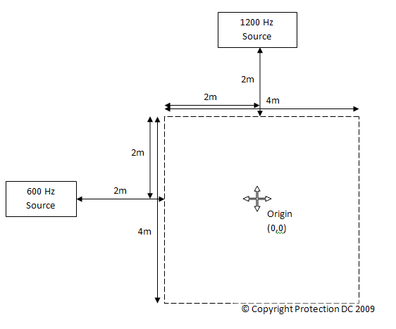

The robot's operating field is a 4m x 4m square. I've attached a diagram (not to exact scale) of the positions of the speaker with respect to the operating area. The robot will begin at the known position, the 'origin'. We have been told that this will be exactly in the middle of the operating area, and that the robot will initially be directly facing a speaker. The robot will have to calibrate itself to this known position. Waypoints will be provided on the testing day, and will be given as coordinates (in metres) with respect to the origin e.g. 1m upwards is (0,1).
I am just very confused as to whether I will in fact be able to calculate phase difference with all the constructive and destructive interference occuring in the region, since the sources are an 'octave' difference in frequency. Do you think by using very narrow bandpass filters that I will be able to differentiate between the two frequencies? I am just uncertain, for example, as to whether certain areas will be 'dead spots' due to destructive interference and nothing will be heard. Will the interference pattern due to the two sources be constantly changing? :confused:
Also, do you have any suggestions as to how I can measure distance? I have been told that using amplitude is not a good idea, I am not sure why... Perhaps I should just use timing of the motors and calculate with respect to the origin?

In general you should be able to measure overlay of the both signals in 2 points (2 mics) and locate your "exact" position on "plato" as well as your direction. you will have "same/similar" measurements in few spots on the "plato" but knowing where you are at the beginning of the "trip" you can calculate the correct path

Thanks very much for your idea! Sounds like a good plan. I have attached a diagram in a previous post of the robot operating area. We have been told that the speakers will be exactly orthogonally placed. The testing will be done in a large hall, so echoes (as well as my fellow classmates chatter :p) may be a problem.
Does your method use the timing between peaks detected by each microphone to calculate the angle with respect to each speaker/frequency source individually (like the figure i posted?)? I am a little confused as to whether the interference pattern created by the orthogonally placed speakers will make it difficult to detect peaks? Will filtering using narow bandpass filters be sufficient? I have not been given any information as to the dimensions of the tank, but I assume that it will be big enough to place the mic's as far apart as needed....

Your point-in-space calculations will require at least a Pythagorean theorem or trigonometric functions. So you need a micro controller or processor that can perform real number calculations. Consider some of the C+ systems that can be used in a microcontroller with appropriate function libraries. If a feedback control system is incorporated computing power needs to be considered
The operating area is large enough that “slippage” during track turns should provide little error to your location measurements.

I just wrote what seamed possible to me - mostly because 600Hz and 1200Hz are low enough to detect peaks and 1:2 and I do not believe that is "coincidence" ... 2 channel scope (one beam per channel is good idea :) - any DSO should do too) and a simple test should give you much more ideas then what I can come up in short time :) ...
the low frequencies do not lose energy that easily so on 4x4m "plato" I do not believe you can use amplitude for measuring distance. you need to analyze intersection of the data on those 2 points .. not easy for me to visualise attm and I do not have time to setup the test env to check the results using scope.

now, after writing this, I'm doubting it but check this out .. the wavelength of the 600Hz is ~0.56m and for 1200Hz it is ~0.28m so it actually makes sense, as the wavelength is so "big" you can use the difference in time between peaks to measure "angle". You can also use Doppler to measure your speed going towards the sound source.
