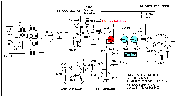

For an RF (100MHz) supply bypass cap, I use a 1000pF ceramic disc cap with very short wires. For an audio supply bypass cap for battery-powered circuits, I use a 100uF for pre-amps and 1000uF for power amps.
It seems that in some cases, the supply cap makes improvements, and in some cases, it does not. I'll have to experiment.
I still think the whole thing is crazy...
then talk to the individuals who make radios with an LCD built into them that displays the frequency.
Well, given that, I wonder how long it will take you to convince him to scrap this method
Sorry, I'm not scraping it until I find a method that works, and is easy to implement without using varicaps, or any special IC that isn't commonly available.
and wouldn't resistors mixed with capacitors adjust the frequency more?

Here is an FM transmitter project that uses common 2N4401 transistors as varactors. One is used to FM modulate the 100MHz carrier, and two in parallel are used to tune it with voltage from a pot. A Cmos counter IC can drive a resistor ladder to create the tuning voltage if you want.
