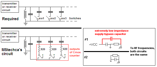

Here's my theory
My picture shows the way I look at it. (the pointing arrow represents the input to the receiver).
Let's use my receiver for an example.
The inductor is connected to ground. Whatever outputs are low will add capacitance to the capacitor in the LC circuit, and therefore make a decent band-pass filter. The remaining high outputs will help make a band-reject filter, because the capacitor and inductor are now in series.

No counter has output on-off switches. Transistors can be used as switches but their output capacitance might be equal to the capacitors you want to switch off.
The capacitor and inductor are never in series because the positive supply and ground are at the same RF potential. The capacitor is always connected in parallel with the coil.
We wish you would understand this.
I've been seeing this go on in so many threads, I feel I need to chime in too.
Audioguru is right. one of the first thing they teach you in dealing with AC signal analysis is that DC VOLTAGE SOURCES ARE AC GROUNDS! when you look at a circuit in terms of AC signals (like radio signals), VCC and ground are considered the same point, because VCC is a DC voltage, and has no AC content. so literally, take your little diagram, cross out VCC, and draw a ground symbol there, and maybe then you can see why the capacitor is in parallel with the inductor in both cases!
I hate to break the bad news to you, but I never learned AC circuitry in school, yet I am able to pull off several working circuits.
When you look at a circuit in terms of AC signals (like radio signals), VCC and ground are considered the same point, because VCC is a DC voltage, and has no AC content.

Don't connect VCC to ground in your circuit with a wire, connect them on paper and LOOK at it. The supply bypass cap does it at the RF frequency that has low power, and makes the tuning cap in parallel with the inductor so their small RF current can alternate between them.
To me, AC means alternating current. where the two rails consistantly change polarity.
Mains rails alternate the polarities of the voltage and current. But most electronic circuits use a single supply so their rails are a fixed DC voltage (without any signal) and ground. Oscillation in a single supply circuit is AC voltage and current that don't alternate polarities, they just increase and decrease in level.
The capacitor is useful for holding the voltage, and I think it is what is actually causing VCC and ground to be equal.
The supply bypass capacitor, correct. That's what it is for.

no, nigel's right, don't remove the supply bypass cap. I can see how you drew the conclusion, but it won't solve the problem, it will just create lots of new ones. you can't avoid treating a DC supply voltage as an RF ground, so instead you have to think of another method for switching your capacitors.
You mentioned that you wanted to avoid open-collector outputs (the ones that require pull-up resistors), however those are probably more suitable for your application... in audioguru's diagram, in the top half, where he has switches depicting the "ideal" setup, you can see that the capacitors would either be connected to ground, or open-circuited. an open-collector output is a pull-down transistor, that either pulls the output to ground or open-circuits it (thus the use of pull-up resistors normally), so it behaves the way you would want. This is a method that was used in a function generator project in EPE magazine, to select the frequency output range of the function generator IC, whose frequency was set with an RC pair. granted, that function generator wasn't designed to operate anywhere near to the hundreds of MHz range...
you will still have the problem of parasitic capacitance of the outputs when they are either on or off, and the non-zero output resistance, but if you're really determined to do this by switching caps with a logic circuit then you're kinda stuck with that and will have to tune your way around it.
You might not be able to find your desired logic chip with OC outputs, but you could always just use some NPN or NMOS discrete transistors (driven by inverted outputs if needed) on normal logic outputs to achieve the same thing.
I still think the whole thing is crazy, but at least this might be a step in the less-wrong direction :lol:
