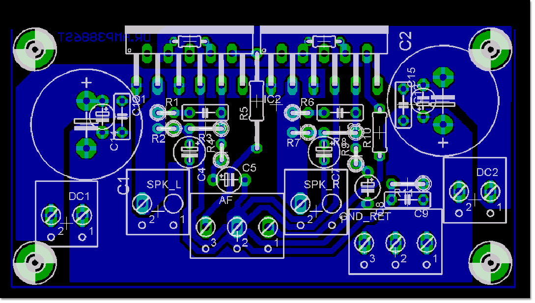

Okay, I followed Nigel's advice and bought a 25 by 25 volt 5 amp by 5 amp transformer, two LM3886'es and all the other necessary components for a stereo gainclone amp from this website **broken link removed**
But now there are two problems
1) At the bottom of the original website
**broken link removed** (turkish) It giver a parts list with some 0.6 Watt resistors, and I've only got 1/4 watt resistors
2) the layout
Has more resistors than the schematic
What should I do???
Is there any better website for a gainclone like this?

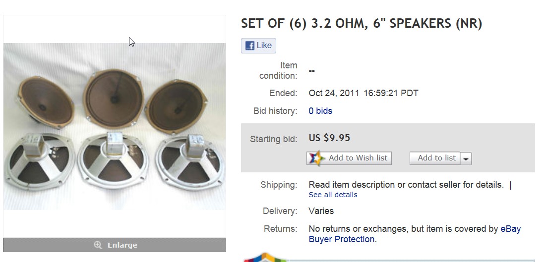

FYI: In 1980, I developed the TDA2003 at Farichild semiconductor which was a functional replacement of The SGS TDA2003. At that time it was industry standard for many car audio systems to use two 3.2 Ohm speakers in parallel on each channel to get maximum power in car audio systems that ran off 12V. The TDA2002 and later 2003 were products specifically designed to be used for this.
Just read the data sheet.

I've never seen, or heard of, any car radio using two 3.2 ohm speakers
Well, now you have.
"A speaker is a speaker, no mono or stereo. Mono uses one or several on one channel of stereo or monaural broadcast. Single speaker is mono. Two or more may be stereo.
Speakers of this era used 3.2 ohm voice coils"
http://www.aqcollection.com/antique-radio/article-1724.html
There were also a lot of them around in the 70's. One front, one rear on each channel with a F/R fader control.

Well, now you have.
3 ohm speakers were commonly used in the valve era, it's pretty ludicrous to mark them as 3.2 or 3.4 ohms, as the speaker impedance varies greatly with frequency, the value is only a nominal one.
And were 4 ohm, not 3.2 - unless the USA for some strange reason was different to the rest of the world?.
I've also never seen a car stereo with paralleled speakers, perhaps this was anpother perculiar American thing?.
