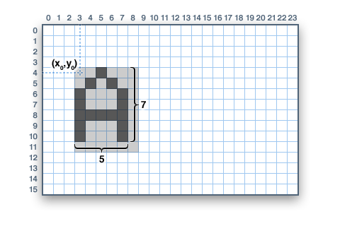

The set sizes are effectively just a single fixed font, and simply doubled up each time there's an increase in text size - hence their low quality as they get larger. Basically it's a simple solution, and economical on memory and program space - if you try and store larger fonts, or different fonts for each size, you soon start reaching memory limitations.

Looking at drawchar() it either puts a pixel or fills a square, so it doesn't look like you get in betweenies… It doubles the size so 1 pixel or 2x2 (4) pixels or 3x3 (9) pixels etc...
The font is 5x7 so you could get the 3 x 7 font from the KS0108 and rotate it to suit... ( but the font is a bit poo... )
