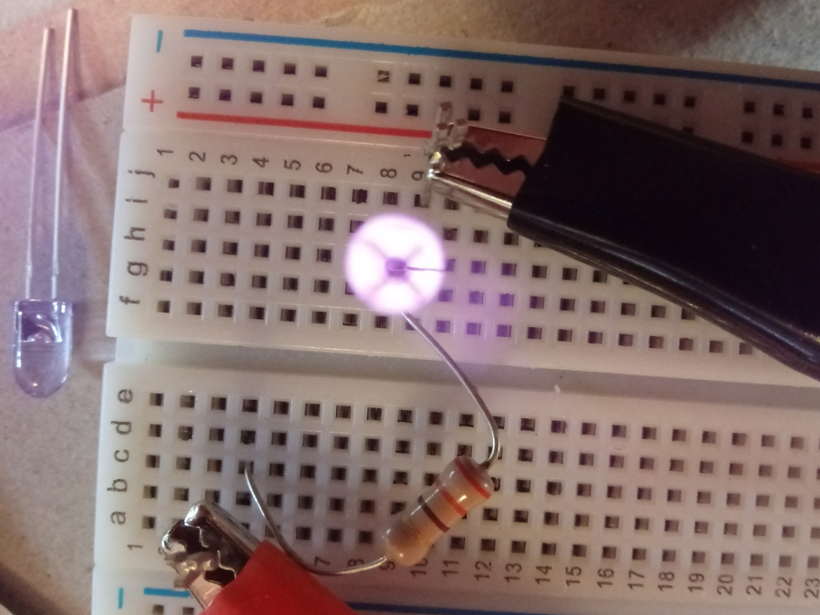

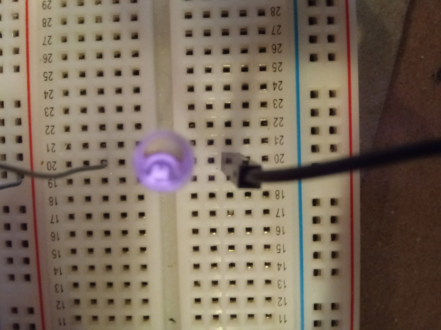

I was testing some IR LEDs the other day and used my digital camera to "see" whether they were working. To the normal naked eye, of course, one can't tell the difference.
Not working:
120170
Working:
Cameras come in many different types. Some have IR filters to block IR.
Some cameras have Red, Green, Blue & IR sensors. four types of sensors.
There will be different effects depending on what camera you use.

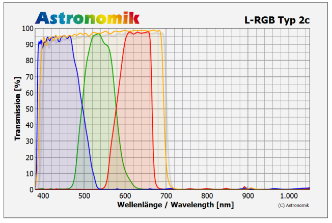

The other thing I would be interested in testing using an IR LED is how well commercial IR filters work. I don't have one though. Edit to add - those filters are designed to block visible light, not IR. You should still "see" a nice difference with the IR LED pic in "normal" lighting.

With regard to the few different cameras that I tested, the hue of the IR was different - light blue to violet.

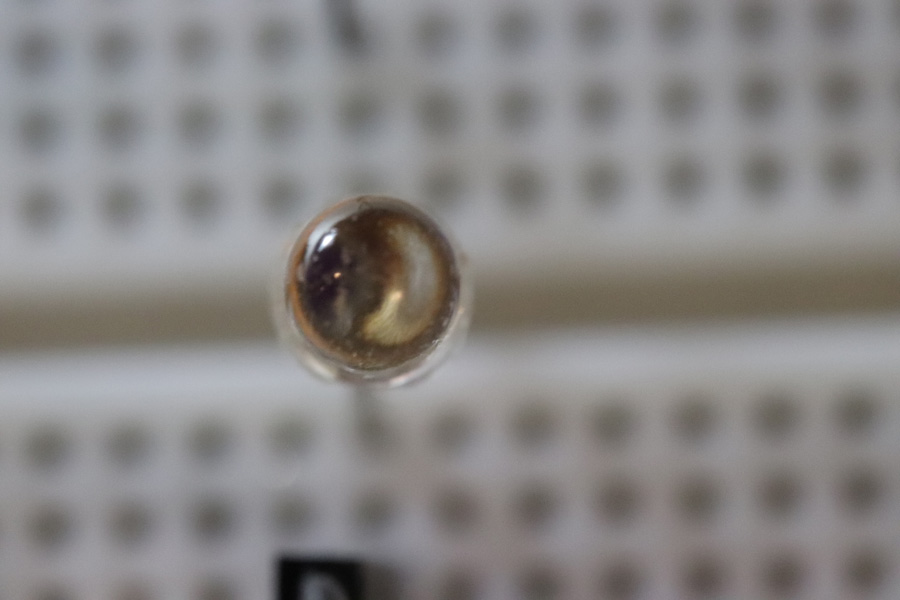

I Lied!! My SL2 does not pick up the lit IR LED! Tried a couple of lenses. I wonder if I was thinking about the old digital rebel - hmm dunno.

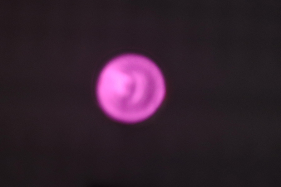

Well that sounds like an IR filter that blocks visible light...and it is on a switch or menu function? What camera is that may I ask? [and *dam* you, now I have to look at what the "night" scene setting does!
Edit: well don't dat just beat all!
120177
In night scene it picks up the IR. Cool. Of course, I have never used any of those auto scenes. In fact, there is so much on this camera that even though I have had it for a good 4 months, I am not sure I have even touched the surface.
It's interesting, it doesn't want to auto-focus my EFS 60mm lens, which may make sense if it is blocking visible light...it has nothing to focus on...it also does multiple shots for HDR. Cool stuff, thanks for bringing it up (I un-dam you :)).

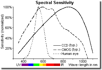

In a camera all the sensors are the same but they have different filters. From this picture some sensors have a blue filter, or green filter, or a red filter. In this case there is a IR blocking filter because "hot objects" should not look different to the camera than to your eye. (yellow line is the visible light filter or IR block filter)
120180
I have used CMOS & CCD cameras. As you can see they respond well to IR light.
120181
I have some cameras with 4 not 3 sensors/pixel. In day mode they use the R, G, and B sensors. In night mode they use the 4th sensor with no filter. The 4th sensor pulls in much more visible light and responds very well if there is a IR source.
There are some cameras, to save money, that do not have a IR blocking filter. In night mode they just use the red sensors that extend out to 1000nM. (wave lenght)
