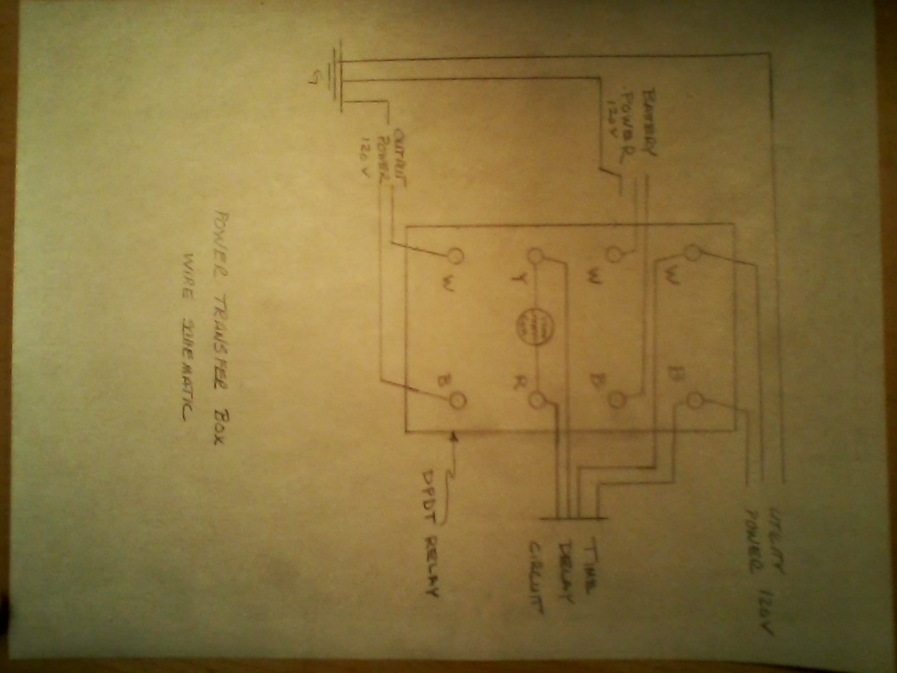

Hoping to repair my sump pump, power transfer switch. Switch detects power from battery backup but not from wall outlet . Relay switch is an 8 screw, DPDT open connector type. This is no longer in production and manufacturer offers no support.
It appears there is one of two possible sources for the problem. Either the relay is bad or the timer delay circuit board is bad, see photo.
With both power plugs connected, The switch only picks up power from the battery side. If I push the switch down with a stick to the opposite poles, the test light goes out. I release the stick and the light comes back on. I would expect the light to go on from either side of the relay switch.
I removed the timer delay and found no change to the problem so I believe it is a bad relay switch.
Is that a valid test or is there another way to check the relay ?
Not sure how to check the circuit board.

Less a schematic I will venture a guess, Your relay has, as you mentioned, eight terminals. Since that is a DPDT relay that makes sense. Looking at your image the relay has what look like two levers which are the Common contacts. When the relay is active those levers are pulled down so the Common to Normally Open on each side closes. Using 120 VAC mains the simple way to transfer is allow the mains to hold in the relay (active) by applying 120 VAC to the relay coil. When mains power is lost the relay will open, the coil is DeEnergized. My guess here is that when mains power is available the relay should be energized, when mains power is lost the relay drops out and the Normally Closed contacts close. Those would be the upper contacts on the top of your image, So the lever looking pieces travel between a NO and NC on each side of the relay. Relays used like this are continuous duty meaning they are designed to be on all the time. If you measure across the coil my guess is that you should see mains voltage and if you have coil voltage and those contacts are not pulled down there is a good possibility the relay coil has failed. There really isn't much to a relay like this.
The only trick is to be sure the relay coil has failed and knowing what the coil voltage actually is. That makes for easy replacement along with knowing what the relay contacts are rated for as to switching current. The older open contact relays have slowly gone away but there are replacements which are simple to replace. Just a matter of determining that the relay is in fact bad. Do you have a meter and know how to use it?
That would make sense but I have no idea what the test light is all about at this point. Does the pump motor have a data plate listing pump voltage and current?

I checked the voltage across the coil contacts and it was 120V
Here is my wiring diagram.
