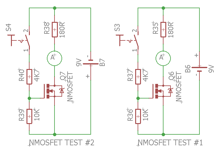

OK, I will draw up a test circuit.
NMOSFET TEST 1.1: The ammeter shall indicate 0mA.
NMOSFET TEST 1.2: Close the switch. The ammeter shall indicate 50mA.
NMOSFET TEST 2: The ammeter shall indicate -50mA.
What was the purpose of test 2? With the switch open your just testing the diode, was that your intent? Just wondering if I'm missing something as test 1. seems adequate.
Yes that is correct.

I have tried tomizett's tests on the MOSFET and it passed. I have tried spec's tests on the MOSFET and it passed. Well 20mA anyway, but it was the same oldish 9V battery.
