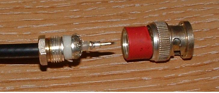

One question BNC with PS gland - pressure sleeve gland ?
Yes, the white squidgy bit in the picture.
Need crimping or screw in ??
No crimping required.
The centre pin is soldered.
The body and the back nut screw together, squeezing the pressure sleeve, and holding the screen braid in contact with the inside of the body.
FWIW: Where I used to work we bought supposedly high quality crimped cables from newark.com. They may have even been Pomona, but may had issues over the years where the crimps would "let go". I went through a period of re-making a lot of the cables.
The process of making a BNC cable end is exacting. The strip lenghts have to be "right on" and you need a "thin wrench". Fortunately, I had access to resistance soldering equipment, so you don't get solder on the gold pin. The solder cup of the pin has to be flush with the insulator.
The other method is a "HEX crimp which i never used.
