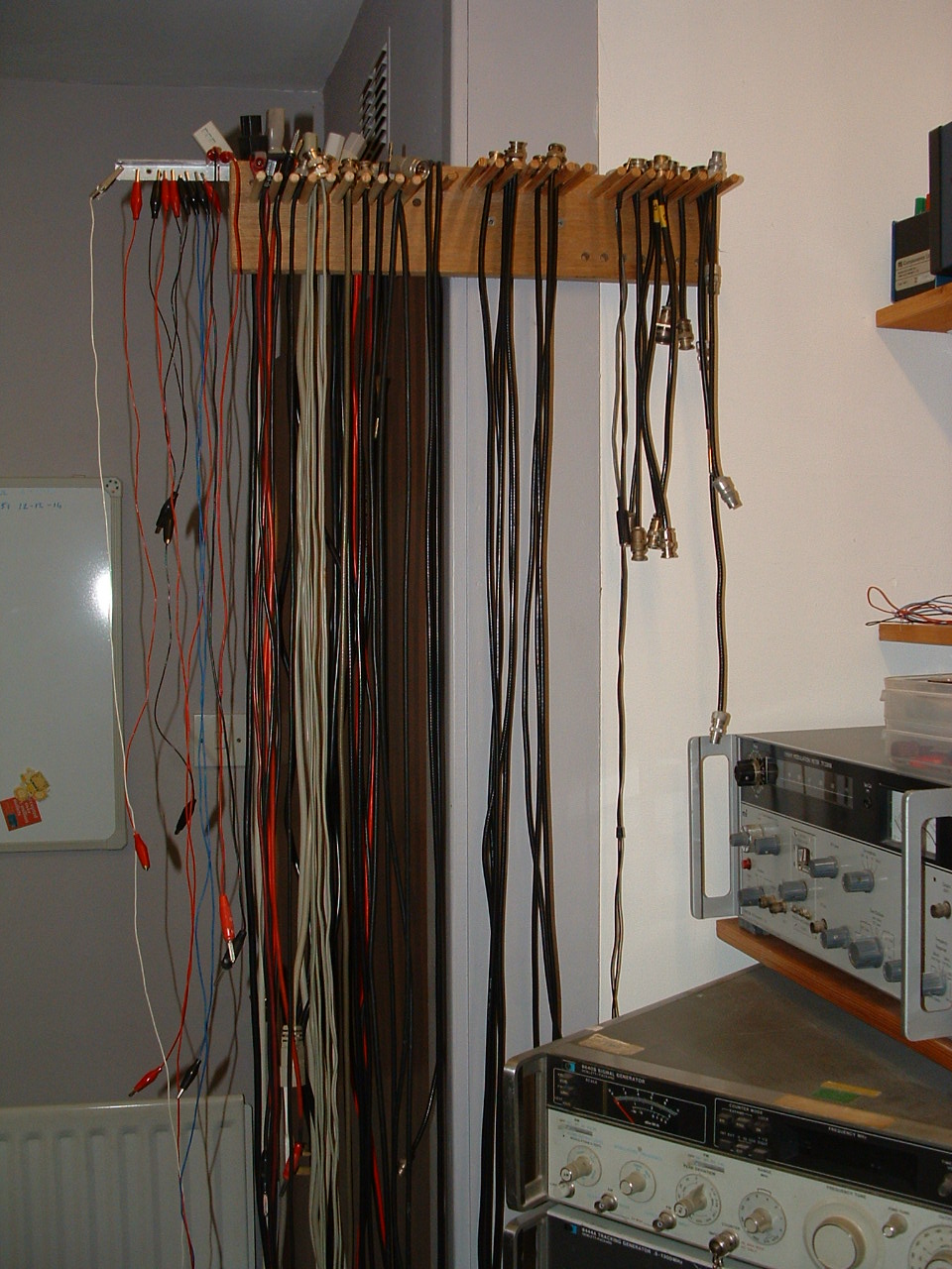

Here is my rack of test leads, BNC to BNC, N to BNC, PL259 to BNC, BNC to Crocs, IEC Mains Leads and a few real oddballs.

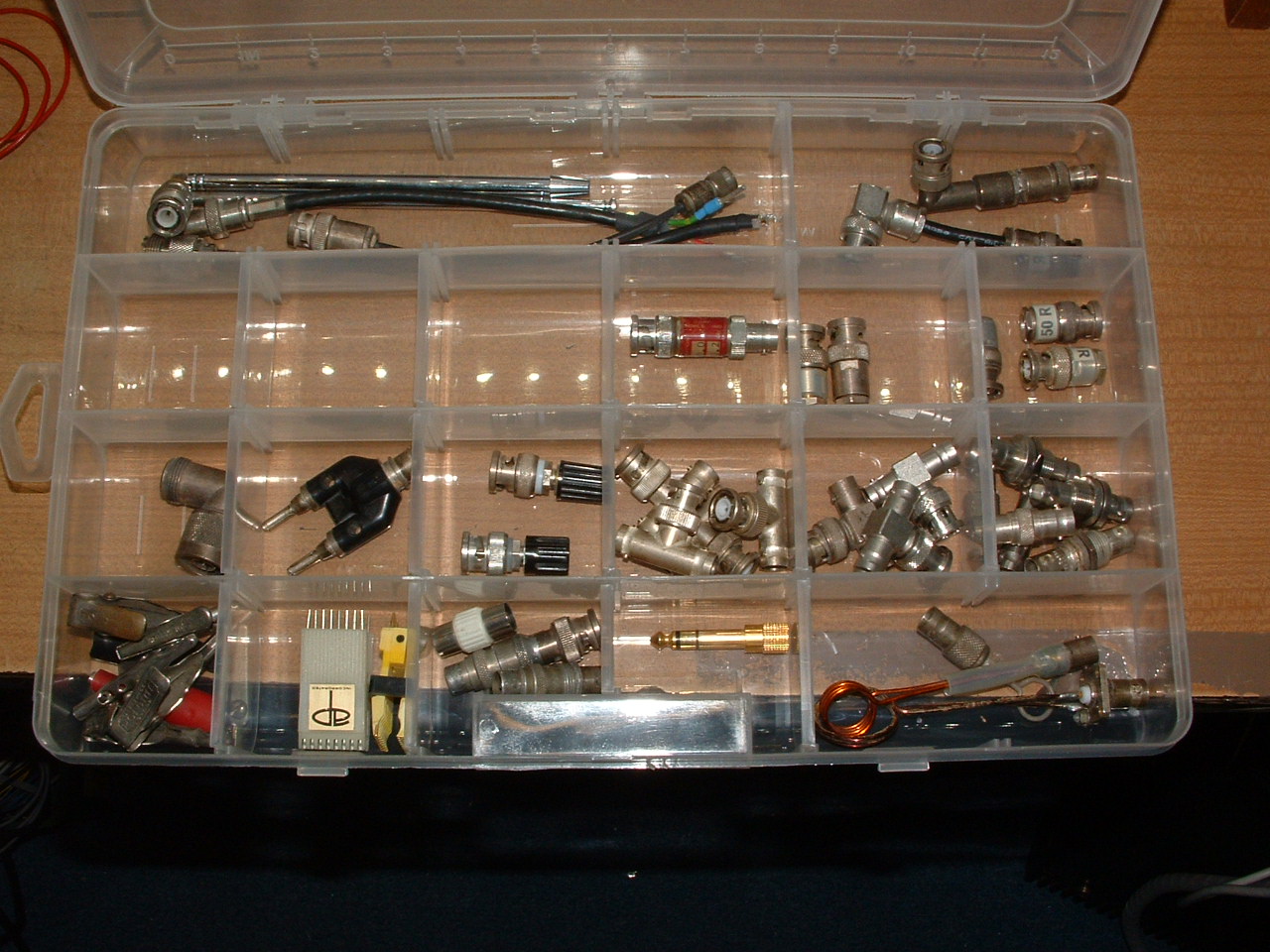

A box of assorted inter-series adaptors an connectors and oddballs.

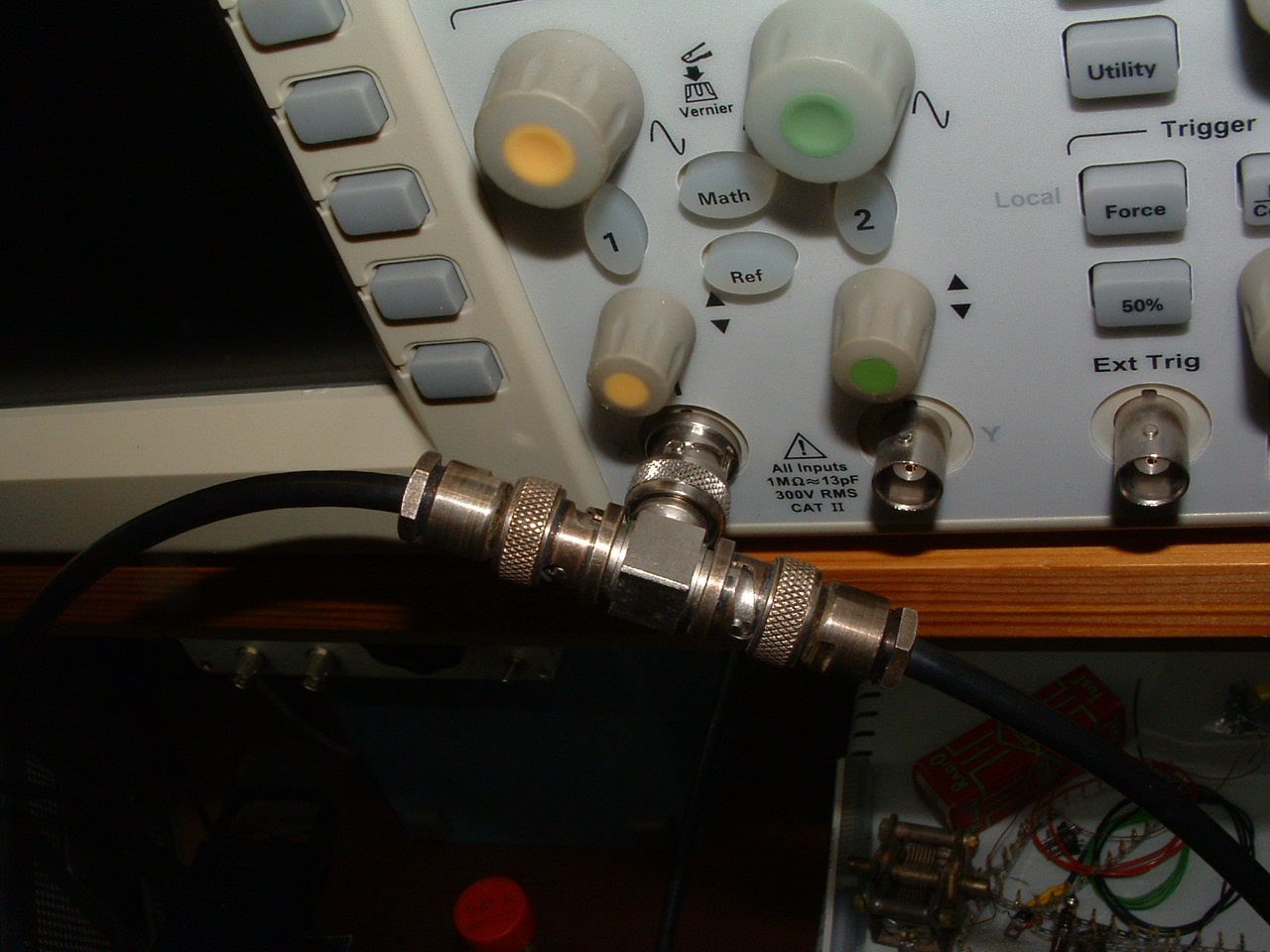

A couple of BNC Tee Pieces is useful for when you want to connect two bits of equipment to the same point.

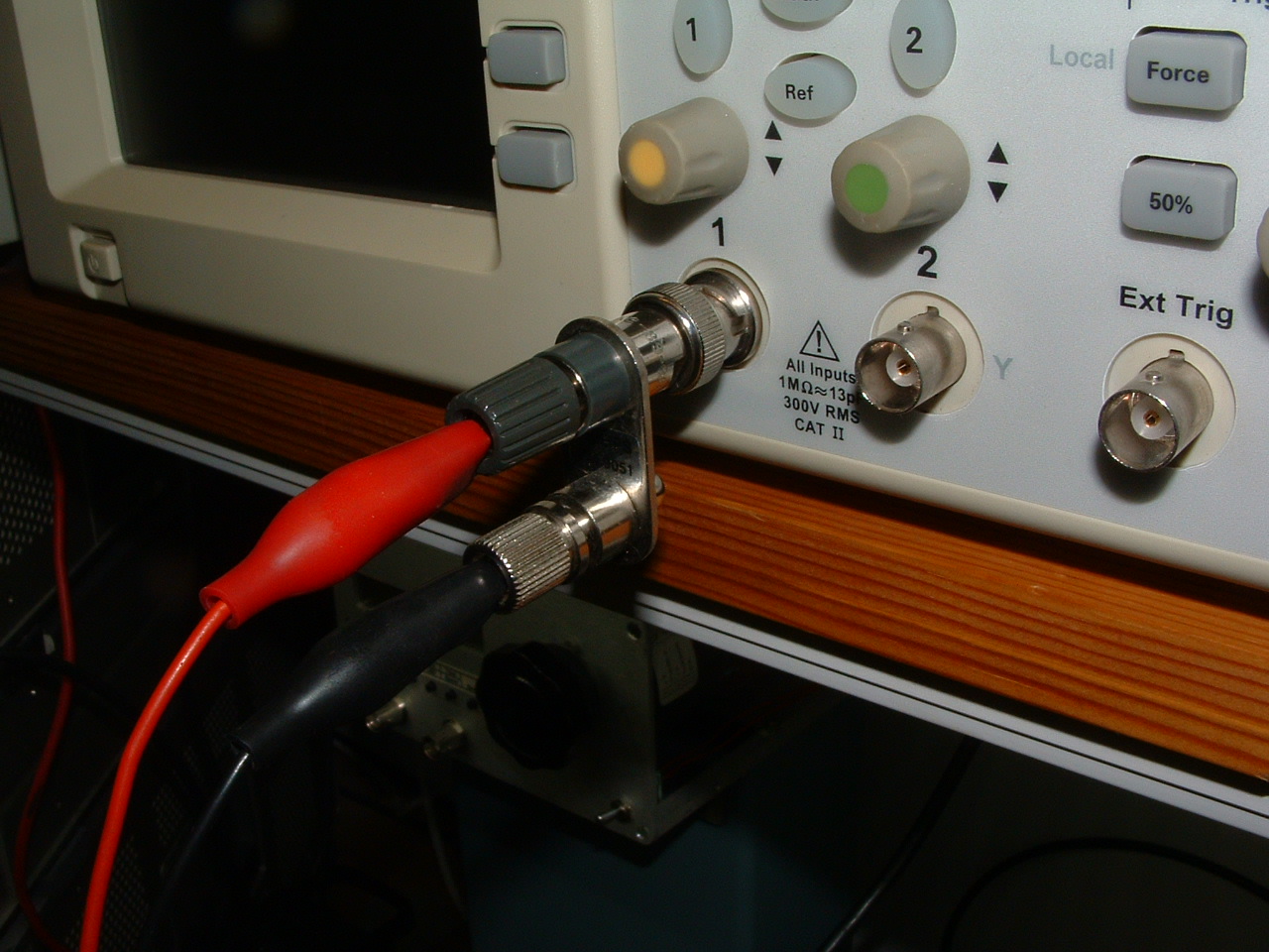

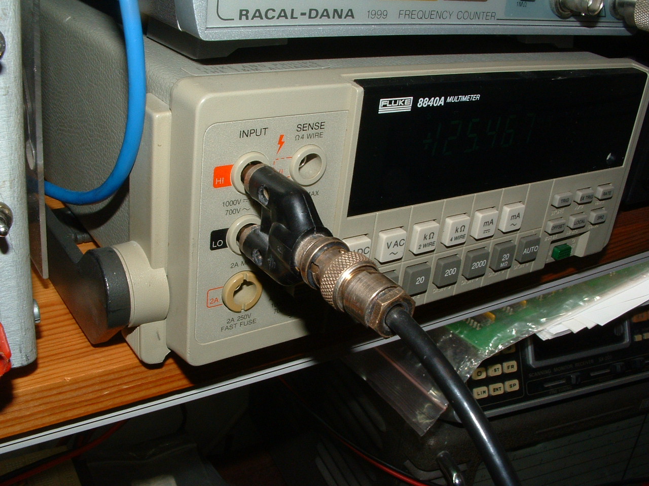

Not all signals arrive on a BNC terminated coax cable, so some BNC to 4mm plugs and sockets is useful.
BNC to single 4mm Terminal.jpg BNC to 4mm Plugs.jpg BNC to two 4mm Terminals.jpg

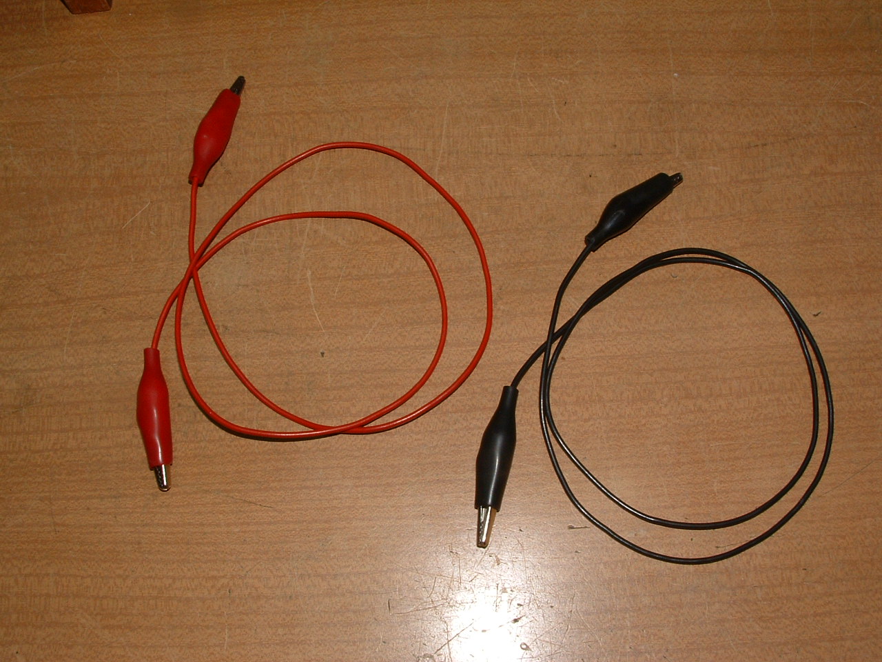

And last but not least, ALWAYS usefull, some Croc Leads made with single wire rather than coax/screened cable.
Use them for power (low volts DC), signal connections where screening is not important, little friggs and jumpers where a temporary connection is required to make something work.

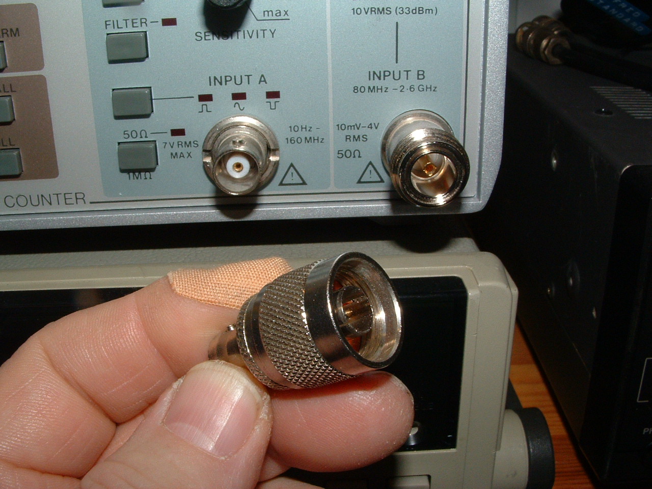

N & PL259 need some research, I don't know what they are yet.
Both are pretty rare, not something you're likely to need to concern yourself with :D
PL259 were used for CB and Amateur radio's, and for a few VERY, VERY old VCR's - apart from that it's mainly professional use.
I don't have a single PL259 lead or plug in the service department I run, and I've NEVER had an N type plug or lead (although I do know what they are).
Unless you are into radio, you do not need those connectors, I was just describing what is in my box of bits.

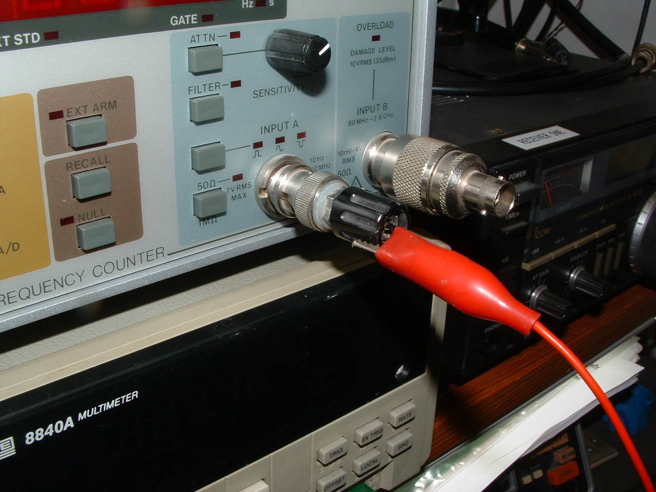

Here on the front of my frequency counter are two inputs,
Input A for 5Hz to 160MHz and Input B for 80MHz to 2.6GHz.
For ease of day to day use, I normally have an N to BNC adapter on the B input.
