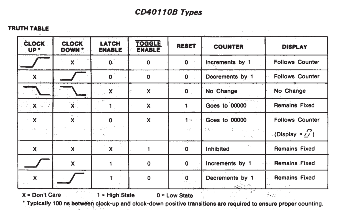

I am building an up / down counter with a 7 segment led display, and would like outputs from 0 to 9. I am using 12 power supply and a cd40110b chip. I am not having any success getting this chip to count. I am connecting the up terminal 9 to ground through a 100k resistor & the same with down terminal 7. Applying +12 to pin 7 or 9 does nothing. Any help is great
Check all inputs against Truth Table
If it fails these rules of Logic, and Voltages are correct, then the chip is probably blown from ESD .
