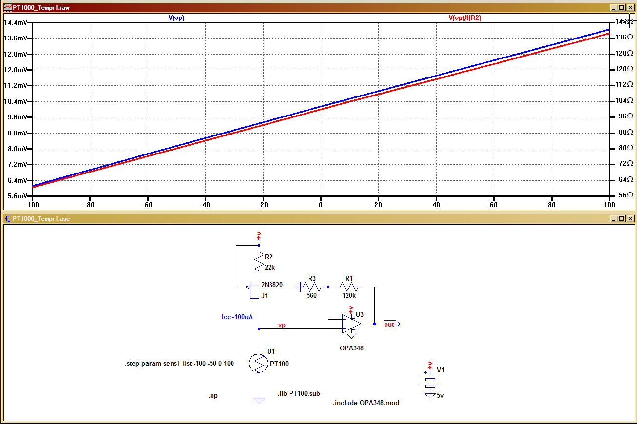

hi adrian,
You could use a low value constant current source to drive the PT1000 and so develop a voltage across it.
Amplify the voltage using a OPA or if preferred use a LM393 comparator.
OK.
EDIT:
This is a previous example using the PT100,, a PT1000 would be similar
Hi ericgibbs. Thanks for your reply. Can you explain to me what is a 'low value constant current source' please ??
Is there a way to increase the output voltage gap using a voltage divider??
Platinum sensors are accurate but have a very small change of resistance with temperature. There is no way to increase the voltage change due to this resistance change other than using a stable amplifier.
Other sensors, such as IC based sensors, or thermistors can generate a higher voltage change with temperature.
The JFET is configured to supply a constant current of approx 100uA thru the PT1000.
The only way to increase the low level signal from the PT1000 is by using a operational amplifier.
The OPA will be also be configured to remove the offset voltage across the PT1000.
Do you follow.?

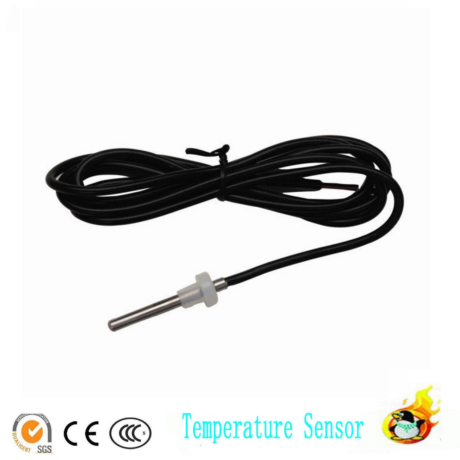

Can i submerge the PT1000 probe (not with the wire) in water which will rise to 100°C ?? or do i have to buy a cover for it ?
Thanks for the reply.
You haven't mentioned the probe model? If the probe has a stainless steel or inconel sheath then yes. Other sheath materials would also work so it all depends on sheath material.
Ron
Ok thanks.
The probe is like the one in the picture below, which im assuming has a stainless steel probe.
  • PT1000-Sensor-Dia-6mm-for-Solar-Hot-Water-Temperature-Sensation-sensor-solar-water-heater-parts.jpg
Immersion at the temperatures you mention should be no problem at all.
Ron
