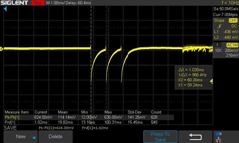

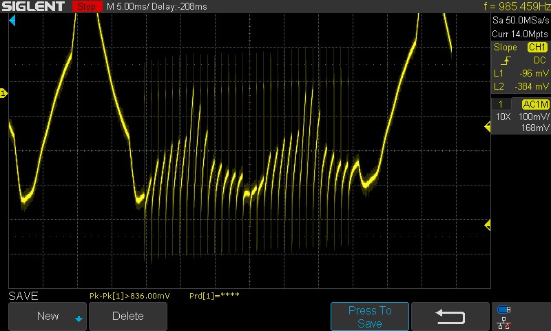

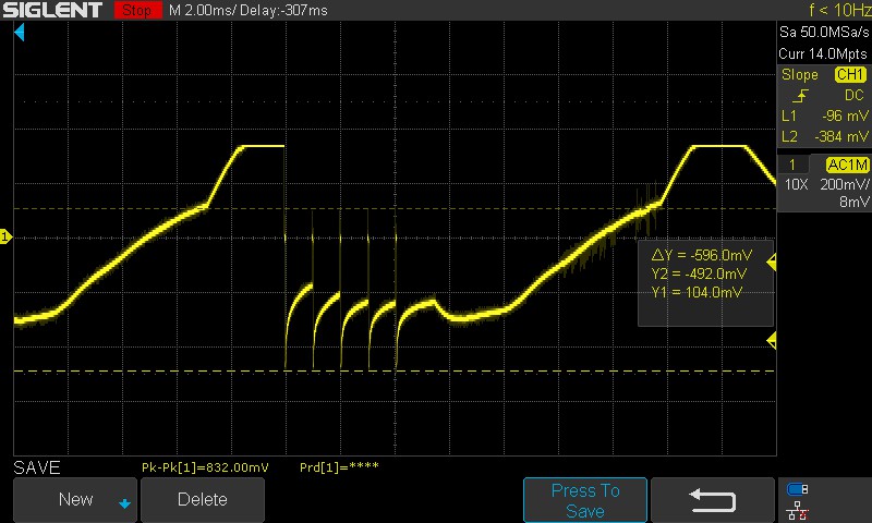

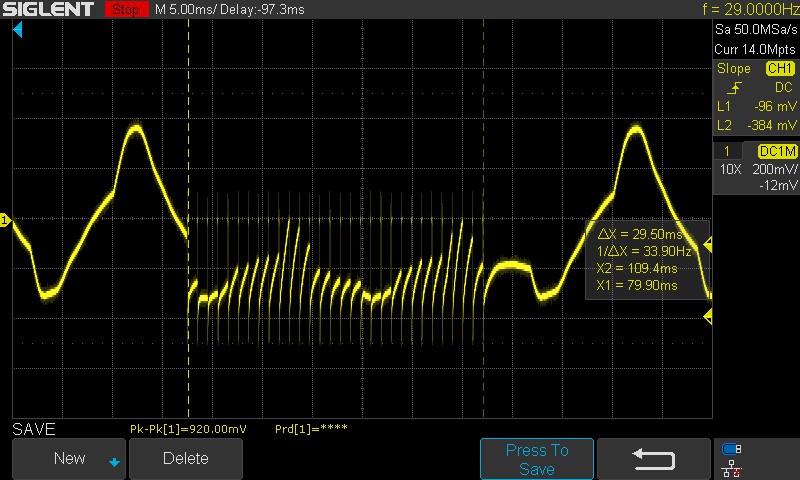

I have a device that is outputting the signal seen in the attached files. This signal comes from a two conductor 1/8" phono jack, and is normally sent to another device which controls a stepper motor. This signal is a number of pulses directly representing the number of steps for the motor to move. My goal is to bypass this device and produce this signal programmatically from a computer. Ideally there would be a small device external to the computer, connected to it via USB. The device would probably appear as a com port. It would have four to eight 2 conductor 1/8" phono jacks and I could simply send a number representing the port, and the number of pulses to the device from my program, and the pulses would be sent. I don't know what sort of signal this is. Is it AC current with the signal superimposed ? It all looks the same with the scope in AC or DC mode. I don't know if the 60 Hz background signal is because it is AC, or if it is hum leaking in. I read the pulses as being 1 millisecond apart. I have no idea how I could create such a signal unless I could do it as an audio signal. Theoretically I could record this signal as audio. I could record 100 versions, one for each possible number, and then selectively play them to produce the signal. But I don't have any idea if this is anything like an audio signal, or if audio would reproduce it. Perhaps there is an existing device that does what I need.

Stepper motors normally require two signals - step and direction. Your signal looks more complex than a simple step signal.
An arduino will appear as a com port and can easily do what you want if you can work out how to send step and direction signals.
I'm assuming that the steppers go in both directions.

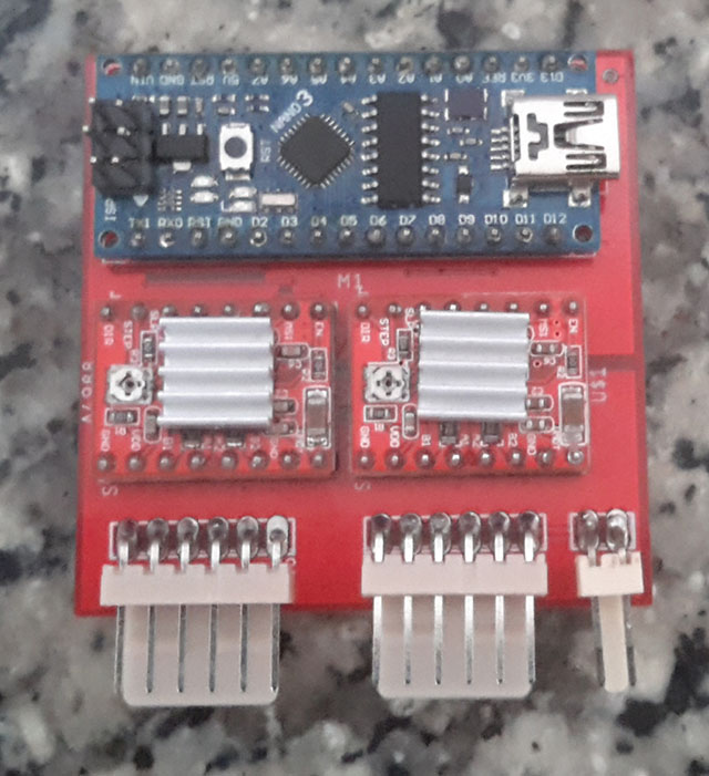

This is a simple carrier board I made for a project,
It consists of a Arduino Nano and two stepper motor boards. It can probably do what you need but driving the steppers directly.
BTW, the stepper modules are much cheaper on ebay.

I think the 60 HZ signal is induced hum. I removed the time machine from the time lapse go kit. Now it was connected only to the oscilloscope. The signal was still there. I disconnected the plug from the time machine. Now there was only the oscilloscope probe and a wire connected to the scope. The signal was still there. Then I found if I moved the time machine close to the transformers the signal became about four times as strong. Moved as far away as I could still connected to the scope and, the signal was much weaker, but still there. It is not a clean electrical environment. I am sitting on a steel/concrete floor. there is overhead florescent lighting, and a closet a few feet away contains a large AC unit. I pulled the 120V plug on the go kit, depriving power from four transformers. the signal was still there, but now it was a clean sine wave. Now my current assumption is that the signal I want is a DC circuit with the power suddenly dropping to ground for each observed pulse. Can anyone confirm this ? Meanwhile i started reading about the Nano, and Arduino programming. I think I will have to study for a long time to figure out how to duplicate this signal. But it does look interesting.

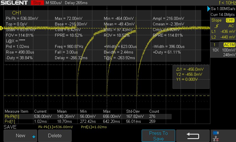

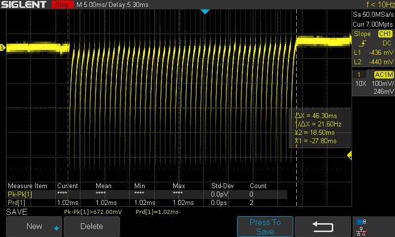

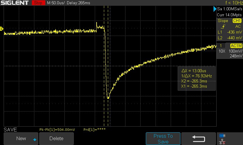

So primarily, I need someone to tell me what sort of signal this is. Obviously it is some sort of pulses. They are 1ms apart. The code is simple. If I set the Time Machine to 44 steps per frame, the signal will have 44 pulses. Although I am not new to electronics, I have little experience with circuit level work. I have never seen a signal like this. How can it go straight down, and never up ? Is this an incredibly short square wave ? Perhaps I will understand if someone knows a catch word or phrase for this sort of pulse. Or perhaps someone could explain how this signal could be created mechanically.

I've been looking at the waveforms you show in post 1. The voltages look very low for any kind of reasonable motor control signals.
Can you please post either a schematic of the circuit and the points that you have the scope connected to marked? If you don't have a schematic, then a good resolution picture(s), again with the scope connection points marked, would help.
I don't know if the company who made the Time Machine will be willing to give out a schematic. The Time Machine has a 2 conductor mini-phono jack. For these tests I had a half cable, a two conductor cable with a 2 conductor plug, plugged into the jack. I had the leads connected to the two wires coming from the plug and jack. I plan to do the test again in a cleaner environment. This time I will connect directly to a bare plug so a cable will not contribute noise. I will take a picture to show you.

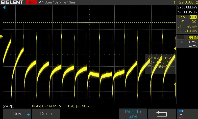

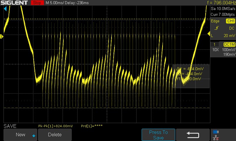

New Pictures ! This time I put the Time Machine and oscilloscope on a wooden table. There is almost no interference, no 60HZ signal as before. The time machine is running on a 9V. battery. This signal is of course a"3". I can never get the trigger to lock on these pulses, freezing the picture there. I checked this signal with a multimeter and could see nothing in any mode. In AC mode the signal looks more or less the same. the fourth picture is a "45". I have more pictures if it would help. note that this mystery signal does work. It talks to a Motion Controller that moves a rotary table. I'll follow up in a bit with a picture of the connections and setup.

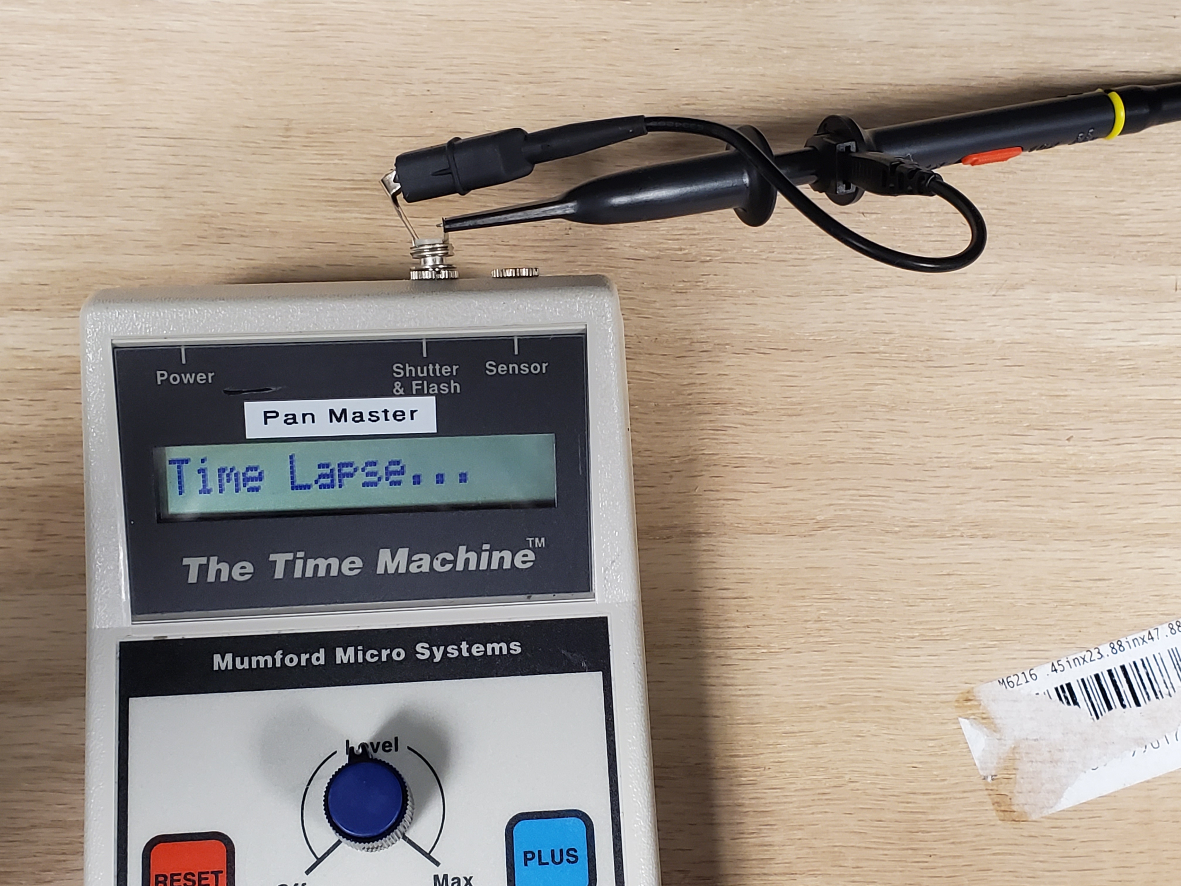

Here's a picture showing the probe connection to the Time Machine. The probe is connected to the leads from a plug that is plugged into the ramped pan jack which is normally connected to the Motion Controller. I hope this picture is not too large.
