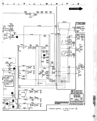

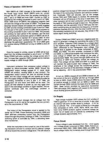

I have attached a copy of the smps circuit
I have checked all electro capacitors, both for C and ESR and have replaced any that seemed to be marginal. I have also checked most resistors in the switching circuit as well as diodes and semiconductors.
When I supply 45V to the switching circuit (this simulates the pre-regulator output and also gets rid of a mains connection) the current starts at about 1.4A and rises to 2A over a period of about 1 minute. The two TIP31 switches get hot. The waveforms are generally what you would expect as per the handbook but the switch is switching at approximately 125KHz instead of 20KHz. Output volts from the output transformer are about 30% low.

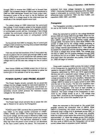

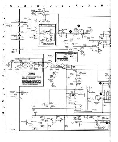

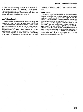

Hello Miguel/Sarma
My last attachment was poor quality. New attachments are better.
Sarma, the 45V is introduced across TP940 & TP950
Miguel, I have checked or replaced the components you listed and also checked the loads per your info. all are within the values.
I have removed all CRO circuit loads from the main transformer,T948, and replaced them with resistors across the output windings to simulate the loads but the switch still runs at approx. 120KHz. I seem to only have the transformers left to replace.
regards..Peter

Hi Les, Sarma, Miguel,
Les, I note your comments and will use your approach when I look at the pre-regulator. My problem is in the switching circuit which covers Q938, 939, 944, 947 & 948.
I connect 45V across C940 (TP940, TP950) and although the switcher does oscillate it is operating at about 120KHz instead of 20KHz and does not give required volts out of T948. All active devices have been replaced, all capacitors have been replaced, all resistors have been checked. The loads on all secondaries of the transformer T948 have been disconnected and checked against the figures provided by Miguel. I have removed all diodes from the transformer secondary and loaded the windings with suitable resistors. Switch still runs at 120KHZ. the circuit draws 2A from the 45v supply and Q946/947 overheat. I seem to be left with the transformers T944 and T948. T944 would seem to be a possibility because it is supposed to control the switch frequency. I removed this transformer, checked it for shorted turns etc but cannot fault it. Have also checked T948 as best I can (very difficult to remove from board so did not try) and could not fault it either. Help!!!!
