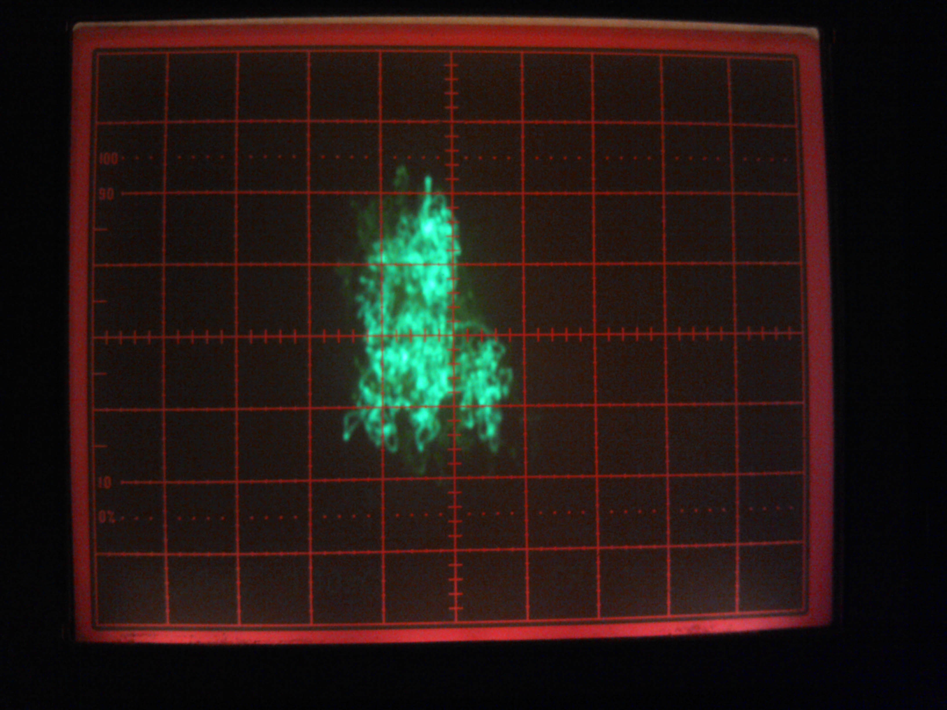

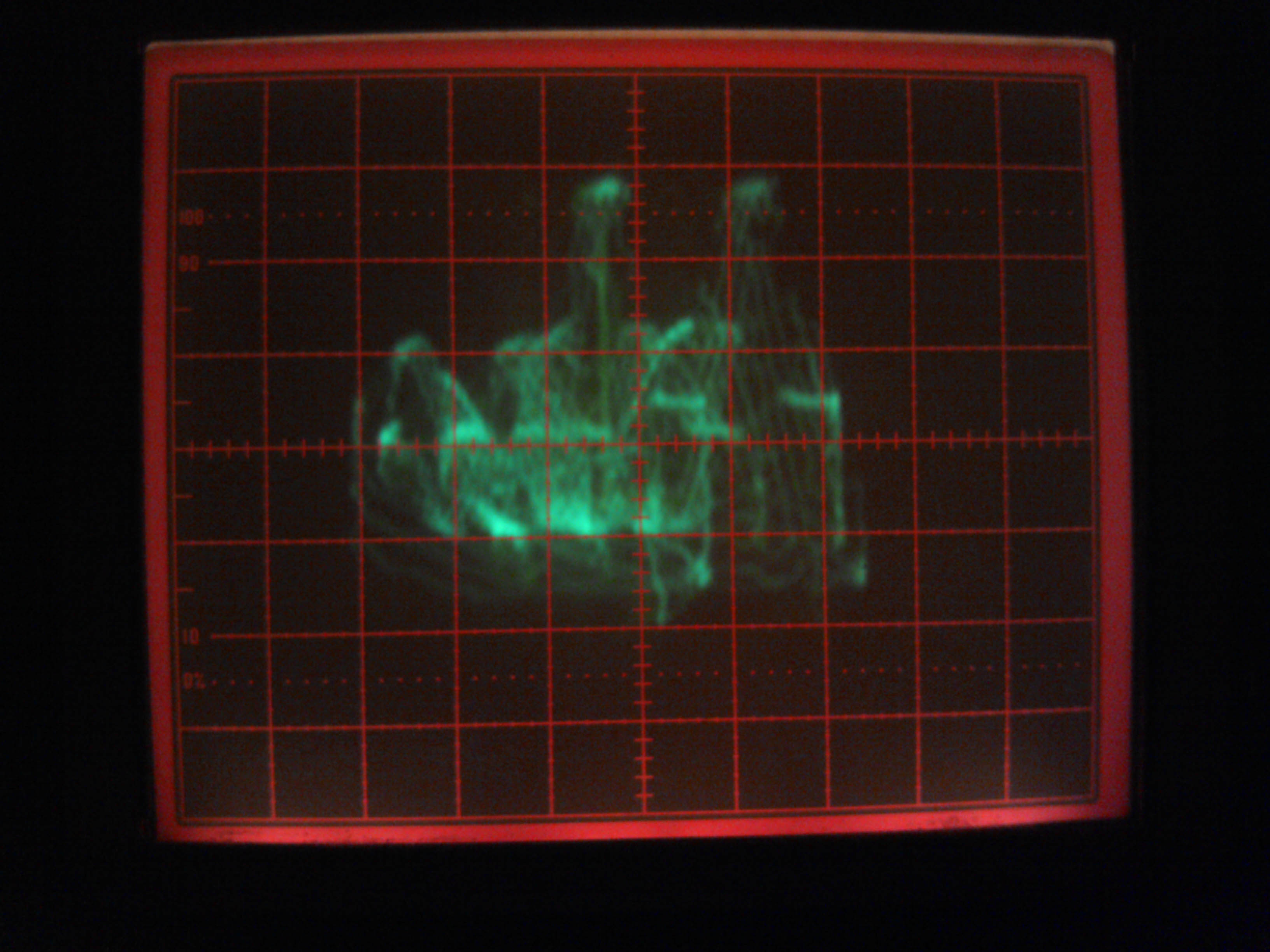

Tek 2445A - graticule illumination not working; modify it?
Hi all :)
I have a beautiful Tek 2445A which has just had the famous bad PSU caps replaced, and it was given to me FREE with two "p6137" 10x probes + the full service manual, bound and original (it came from a TV station) - beautiful 'scope! Does anyone know a good source for a new, working graticule illumination board, or do you think it could be modded to allow LED illumination instead, which seems more sensible? I saw somewhere that the board which drives the graticule lamps is very sensitive, and could be blown by not having the exact lamps... any ideas?
many thanks :)

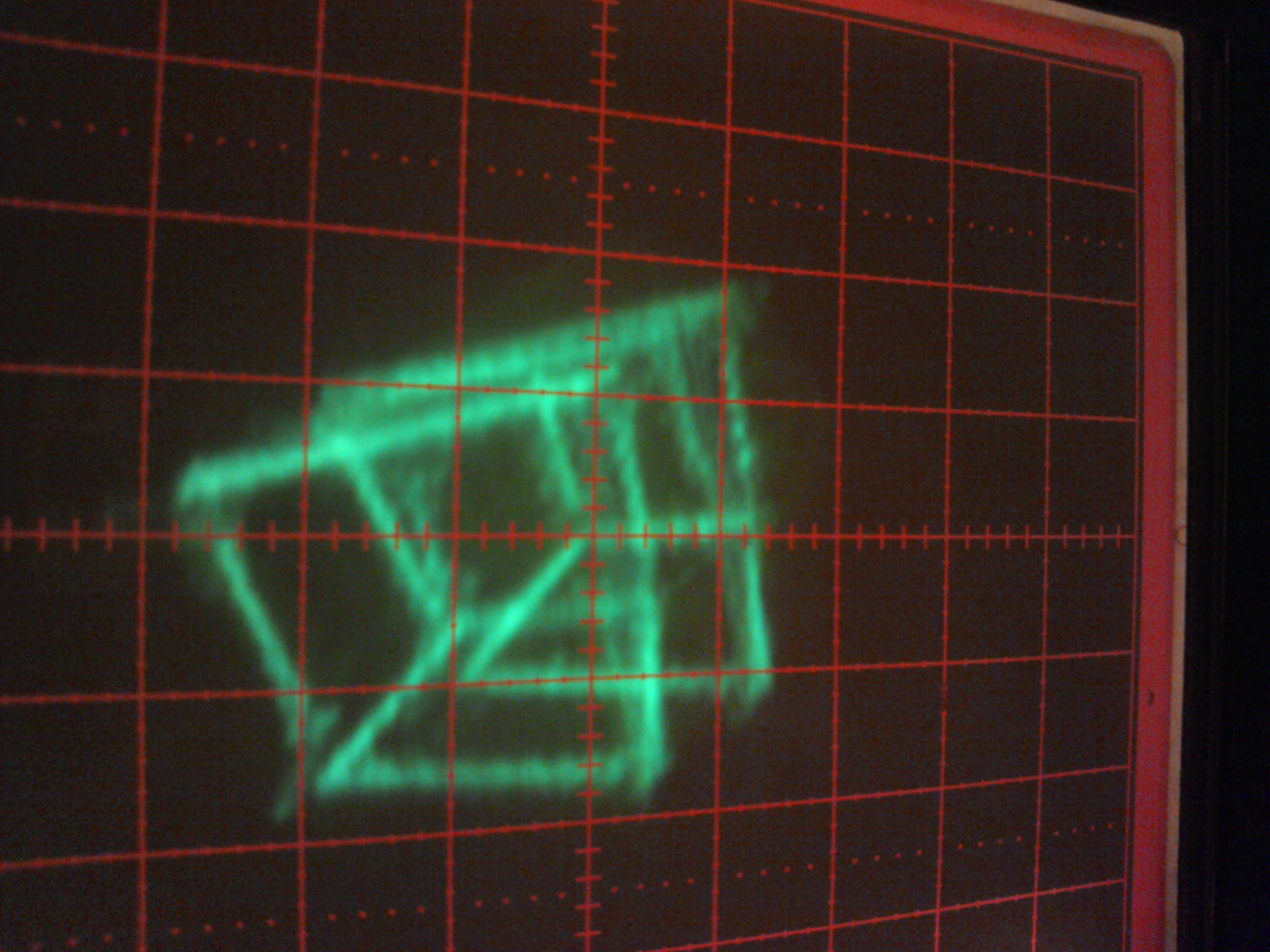

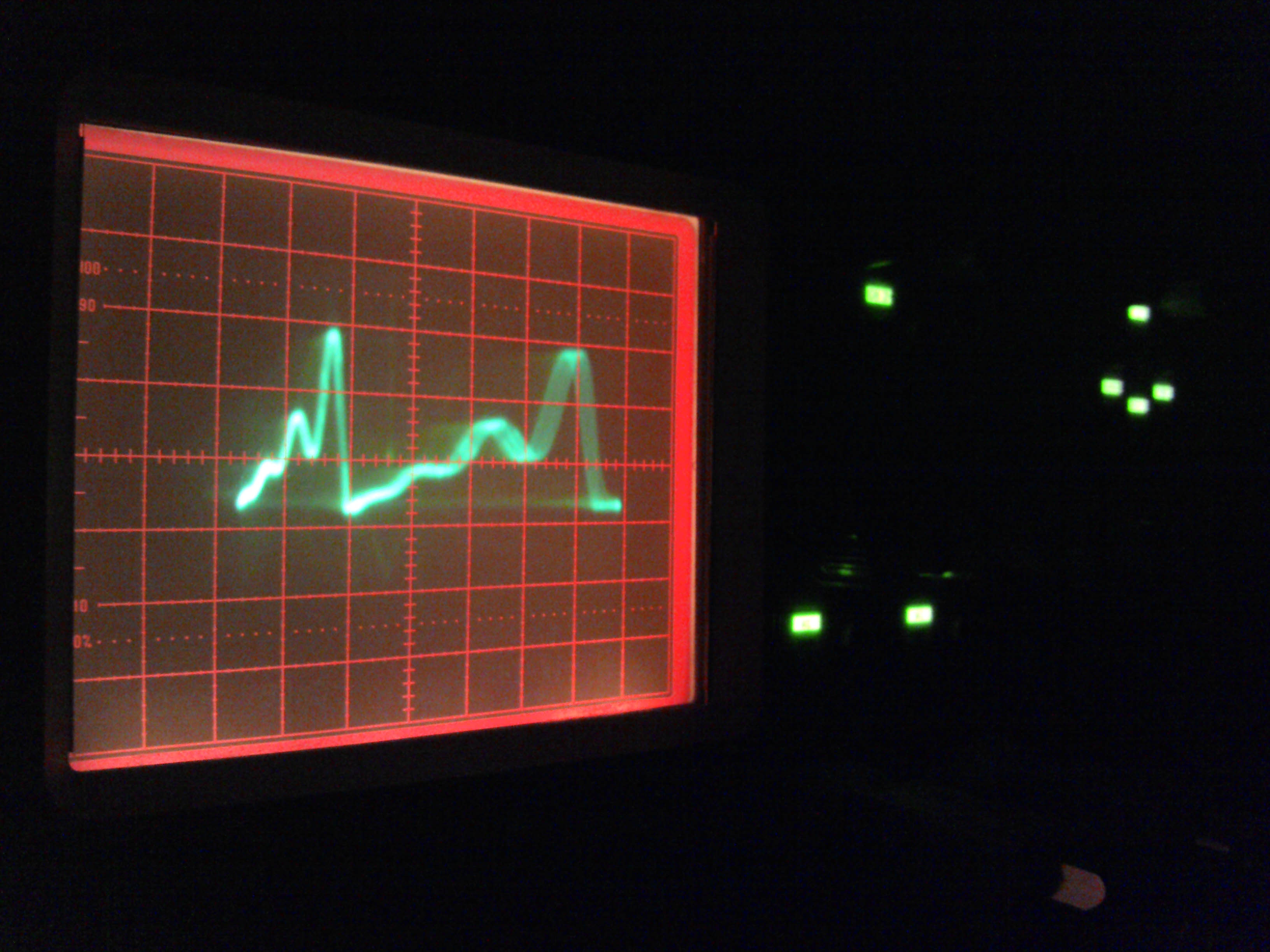

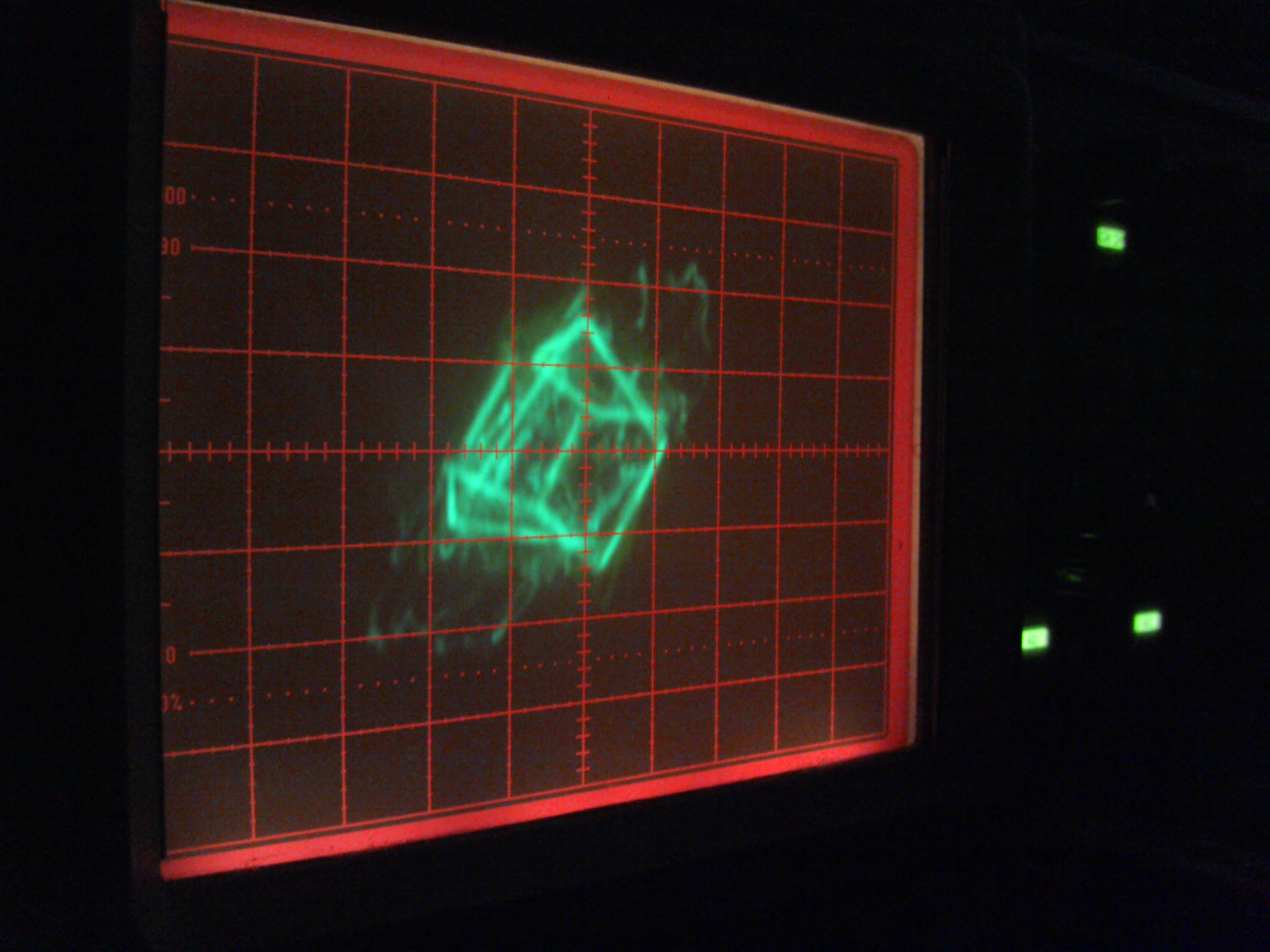

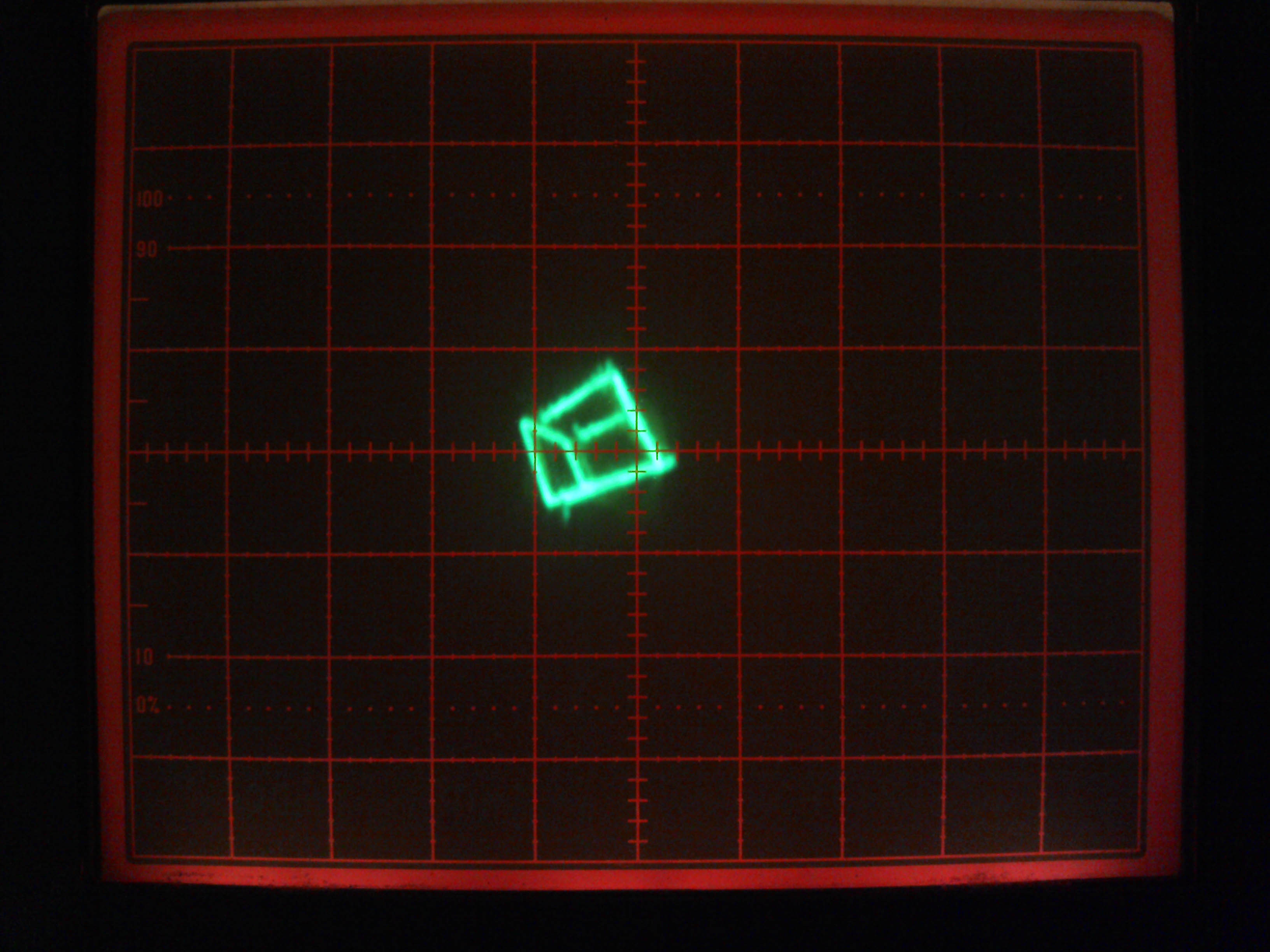

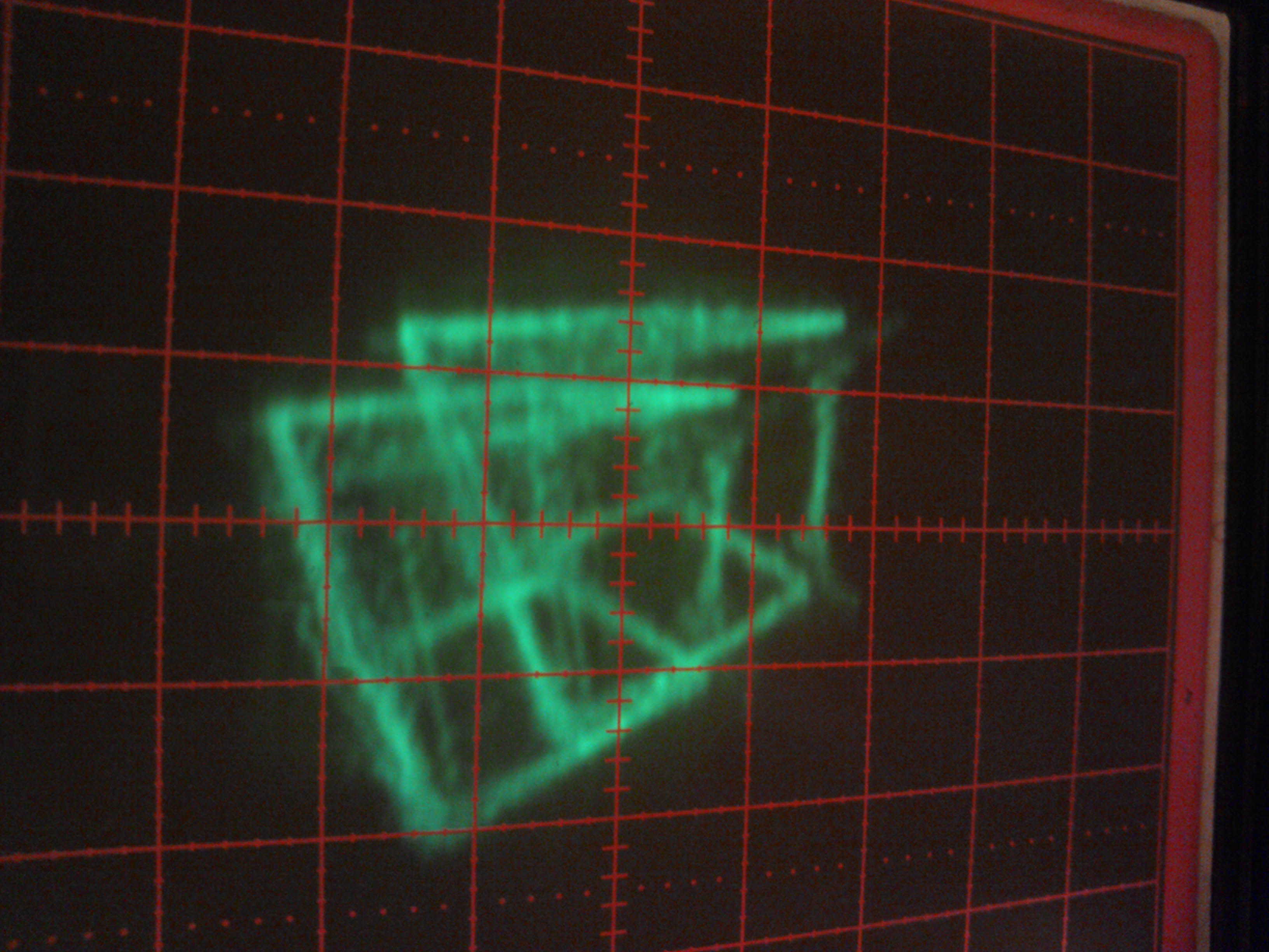

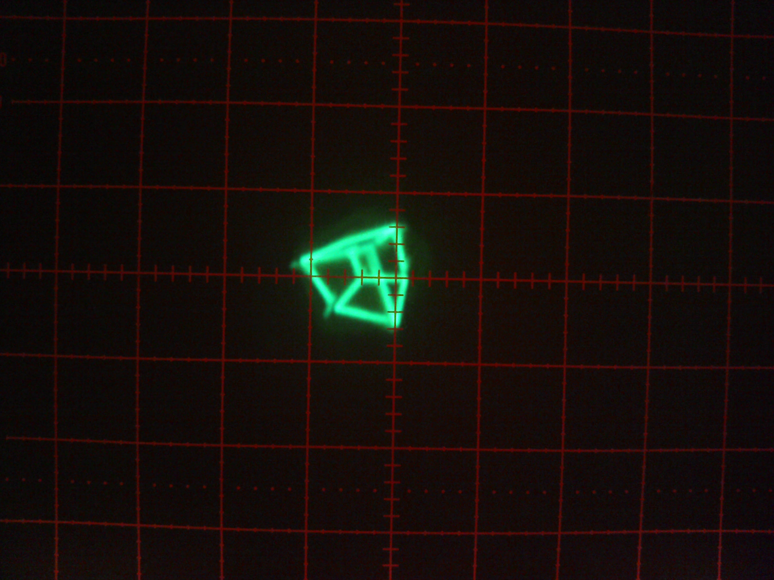

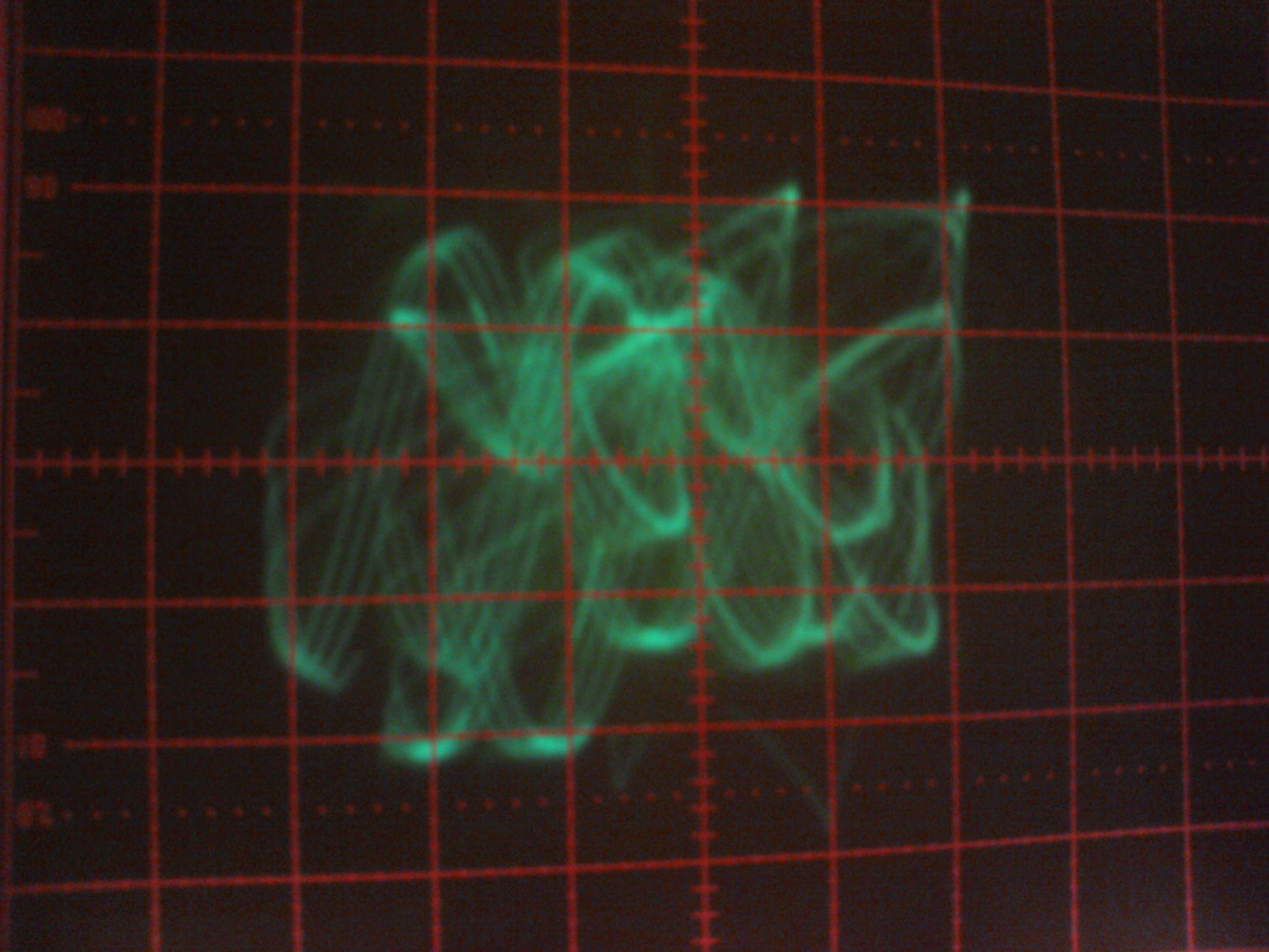

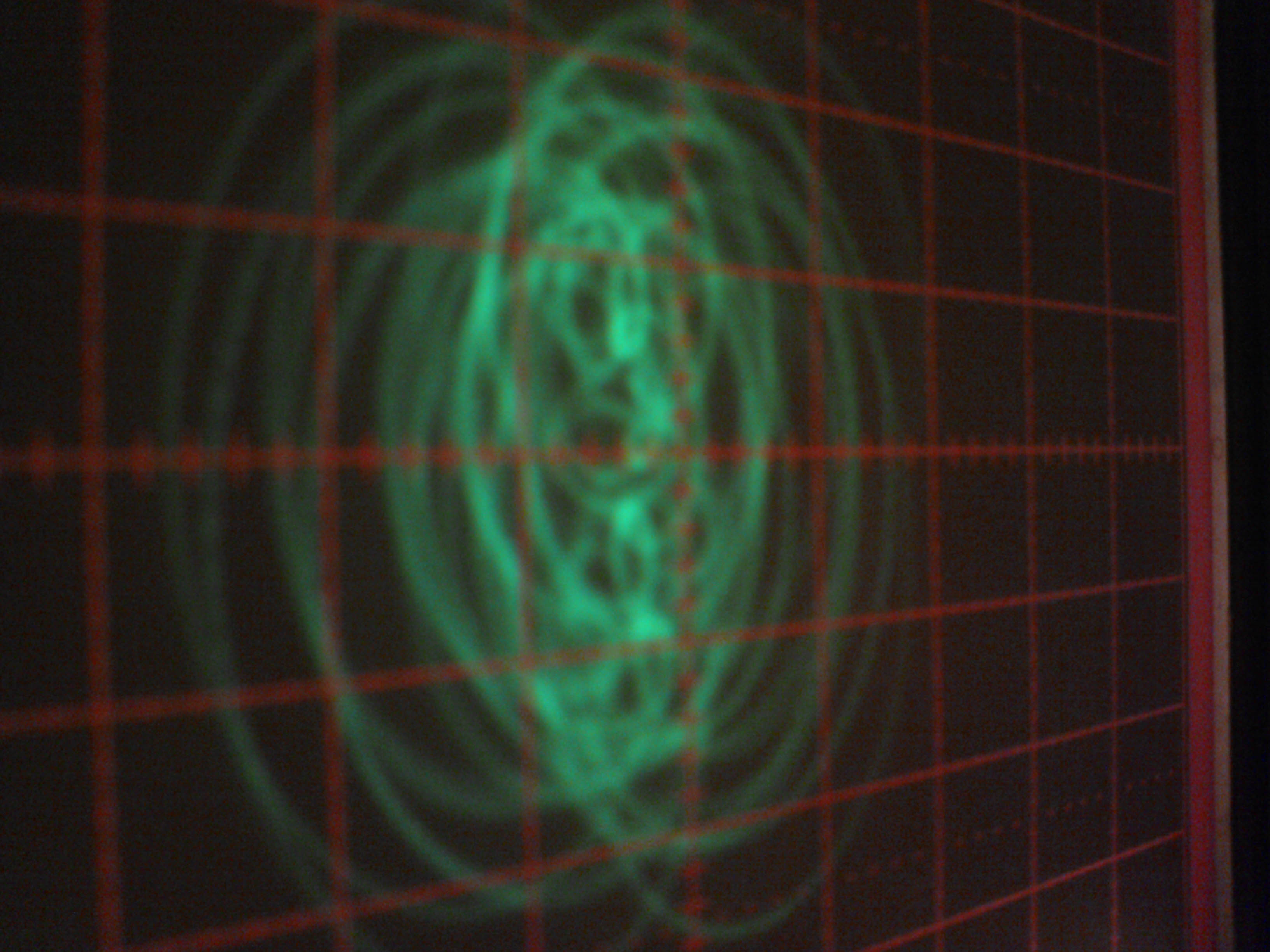

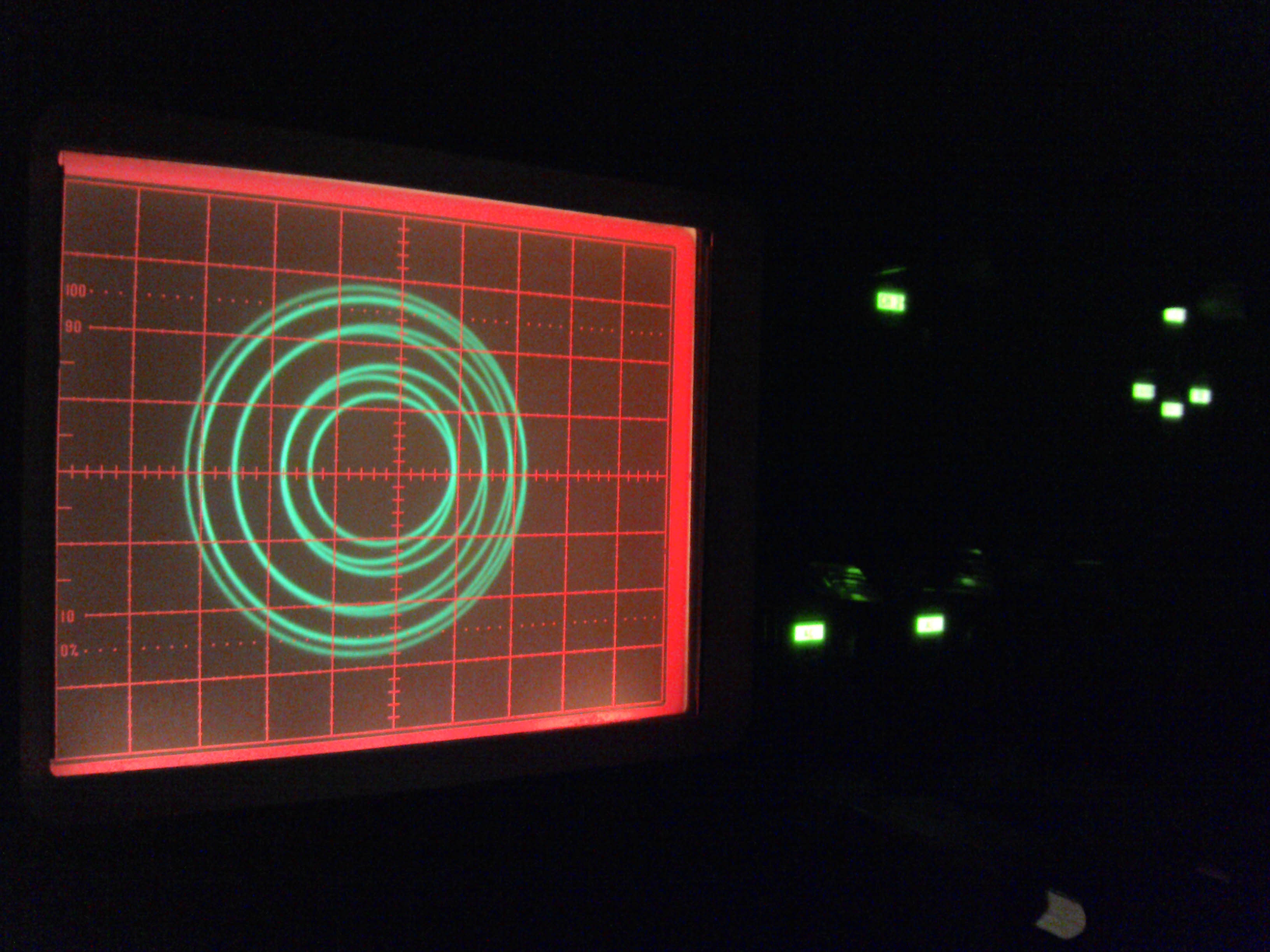

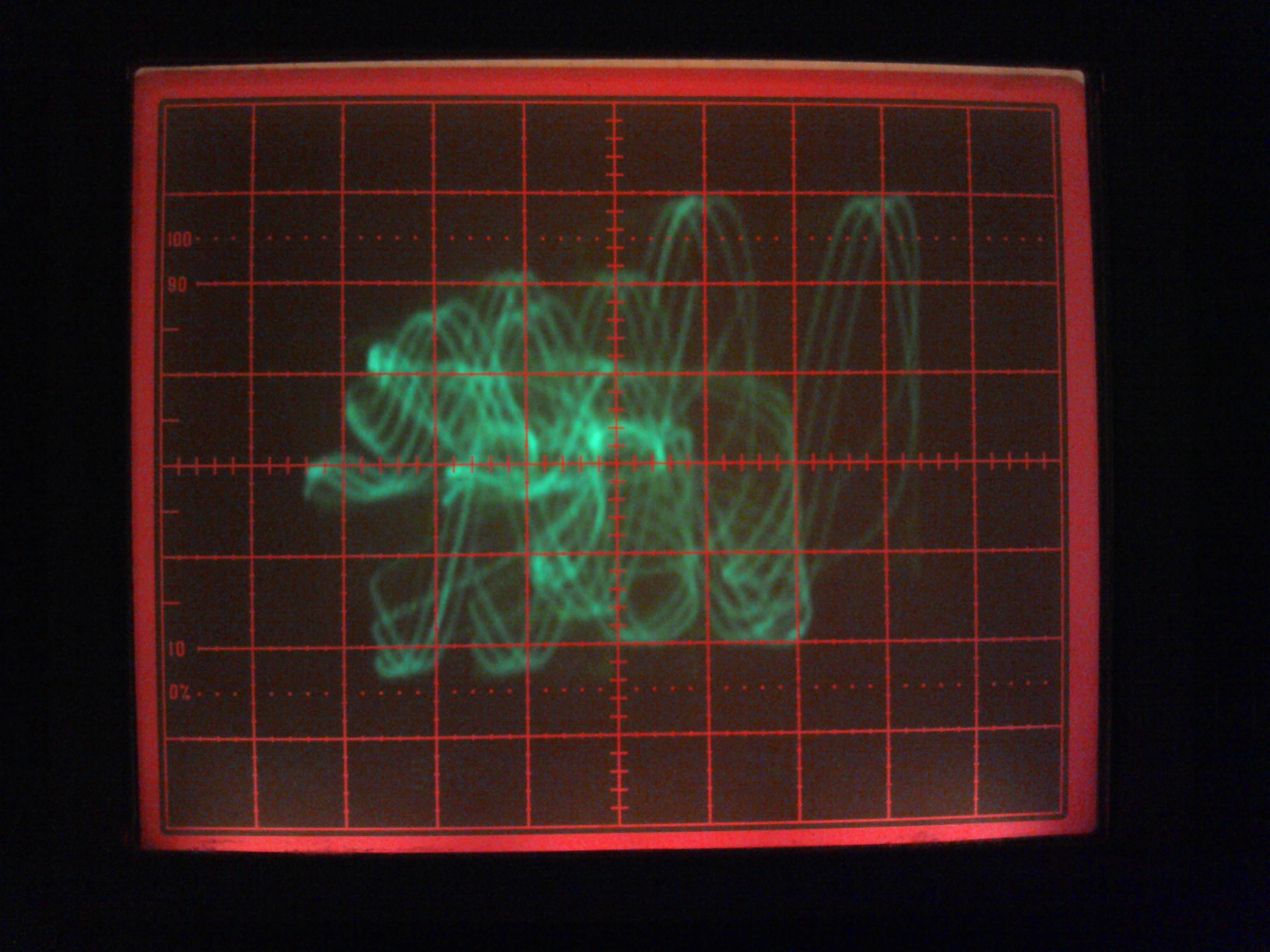

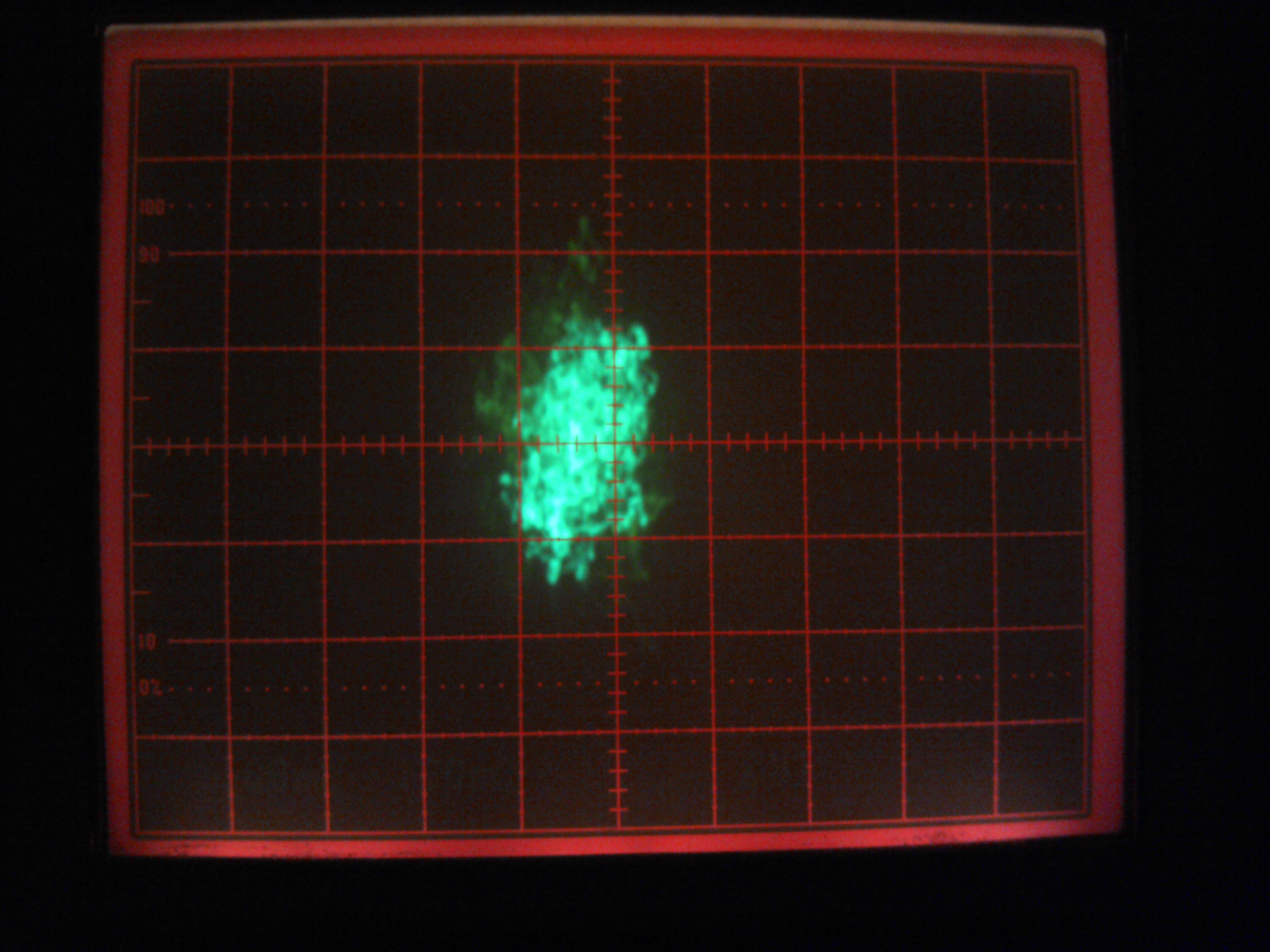

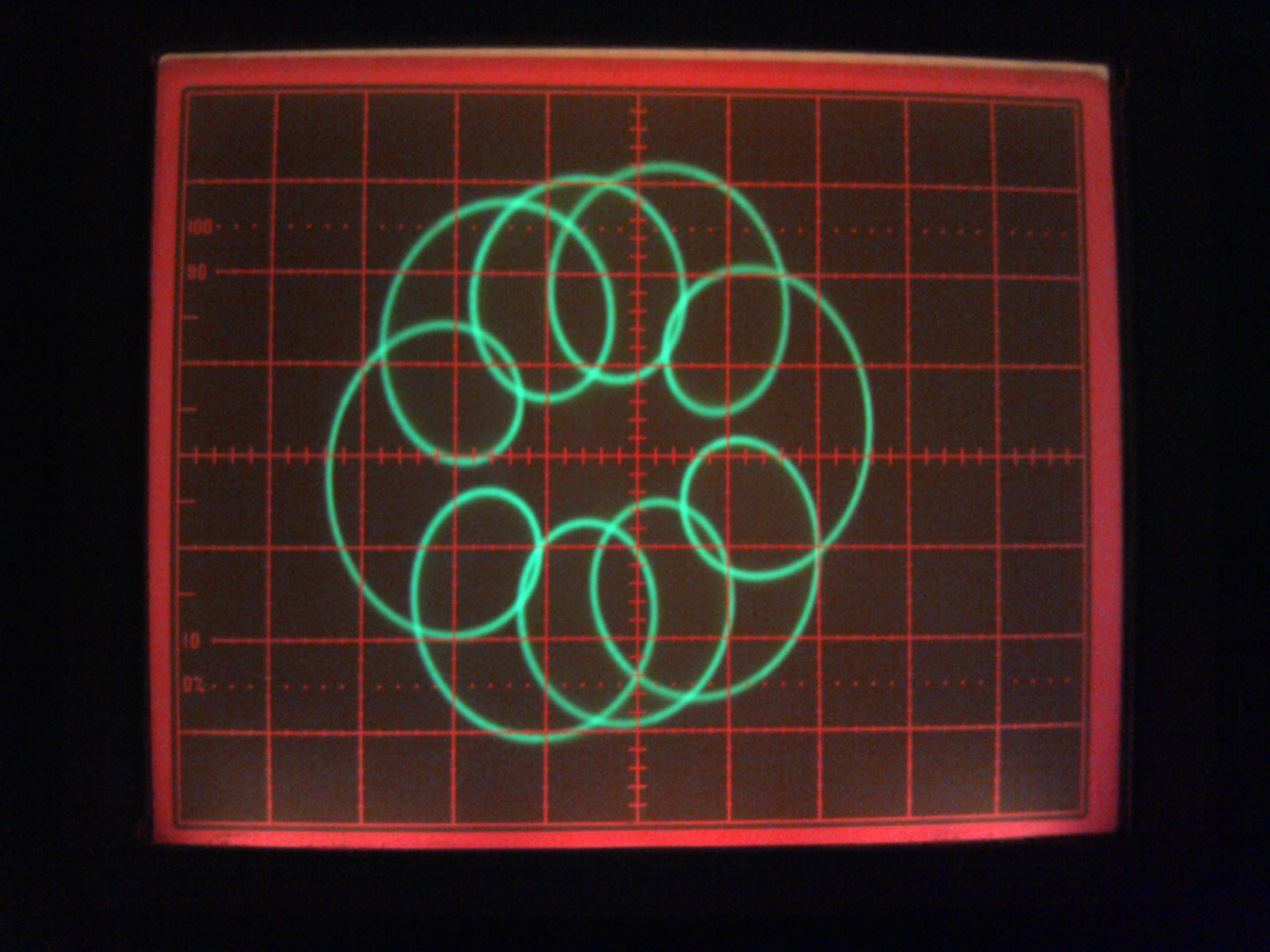

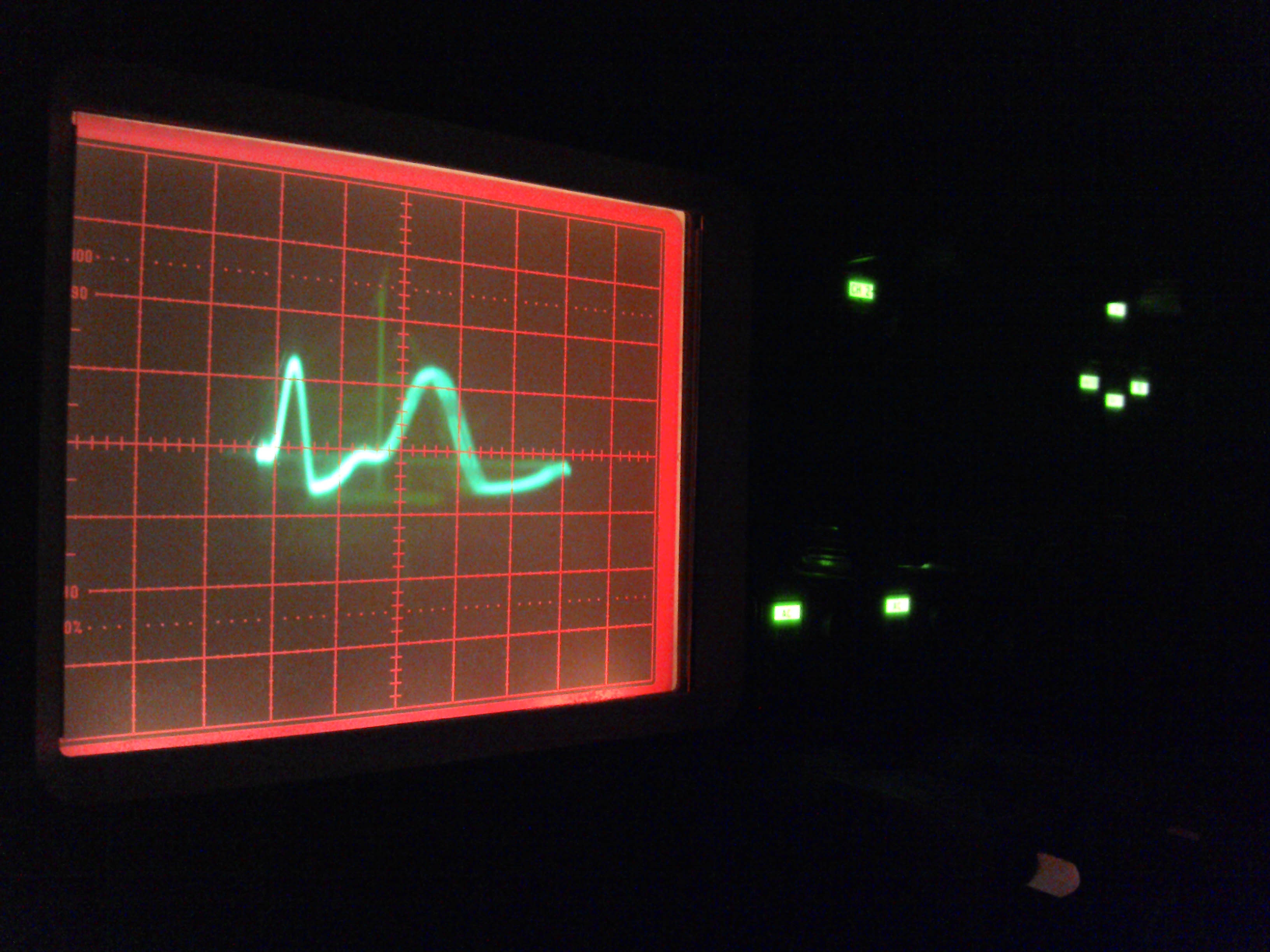

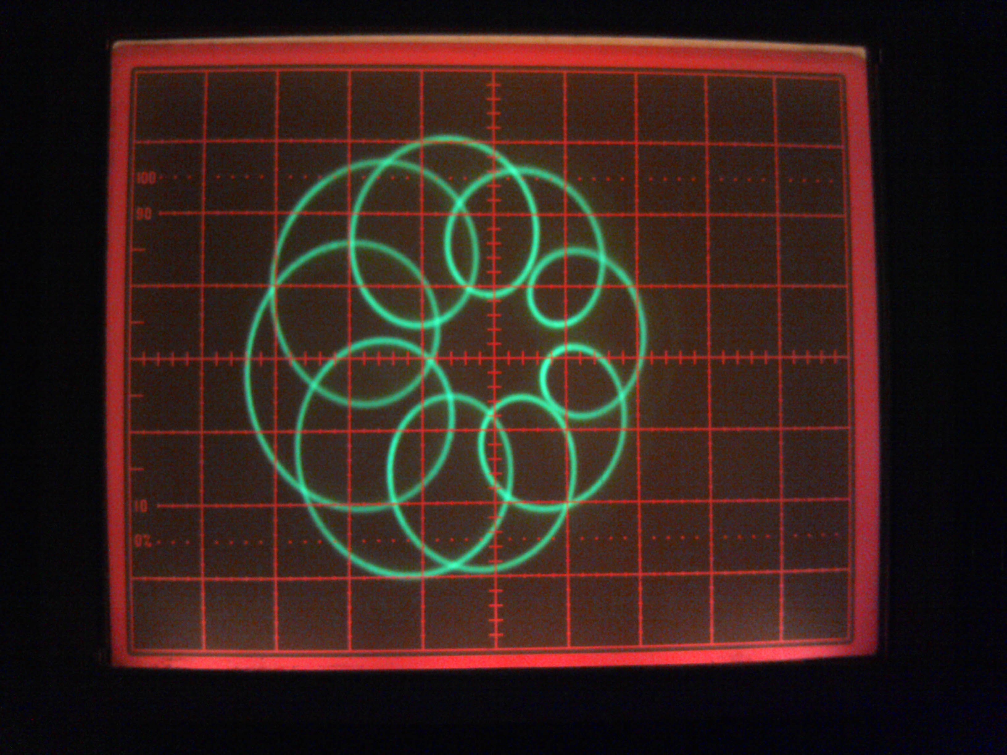

:) :) UPDATE :) :)
Oh, GO ON THEN; I'll show my finished 'scope off! :D:D:D
Matt

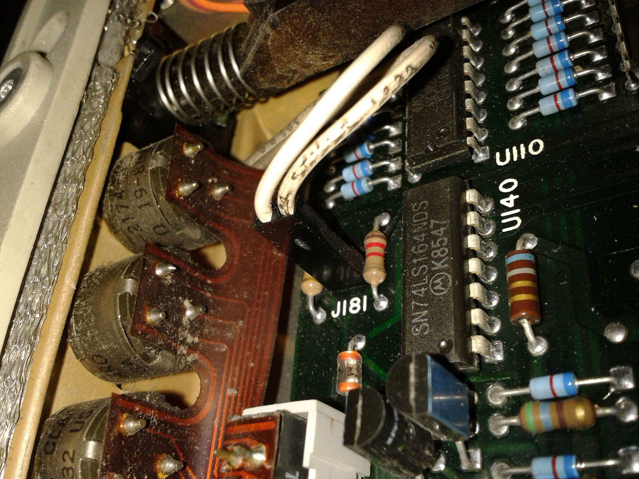

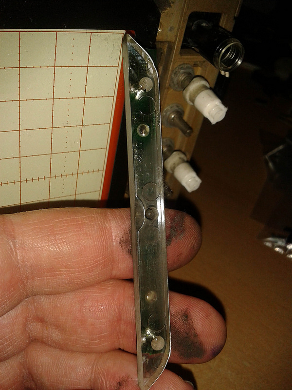

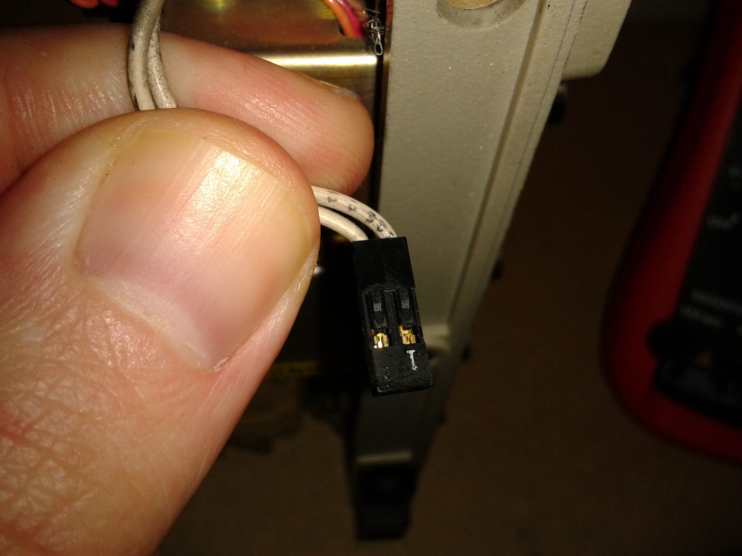

It seems the bulb(s) *are* blown, since metering the connector @ J181 header reads open circuit. Strange that you'd design the lamps in series, so that one failure = ALL off...

I agree with Rumpfy, keep the incandescent lamps.
They may be old technology, but they are appropriate and correct for this application.
Looking at what you showed, my guess is the lamps are 6 volt types. They dont have to be brilliant white in operation. I have some 6 volt and 12 volt miniature types that have no base; only flying leads. These sort of things are used in the dash board of our Toyota land cruiser. They wrap around a plastic moulding. I used some in an aussie built Mitsubishi; these were soldered in to the printed circuit board to show what gear was selected. The lamps are about 12 volt 100 milliamp or less, and the 6 volt are about 120-150 mA from memory. I note the two buffers U130 D and E are in parallel and with a usual TTL gate, the current sinking capability is up to about 30 mA. So with two gates, the capability is 60 mA. I note the pin-out on U130 is not standard TTL, so this might be a TEK special.
In the RS catalog, there is a T1 size lamp with 2 pins for direct soldering. The 5volt lamp is 60 mA. The RS code no is 655-9378.
I'm sure too, TEK will have details in the parts list.

Thank you :)

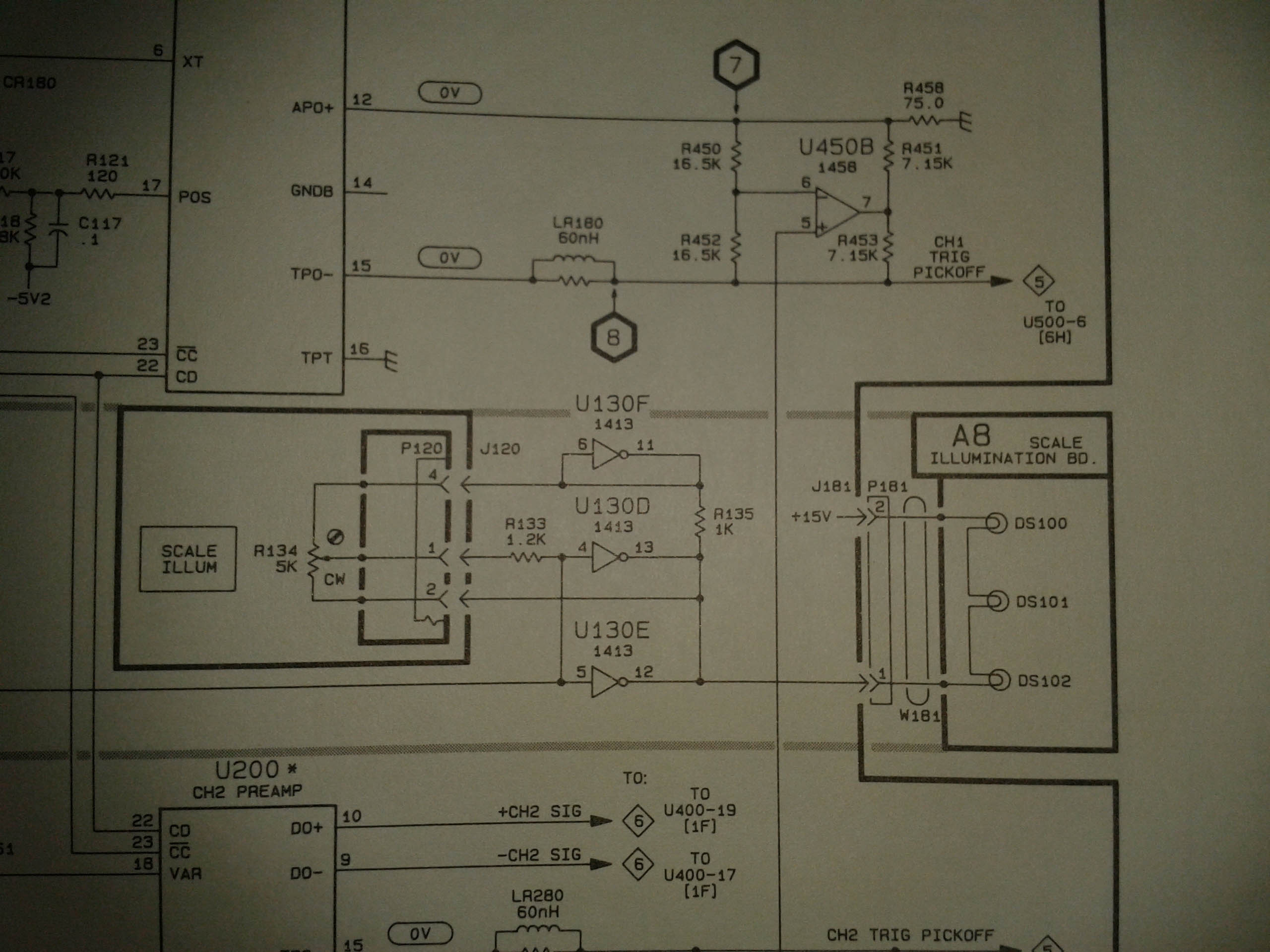

Also, look what I've found...
http://archive.org/stream/bitsavers_tektronixsvcMay87_38936698/070-6019-01_2465aSvc_May87_djvu.txt
"Scale illumination
The Scale Illumination circuit consists of U13GC,
U130D, U130E, U130F, and associated components. The
circuit enables the operator to adjust the illumination level
of the graticule marks on the crt face plate using the
SCALE ILLUM control.
Components U130C through U130F, depicted on
diagram 4 as inverters, are actually Darlington transistor
pairs. Figure 3-4 is a simplified illustration of the Scale
Darlington transistors U130D and U130E control the
current flow to scale-illumination lamps DS100, DS101,
and DS102. Base drive current for U130D and U130E via
R133 Is set by the front-panel SCALE ILLUM pot R134.
Voltage at the more negative end of the pot is set by the
self-biasing configuration of U130F and R135. The voltage
level established by these two components is two diode
drops above ground (« 1 .2 V) so that, at full counterclock-
wise rotation, the wiper voltage of the SCALE ILLUM pot
will just match the turn-off point of U130D and U130E. The
voltage at the other end of the pot is set by the collectors
of U130D and U130E. As the SCALE ILLUM pot is
advanced, the base drive to U130D and U130E increases,
and the voltage on their collectors moves closer to ground
potential. This increases the current through the scale-
illumination lamps to make them brighter and produces
some negative feedback to the base circuit through the
SCALE ILLUM pot. Negative feedback stabilizes the base
drive to U130D and U130E to hold the illumination level
constant at the selected setting of the SCALE ILLUM con-
trol."

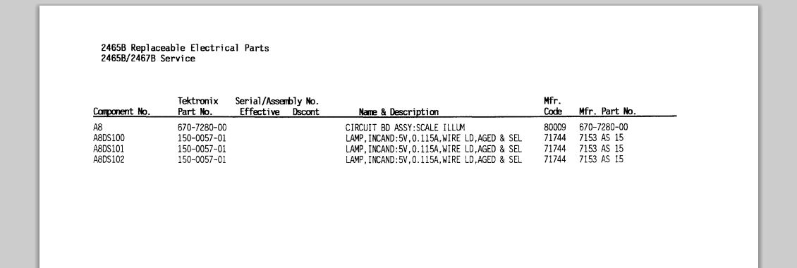

Looking at the list of replaceable part, Tek are using aged and selected lamps so that the illimination is nice and even.
But I don't think we need get too excited about that.
I am guessing that you are not in the UK, but I found these on the RS Components website, they seem to be just what you need, 5 volt 115 mA wire ended.
https://uk.rs-online.com/web/p/filament-indicator-lamps/0106458/
Hi Jim, thank you for the link. Actually, I live in a little village which is only 11 miles from RS uk HQ in Corby, and one of my best mates is a picker/packer, so this is very convenient :)
However, for now I may just meter out the illum pcb, find the blown bulb (since they are in series, the likelihood of more than one having blown is small), then I'll make sure there is one bulb on each end to make it even, then temp replace the blown bulb with a 47 ohm resistor.
Once you are in there why not replace them all. If they are low cost.
That way you don't have to go in and do it again or a least buy the set to have on hand in the event of the next one fails. Seeing as all this time and effort was spent on researching it.
A ounce of prevention is worth a pound of cure.

Okay, so I got the graticule lamp board out, gave the whole area a good clean and metered out the lamps; I was right, only one lamp has blown. However, if I substitute the blown one with a 1W 40 ohm resistor, the working lamps seem a little *too* bright with brightness on full tilt, and they're heating up in excess of 60 deg C, which can't be much good for either them or the light pipe assy. There was a bloke on youtube who'd replaced the blown lamp with only a 10 ohm resistor - I can only imagine how hot it is now, because you can only fit a standard (1/4w?) resistor in the lamp cavity, and there's really nowhere to mount a higher wattage resistor in the area surrounding the assy.
Bulbs it is - I'm a man of precision and like a proper job, not a bodge.

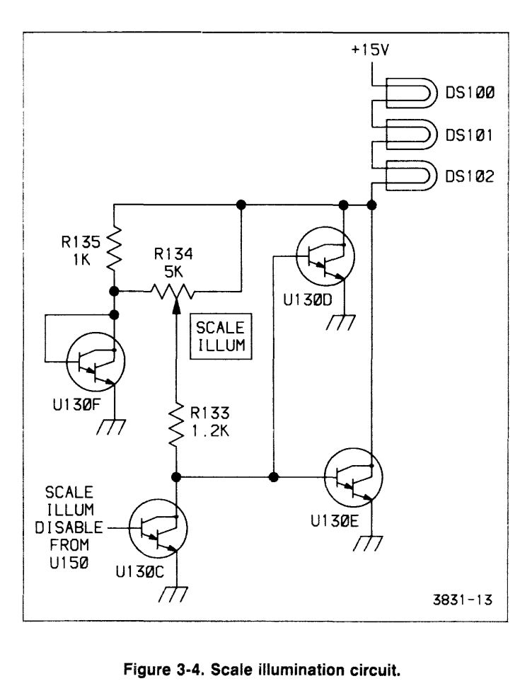

Each collector of the ULN2003 chip (darlington pairs) can handle 500mA:
https://kamuskomponenelektronika.blogspot.co.uk/2012/12/uln2003.html?m=1
From the 2465b service manual (same driver circuit and IC):
Scale Illumination
The Scale Illumination circuit consists of U130C,
Illumination circuitry, redrawn to show U 130C through
130F as Darlington transistor pairs for the purpose of the
following description.
Darlington transistors U 130D and U 130E control the
current flow to scale-illumination lamps DS 100, DS 101,
R133 is set by the front-panel SCALE ILLUM pot R134.
drops above ground (~ 1.2 V) so that, at full counterclockwise rotation, the wiper voltage of the SCALE ILLUM pot
potential. This increases the current through the scaleillumination lamps to make them brighter and produces
drive to U 130D and U 130E to hold the illumination level
constant at the selected setting of the SCALE ILLUM control.

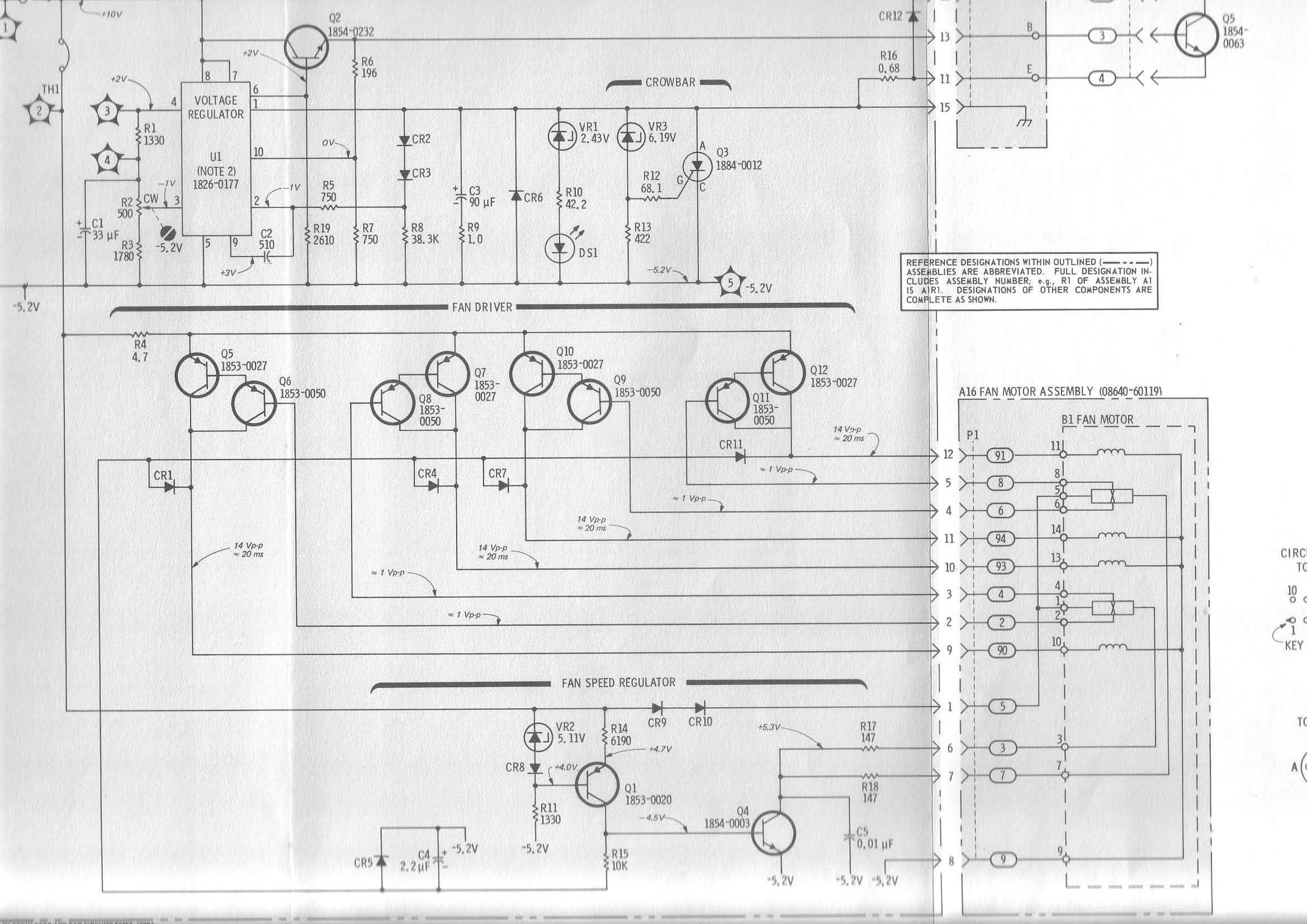

Gotta love the HP Engineering department! They've made some really beautiful equipment over the years, but...
For a simple lamp brightness control circuit, this sure looks waaay over-engineered, even to me.
Anyone have a reasonable justification for it?? Just wondering.
(Maybe some very weird MIL spec?) :banghead:
Yes, that's what I thought too. It's a bit OTT for driving three bulbs; what's wrong with a small transformer winding and a wirewound pot? :S
Ha! That is nothing.
Have a look at this schematic, the cooling fan controller for an HP8640B signal generator.
