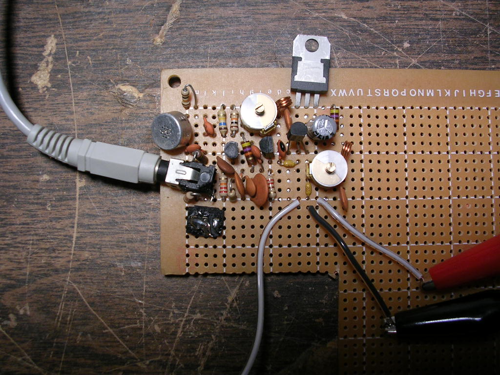

Hey audio, I finally got it working, I think. Not sure if I'm getting harmonics over my radio though. Take a look at the inductors that I have, are they too small or too big?? My capacitors are something like 5-60pf. Does that sound about right?
BTW, the sound quality is GRRRREAT as tony the tiger would say. I wish I had a portable radio to test range. all ive got is the stupid alarm clock radio that plugs into the wall. I'm not too worried 'bout batteries. I'm just gonna get a 9v wallwart for it.
How much current does yours consume? Mine is only consuming about 40mA, which leads me to believe that the amplifier might not be working and that I'm just getting a signal from the oscillator part of the circuit. That reading is coming from my PSU, and I don't put too much confidence in what that meter says :lol: . I guess I'll just have to get a radio and test range to be sure.

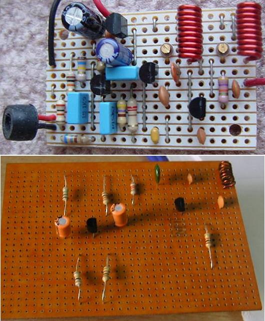

No disrespect, but have you compared your board to Audioguru's?. His looks really smart, in comparison your's looks like a heap of xxxx :lol:
In particular compare the coils, do your's look anything like his?, did you follow his coil winding instructions (obviously not).

Yours must be working because its 40mA is a good sign. I think it would draw much more current if it wasn't oscillating. Your whopping big regulator has an operating current a few mA more than mine.
Your layout is nice and tight which reduces stray capacitance, but your coils are small with few turns.
Your radio is probably overloaded by your transmitter so get some distance between them for tuning. My FM Walkman radio has a local-distant switch which is handy to reduce its overloading.
Here is a comparison pic of mine vs one made by a guy who complained that his didn't work:

Nigel, the main reason that perfboard exists is to experiment with, not to make a final product. I always like to make an experiment board first, whether its on breadboard or perfboard before I go and make a PCB that does not work (I hate troubleshooting PCB circuits). Perfboard circuits are not meant to be pretty. When I make a PCB, I'll take a picture and you'll have to eat your words :lol:

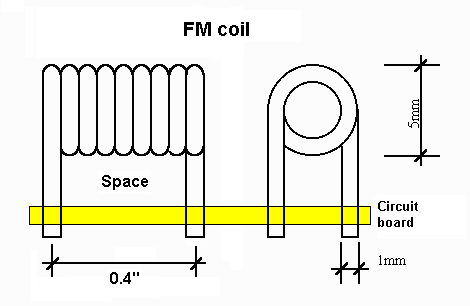

As for my coils, mine are quite a bit smaller, never saw the directions on how to make them. The strange thing is, my radio is not overloading. It is probably about 50 feet away, and the signal has to go through the whole house to reach the radio, yet the signal is clear as a bell and very strong too. I would think if I made coils that big, the carrier frequency would be way below the FM band and all I would get is a load of harmonics up in the FM band. So what exactly are the specifications for making those coils?

Here is a sketch of my FM coil that I stole from Rod Elliot's project:
