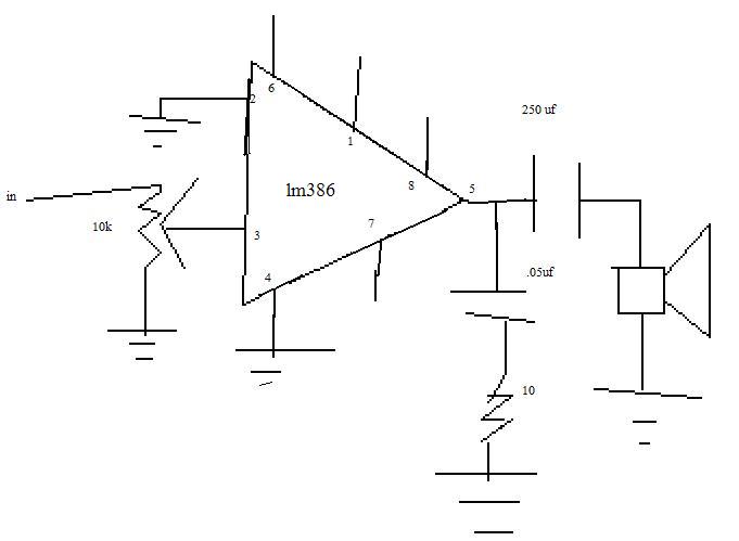

hi again :lol: . i just tried using the lm386, and its even worse than it was. can't hear nuttin. i cant figure out for the life of me wuts wrong, it is DEFINATELY put together right.
I was thinkin though, would it be possible to just use 1 or 2 transistors to make a nice little amp? that way i could save space and would have to play around to get the lm386 workin.
Hi Zach,
Please post the schematic of your LM386 amp so we can see what is missing.
If your headphones are very high impedance (unlikely) only a transistor or two will drive them. If they are low impedance, you will need at least 3 transistors and many resistors, similar to an LM386.
this is the lm386 schematic from the data sheet.
i think that my headphones may in fact be high impedance because wen i plugged them directly into the tda7000 output coupled through the .1uf cap, i could hear just good enough to make out the words and the songs. The output is 75mv.

Hi Zach,
Your LM386 should work fine if its 0.05uF cap is ceramic and if it and the 10 ohm resistor are connected very close to pins 4 and 5. Pin 6 should have a ceramic decoupling cap to pin 4 also connected close.
Can you measure the resistance of your headphones? It will be just a little less than their impedance.
Yeah, your headphones are fairly low impedance and are like a dead short to the output of your TDA7000 circuit. You need the LM386 power amp which matches the impedances properly and provides gain.

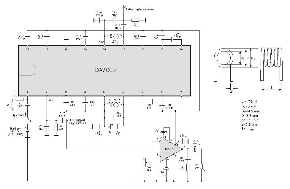

i am soon gunna make this tda7000 circuit. will this work for european reception? and is it ok to have a telescopic antenna there? and is there any way to improve sound reception? and hwill the FM band be properly recieved in london?
look i think on page 4 of this posting, audioguru gave a good explanation as to wheteher or not it will work well in Europe vs. america.
u dont need that 10uf across pins 1 n 8 on the lm386. have a look @ the lm386 data sheet and use the 20 gain circuit. it should work fine.

Hi Zach,
I don't know where I discussed TDA7000 output level and amplifier gain requirement, but GST Genesis will use it in London.
On their datasheet for the TDA7000, Philips spec's an output level (which I assume is RMS) of 75mV, with a modulation of only 22.5KHZ.
In North America, full modulation of an FM station is supposed to be 75KHz (but the stations seem to exceed it most of the time, more like 100KHz). So we certainly don't need a gain of 200 from the LM386 over here.

hi audioguru, this is what i was talking about.
Hi Zach,
When they designed the FM broadcast band system, they wanted to have a very quiet background sound level, even better than the fairly low noise (high frequency hiss) that FM provides. So they decided to emphasize (boost) the audio high frequencies when they transmit, then allow the receiver to cut the audio high frequencies back down to normal. When the highs are cut, then the hiss is also cut. The Americans, who started FM broadcasting first, chose an agressive emphasis curve so that the hiss was reduced very much during de-emphasis by the receiver. The recorders and microphones at that time didn't have much high audio frequency level anyway.
Years later, the Europeans decided to broadcast FM too, but noticed that the high audio frequencies frequently overmodulated the transmitter when they were emphasized so much. They realised that recording machines and microphones had improved very much over the years since the Americans developed the system and produced high audio frequency levels that were much higher than the system could support. So they chose a less agressive emphasis curve (less high audio frequencies boost).
Therefore the North American and European curves are different. An American radio will sound muffled in europe, and a european radio will sound too bright in America.
Your radio has the agressive American de-emphasis curve where the high audio frequencies are cut quite a lot. (The datasheet has the european curve). However, your simple transmitter doesn't have any pre-emphasis to balance the sound so the radio will play it very muffled, similar to your home stereo having its treble tone control turned all the way down.
