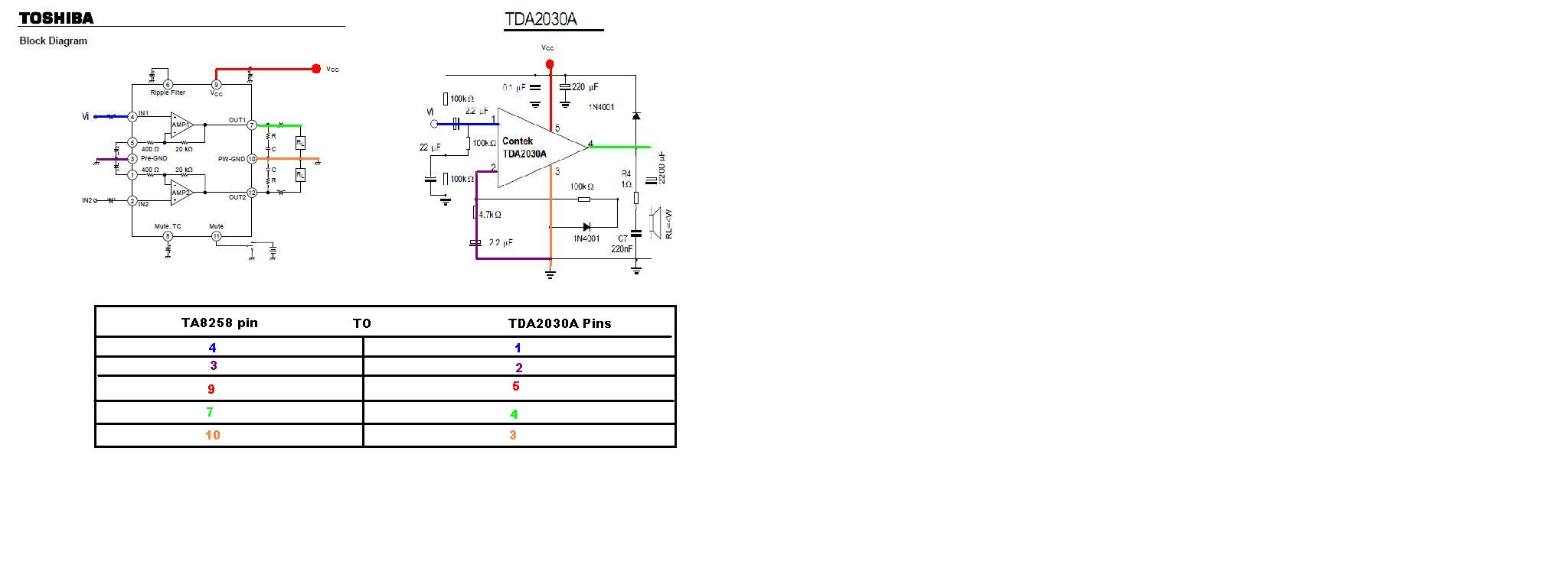

i have an amp that the TDA2030A blowed . and no one in 300km can provide me a spare part .
i have another part . not the same . but i think do the same job + option . and are Stereo .
the part are a Toshiba TA8258 (12pin)
i join a comparative schematic but i dunno if im right . any help would be appreciated .
thanks a lot !
jeff

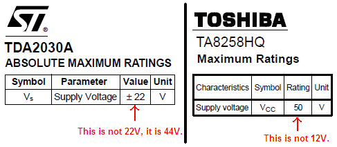

there's a problem with that, the tda2030(a) is rated for 22 volts, the other one is rated for 12 volts, 2 times the amount it can handle, what's going to happen is it's going to go bye bye. another problem i see is the cross wiring you'd have to do for it to fit. the third thing that's wrong is the pins, tda2030(a) is 5 pin, the other one is 12, and you don't know what they go to or even if they're needed. so just order the new tda2030(a) and save the time and hassle.
