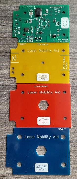

Were they 6-layer (or more) or rigid-flex boards? Were they populated? Or were they simple 2-layer or 4-layer bare boards?
2 layer populated boards plus three boards that are just mechanical.
The 3 colorful boards are to hold a 1/4-20 nut captive in the enclosure for a camera clamp.
These boards are from JLC (China), delivered to Mexico, where I am staying for an extended period of time.
