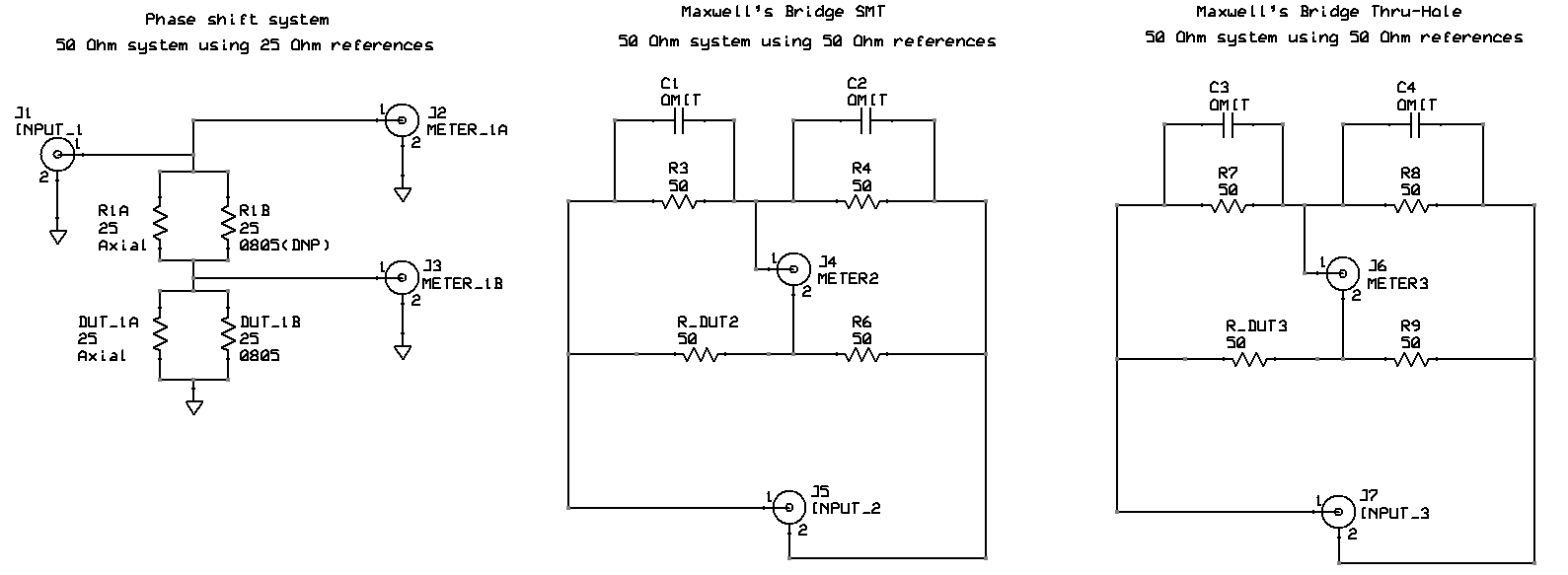

Anyway, I decided to put it to the test and try to build a test rig to see if the difference is measurable. I put together this schematic back in August. I've been too occupied with other stuff to put much research into it beyond that, so I may have overlooked some key issues. There are three circuits (see attached)
Going left to right:
The left circuit is a simple voltage divider for an AC signal. I intend to place it between a 50 Ω sine wave source and an oscilloscope. R1A is a precision, non-magnetic, (i.e. expensive) 25 Ω resistor. DUT_1A is the random 25 Ω device under test (DUT). The idea is: if there is no inductance in the test resistor, there should be zero phase difference between the output signals J2 and J3.
The center and right circuits are identical except the center one is for surface-mounted resistors and the right side is for through-hole. Three resistors (R3, R4, R6) are identical, precision, non-magnetic 50 Ω resistors. The final resistor (R_DUT2) is the 50 Ω device under test. The idea is: if the resistor pairs have perfectly balanced impedance, there should be no signal out of J4. If there is a mismatch: capacitors can be added until the impedances are re-balanced. I'm guessing the difference won't be easily measurable except at radio frequencies but that's just my speculation. Any thoughts on this test?

the OP is right to be skeptical about this. if an effect can't be measured (distortion, noise, frequency response, phase shift, etc...), then the "results" of testing for equipment reviews that ignore measurements, are completely subjective. there is a body of "audio urban legends" that continues to expand out of control. it began in the 1970s with the "large amounts of negative feedback degrade sound quality" myth. that one actually began because of a limitation in semiconductors as well as circuit design. the myth grew out of the discovery of "TIM" (Transient InterModulation distortion). it was noticed that when a lot of global feedback was used in solid state power amplifiers, certain types of intermodulation (nonlinear mixing in the frequency domain) distortion would result. so, IMD was avoided by improving localized negative feedback, and backing off on global feedback. when it was discovered that IMD was caused by the amplifier not having an adequate slew rate, the limitations on global feedback were no longer necessary because the actual cause of IMD had been found. even though the slew rate problem had been fixed, and global feedback could be used without limitation, the myth still continues to exist that too much global feedback (as well as too much open loop gain) is bad. that particular myth is unique, because it did at one time have some reason to exist, but many of the other ones are just myths based on a poor understanding of physics, or worse, something somebody has thought up to separate people from their hard earned money.
i found this data sheet for TaN resistors **broken link removed**
the primary reasons for using them are high reliability, low thermal drift, environmentally rugged. nowhere does the data sheet mention "happy audio", which seems like it would be a parameter that's difficult to quantify....
