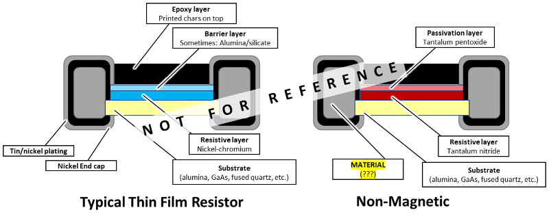

Regarding wirewound resistors in Zobel networks--which are effectively there for impedance-matching--this got me looking more into non-ideal behaviors in the common resistor types. And I think I see how the whole "tantalum resistors for audio" thing got started.
It's well known that in the real world, resistors have non-ideal (parasitic) characterisitcs. Each one will have some detectable amount self-inductance, and even the flat, non-coiled chip resistors aren't exempt from this (per Ampere's Law).
Where I suspect tantalum factors in is: the permeability of any nearby material has a direct impact on its self-inductance; hence why inductors and transformers often feature ferrite. For thin film resistors, the two leading chemistries as of 2018 seem to be the popular nickel-chromium (NiCr) and the moisture-resistant tantalum-nitride (TaN). In nearly every source I've read, the NiCr type was using along with pure nickel in its end-caps. Not every source, but most. TaN end-cap materials were rarely specified, opening the possibility for non-ferromagnetic metals like gold or copper. As I said before, nickel is one of the only ferromagnetic metals. Its permeability is nearly as high as iron.
I decided to put this to the test using random 0805 resistors I had in stock. I took 6 rare-earth magnets and some basic-grade thick film resistors--brought them together, and sure enough, the resistors clacked right onto place on the magnet. I repeated this using 0603 precision Vishay TNPW series thin-films. They were attracted too, albeit with way less force. This makes me wonder how often people place potentially magnetized resistors near hall sensors or digital compasses.
For the most part, you only hear about tantalum capacitors. Tantalum-nitride and nickel-chromium resistors are both casually bought and sold as "thin film" devices, and consequentially, shockingly few engineers are aware tantalum resistors even exist. So basically, where I am now is trying to sort out: (1) exactly how much of an inductance difference there is, and (2) how likely will it might affect audio. The 'audiofoolery' assumptions reflect sloppy reasoning rather than science. And anyway, the idea of a totally non-ferromagnetic resistor is too good to pass up. Below is a simplfied cross-section of some chip-style resistors I found (re-drawn for copyright-avoiding purposes). The mystery now is what the exact inductance/impedance implications are for NiCr vs. TaN.

Procesing, apparently has a lot to do with it. I've done personally sputtering of metals and metal oxides particularly Mo, ZnO and ITO. RF sputtering for oxides and DC sputtering for metals. We electron beam evaporated metals (e.g. Gold, Nickel and Moly) but in that case, I just fixed the machine. I personally thermal evaporated magnesium and apparently better than anyone else could at work. They kept asking if I evaporated the wrong metal. We did carbon too using an arc.
Right, that pretty much squares with other Tantalum Nitride papers I had found. Even if the resistor is guaranteed to use TaN, the exact structure/phase of the TaN could be influenced by the specifics of the sputtering process itself; or by any subsequent heat treatment. One paper (link below) cited seven different phases of TaN. So there doesn't appear to be any exact look-up table for the current noise of TaN. Or if there is, it may be hiding.

To actually compare some physical resistors, I'm looking for a circuit that is good at measuring parasitic inductances. I have a function generator and oscilloscope, so I was thinking of using something like a bridge circuit with precision foil resistors as the reference. Any suggestions?
