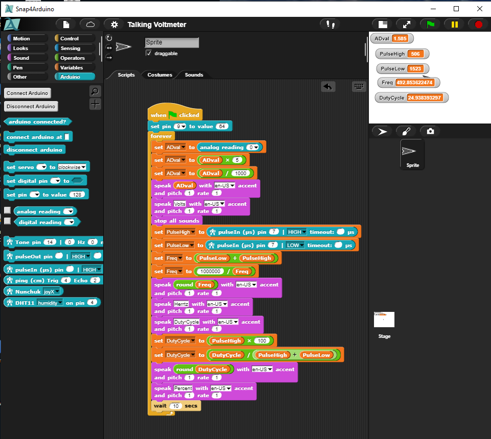

A lot of folks give a thumb's down on using block languages, like the ones our kids are now using
in school to program robots. But they are expanding in capability and ease of use.
Here is an example of a tethered Arduino UNO board using Windows libraries (no fear, you do not
touch any of that stuff). Uses Snap4arduino block programming IDE, first you program the UNO
with SA5Firmata_tone, then do the block programming, and create a talking DAQ. In this case V,
Freq, Pulse Width high and low, and duty cycle. The UNO has to stay tethered to PC. But there
are libraries out there where it could stand alone, although not sure if they are integrate with
any of the block language tools.
Thats it. Lots of fun and quick to program. Once you learn this there are many other block languages
with specific features and many common features. Eg. once you learn one jumping around to the
others pretty simple. MIT has put some significant effort in Scratch4Arduino, there is Ardublock, Visuino,
Flowcode.....to name a few.
Regards, Dana.

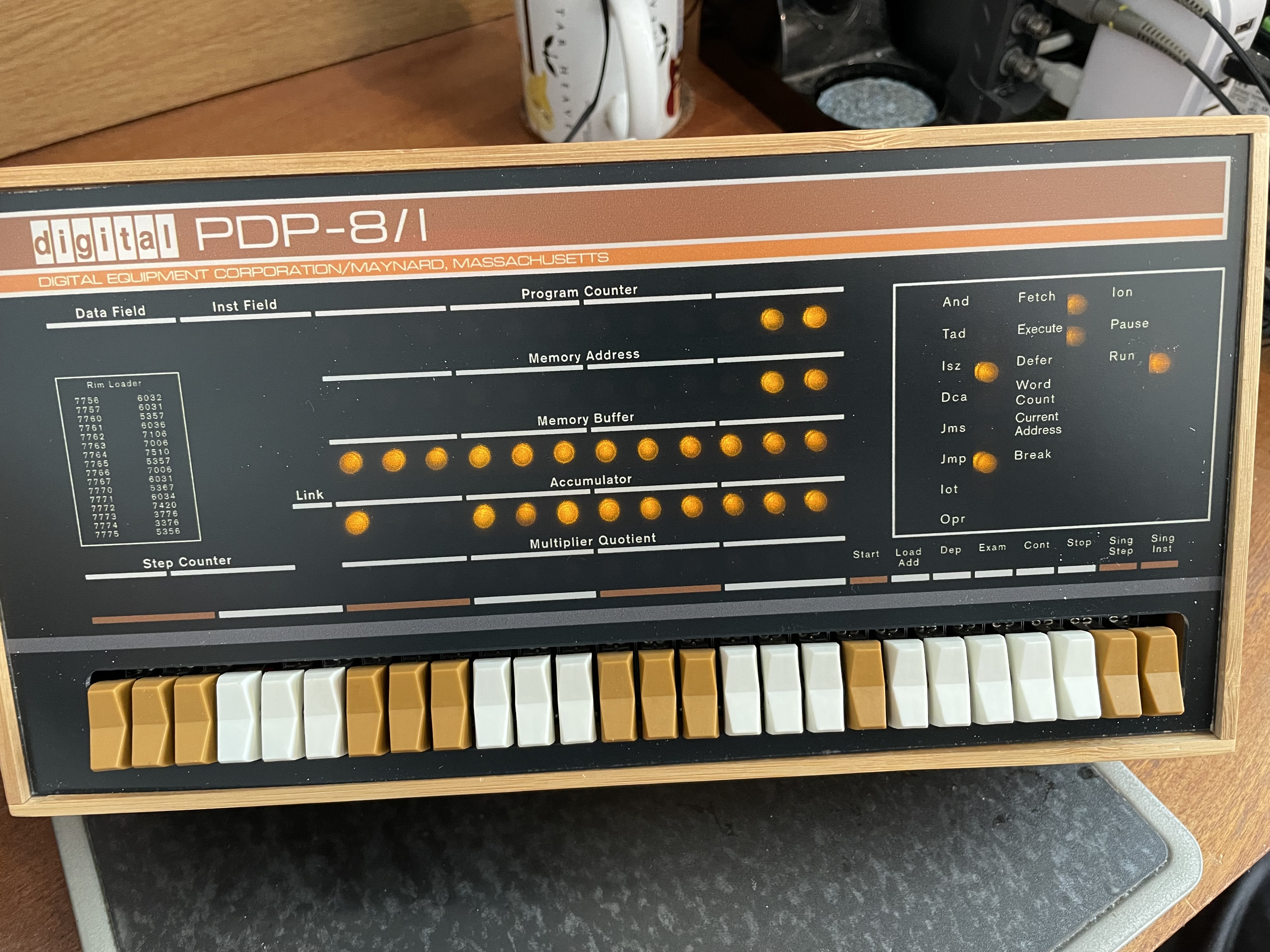

And I still think the PDP-8 is an excellent machine for teaching the basics of programming, as the structure is so simple - a beginner can grasp the whole CPU structure, see it functioning and understand its operation quite easily, which is near impossible with recent PC CPUs.
I had to get rid of my 8i when I first moved from my parents place in to a bedsit, but I have a little emulator to help teach young relatives:

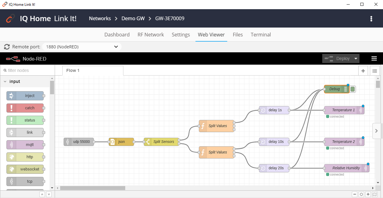

I played with Scratch on the Raspberry Pi. It looks fun for games but I need I/O.

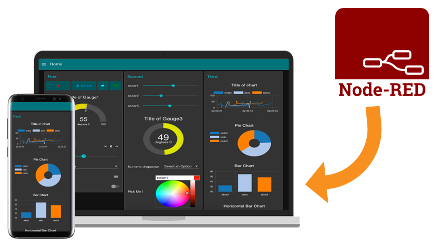

I am playing with Node Red on the Pi. For the real programmers, you can punch into any of the blocks and modify the code.
What I like about Node Red is that it uses a web browser for the human interface. In just minutes I had a graph on the phone showing the temperature over the last day. I am not a programmer but learned to connect my computer to almost anything on the web through Node Red. OK...maybe not real programming but it gets the job done.
